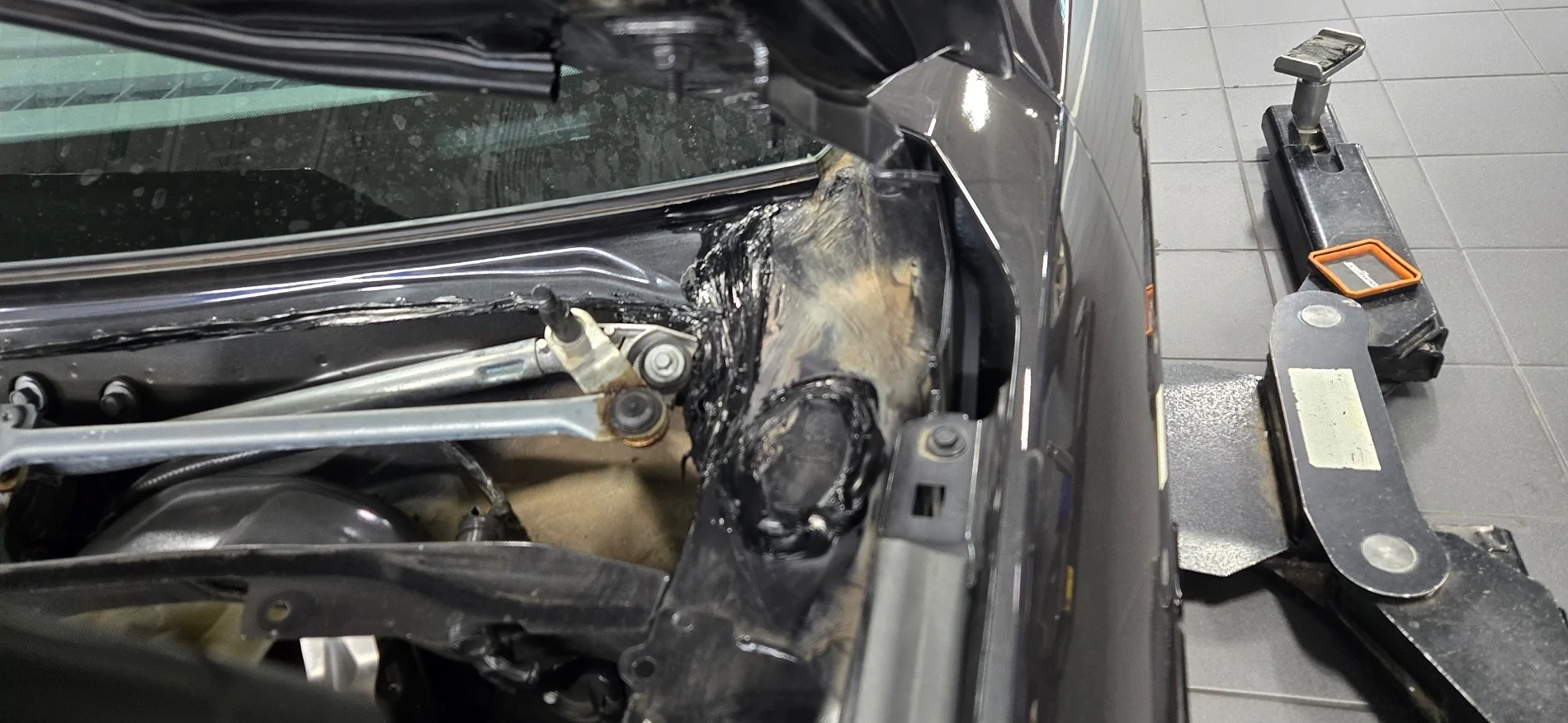

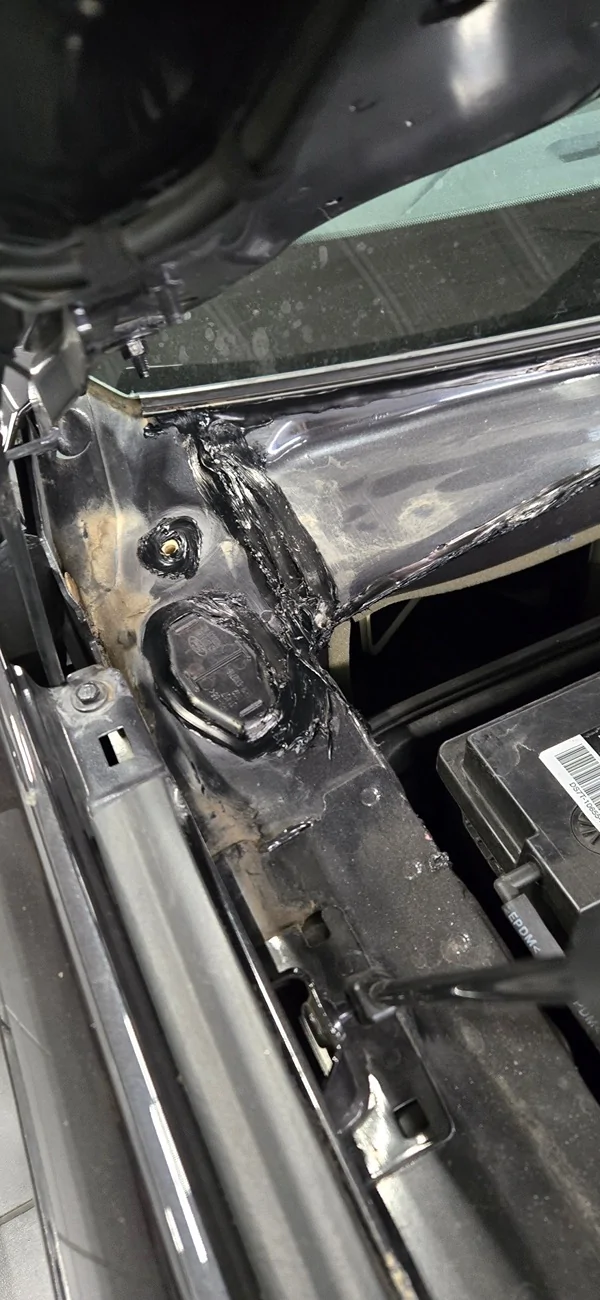

Just got home not too long ago.
They did proceed the sealing after all, which is fine with me. There wasn’t any water leaking before or after the sealant was applied.
They did a good job, didn’t find any mess or blobs anywhere.
Hats off to my Ford Dealer!
S650 Mustang 25C43 Water Intrusion Recall IMG_7701
S650 Mustang 25C43 Water Intrusion Recall IMG_7703
S650 Mustang 25C43 Water Intrusion Recall IMG_7702
S650 Mustang 25C43 Water Intrusion Recall IMG_7704
How does the windshield look? Any gaps?
👍🏻 that almost looked like they cared 🍻🍕

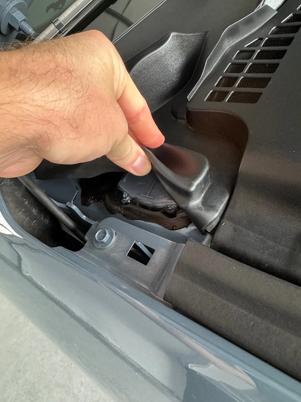

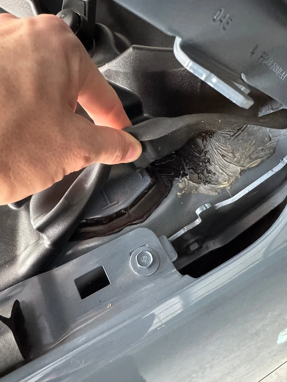

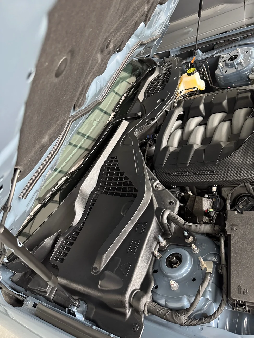

They are wrapping up my car now after completing the recall procedure. No evidence of leaks, and they took me into the service bay to see the work before they reinstall the cowl. The technician showed skill in applying the sealant, which makes me feel good about the overall work. She is staying pretty busy with these as she is the one doing the work on the dealer orders and stock requiring the recall procedure. Obviously mine is not the first one she’s done. I’m satisfied at this point. If I note any issues after I get it home and give the car a really close inspection I’ll let you know.
UPDATE: I took a really good look at my car today out in the sun and everything looks good. No issues. I should have taken pictures yesterday when I saw it apart in the service bay, but forgot to do so. I did pull back the covers somewhat today and this is an example of the work performed. Kudos to Phil Long Ford of Chapel Hills in Colorado Springs!!
and the Ford app already shows that the recall has been completed (no outstanding recalls).
S650 Mustang 25C43 Water Intrusion Recall IMG_7356

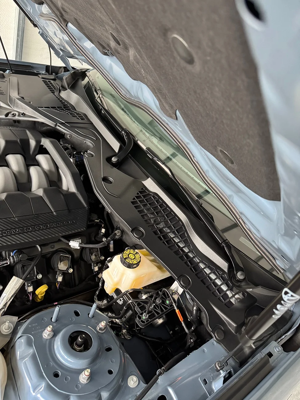

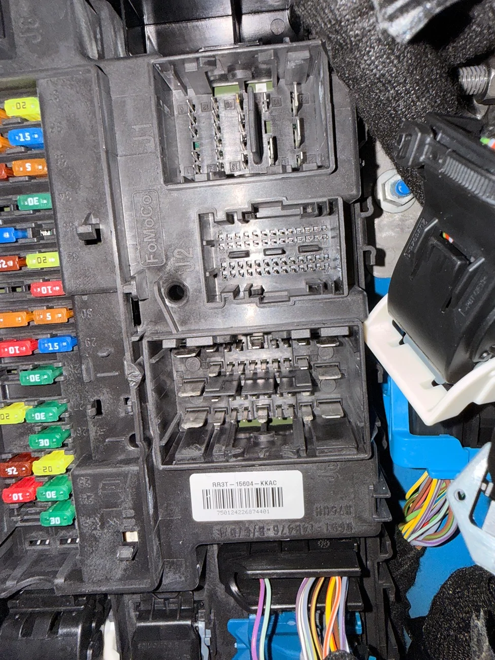

Thanks for all the info. I decided to do the inspection myself and wanted to ask if you see the need for me to proceed and apply the sealant. Thanks

Looks good to me, I opted not to do it on mine. Officially, I would imagine that I am expected to tell you to get it done regardless, but none of the ones we've done here so far have had any issues.

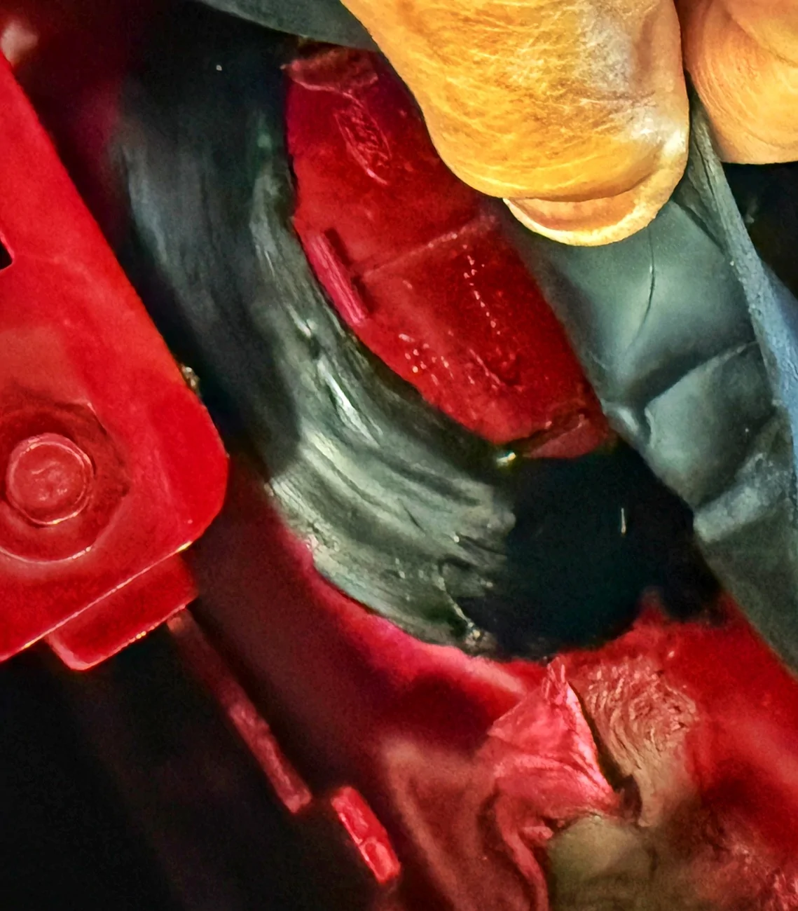

Gotcha, I see one pin which I’m worried about, J1 pin 16. Am I being too ocd ?

I doubt it would be just one, the whole cavity would show evidence of it.

My dealer just told me no problems. He also said as long as the recall is open, the work can be done if anyone prefers not to have their car messed with. They do recommend checking the BCM.

My dealer just told me to just have the BCM inspected and leave the rest alone. As long as the recall is open, you can have it done. I'll take my chances.
Has anyone heard of or had a bad BCM?
