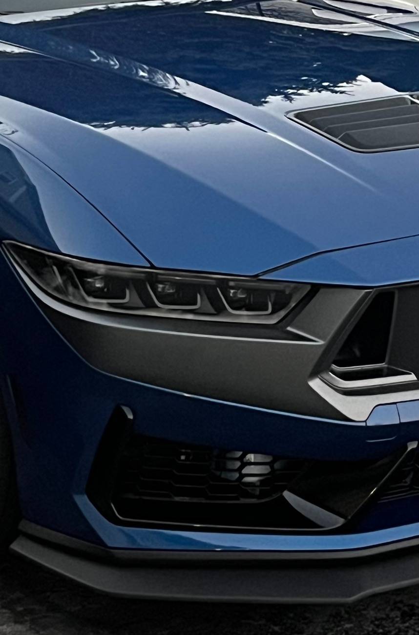

Hello all! Quick question. So I have a 24 GT with the PP, so the bottom right grille has that little shield, while the driver side does not, for the oil cooler. I purchased an aftermarket dark horse conversion kit, which didn’t come with that shield. Do any of you know if that shield is really needed? It only covered part of the washer fluid reservoir. Picture attached.

Yeah I’ve seen that too, but from looking at it with the bumper fully removed, I believe that was a myth. Under that vent is strictly the washer reservoir and its lines.

I’m not entirely sure. Maybe the dark horse has an extra cooler there, but I doubt it considering it’s covered on dark horses as well. Part of me thinks it was there for 1) to protect the reservoir and 2) for cosmetics, no one wants to see a big white reservoir on the corner.

I’m not entirely sure where people get this from. The ECU is not there, I can confirm that because I ripped my bumper off, I know everything that’s under it. There is definitely no ECU down there.

Interesting. Will definitely need to check. I have a picture of the bumper fully removed, so I can see anything and everything beneath it, didn’t see anything dangerous.

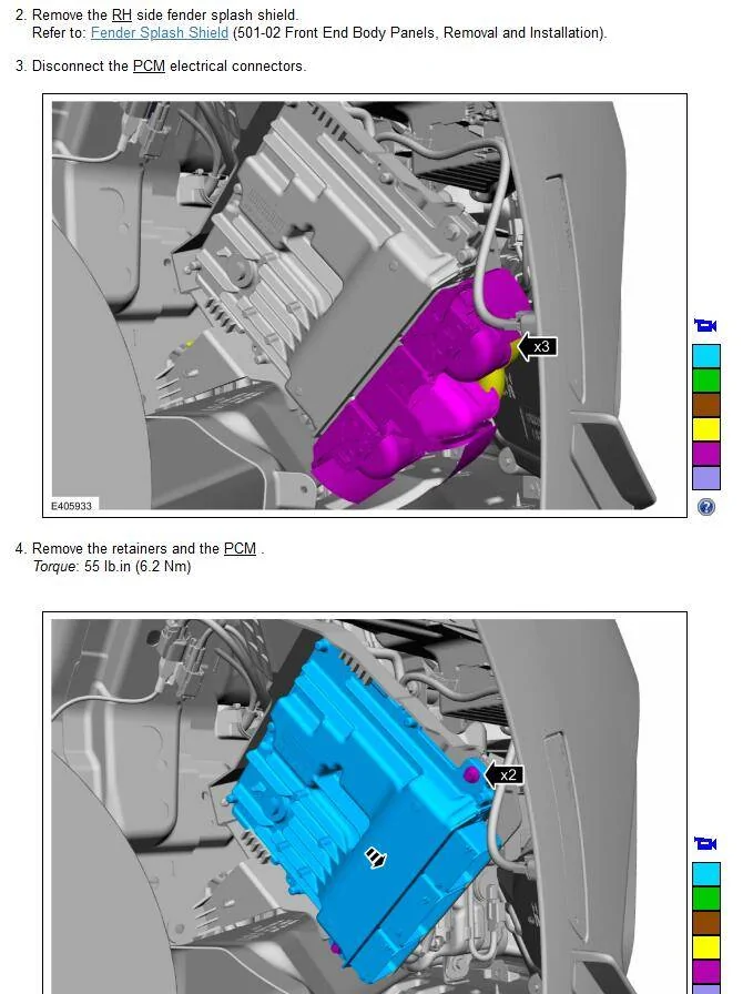

this is a screenshot from the workshop manual instructions on PCM removal
S650 Mustang 24 S650 Closed Lower Grille Removal 1731519125500-cu
in the diagrams, you can see the front marker light as well as the cover for that right vent

Really interesting. Probably why I didn’t see it. It’s not really in the area that’s covered, it’s more in and up. I see. So I should definitely find something to cover that up somehow.

yep, unless you dont mind people trying to unplug your PCM

true, but it still might be possible if someone knew what they were looking for. as for the waterproof thing, it probably is IP65 or IP66, but i would definitely not risk possibly exposing the module that controls the engine and transmission to more water than it already is

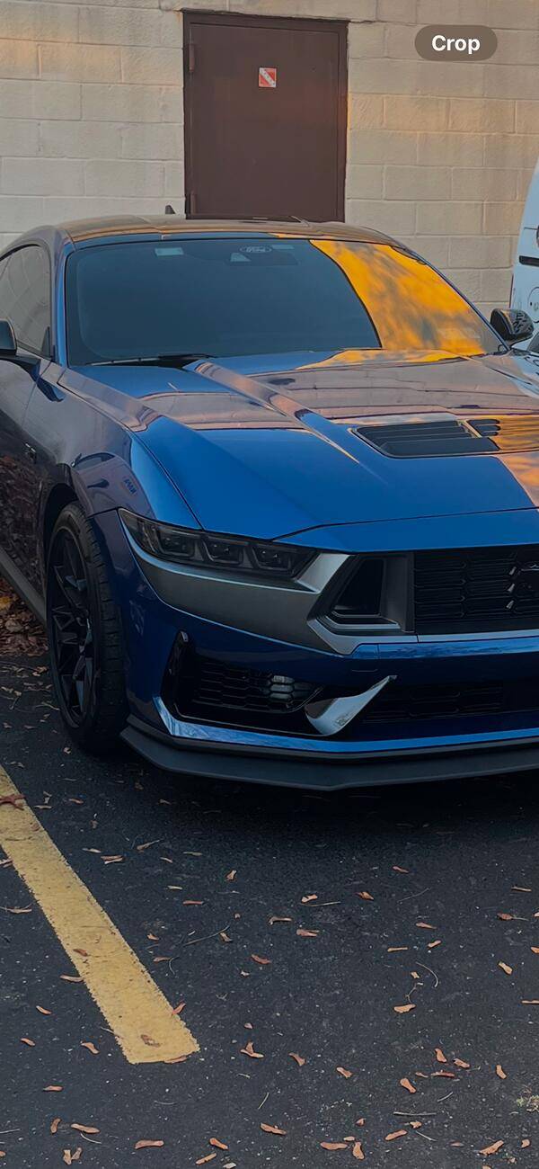

Yeah. I gotta figure out what to do. Dark horse conversion didn’t come with a cover.
