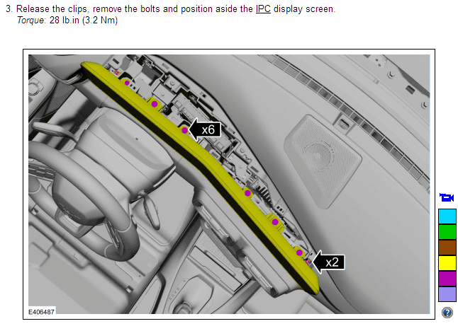

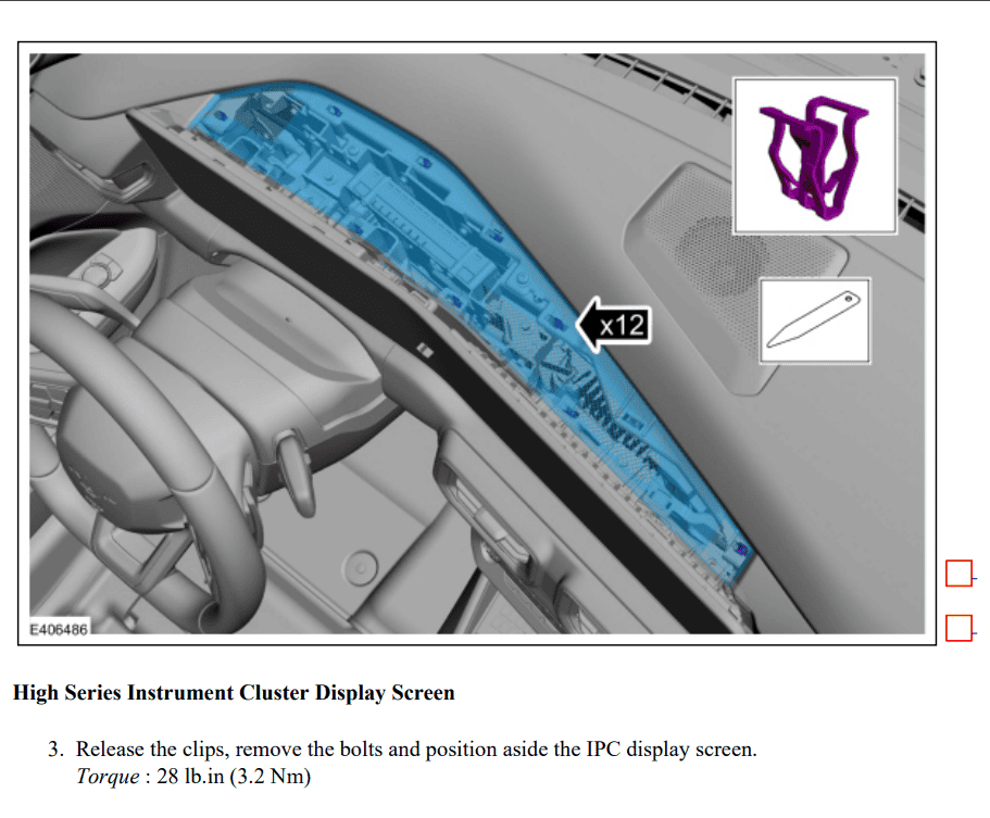

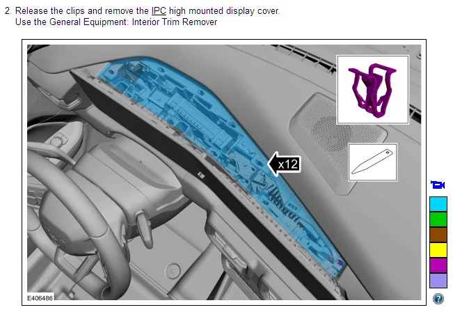

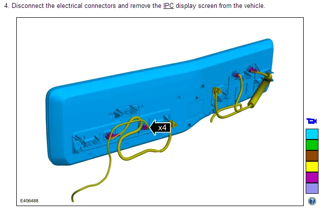

the screen is held on with 6 bolts and 4 connectors, plus 2 clips

Ford actually made the replacement logical and apparently quite easy. I wonder what the cost of the full length screen might be though?
Also, quick question about the Shop Manual pic... Mine does not show the colors or camera on the right side of the page? What are those for? Here is my pic.

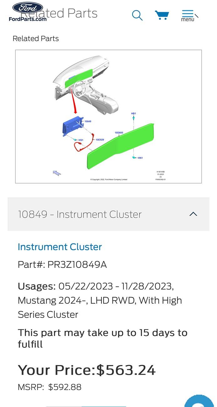

I'm stunned, based on other cars I've worked with, a screen was anywhere from 5 to $7,000 if damaged

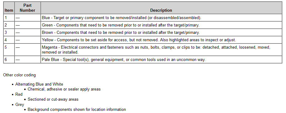

what are you using for your source of pictures? im using PTS/OASIS
here is what it says the colors mean
S650 Mustang 2024 Dark Horse Mustang Digital Screen Replacement 1722868913478-5h
the camera brings up a video showing how the workshop manual works, and the question mark brings up an entire page of the details on how the workshop manual works

I have ecoboost base model 2024. I have two small screen but I want to replace it with one big screen. If I buy this screen that you share does it fit to my car ?
It's just a long touchscreen monitor. All the computing is done outside of the screen.
