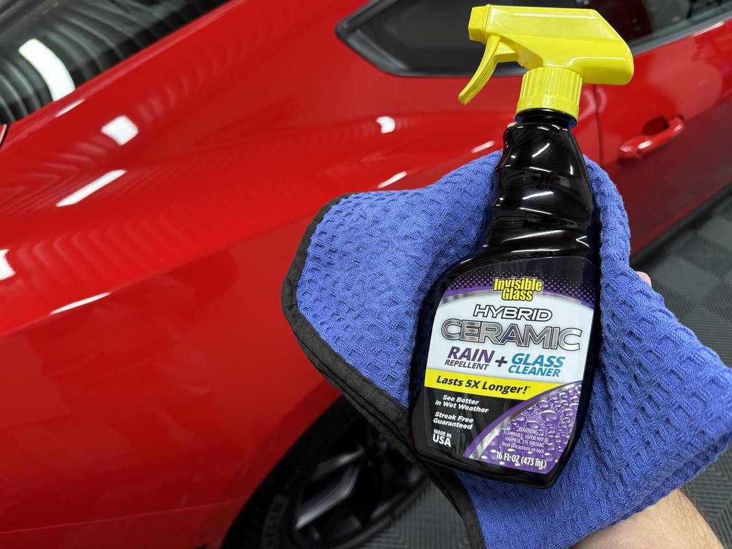

A couple of things to consider -
1. How clean is the interior side of the glass? With new cars, as the interior off-gasses, it leaves a film on the glass. It can take many months for this to stop happening, so frequent interior glass cleaning will be required.
2. When attempting to remove this film, you may need to clean each section twice, the second pass with fresh towels to prevent transferring the residue from window to window, or putting back what you tried to remove on the first pass. Use an IPA-based cleaner such as Stoner Invisible Glass with waffle weave or glass-specific towel. Do bother with newspaper, that hasn't worked since the 80's.

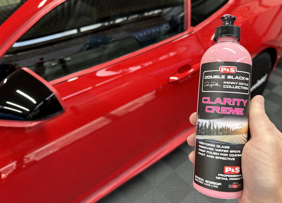

3. If you still have the issue after using a clay bar and cleaned the interior side, then you will need to polish the glass. You can do this by hand or machine, of which I would recommend P&S Clarity Creme.
S650 Mustang Windshield blur is killing me when it's raining! IMG_2369
4. From here, apply a glass coating or rain repellant. I like Gyeon Quick View. You could also use a clean & protect type glass cleaner, of which Optimum and Stoner's I've found to be very easy to use, P&S Reflect is also a good option.

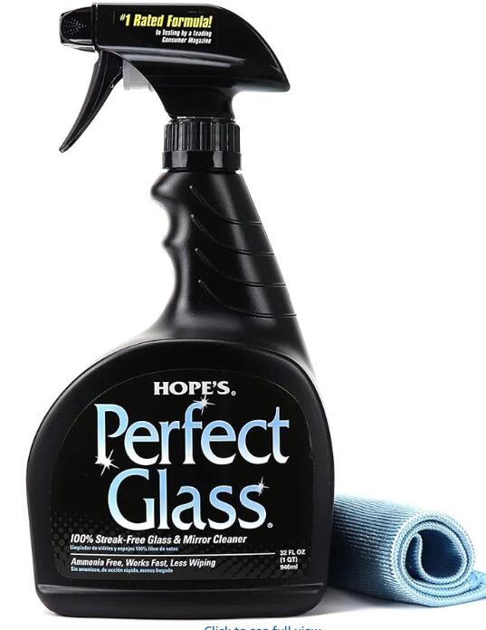

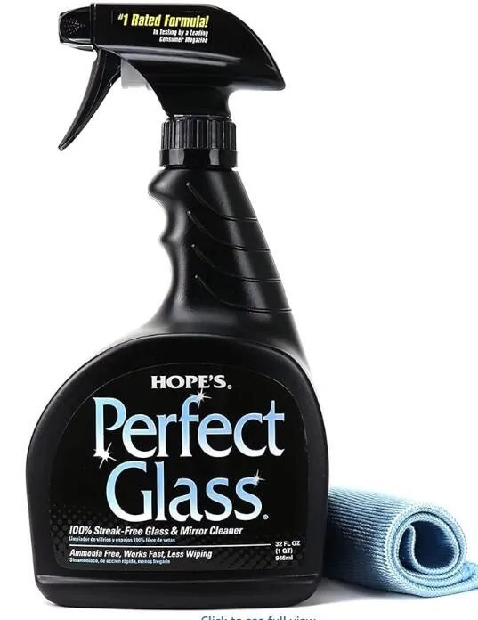

Seriously, the world best best glass cleaner is Hope's Perfect Glass (can order on Amazon, spray bottle and larger refill bottle). The wife swears by it and nothing I have found comes close.
S650 Mustang Windshield blur is killing me when it's raining! 1747320961515-ok
