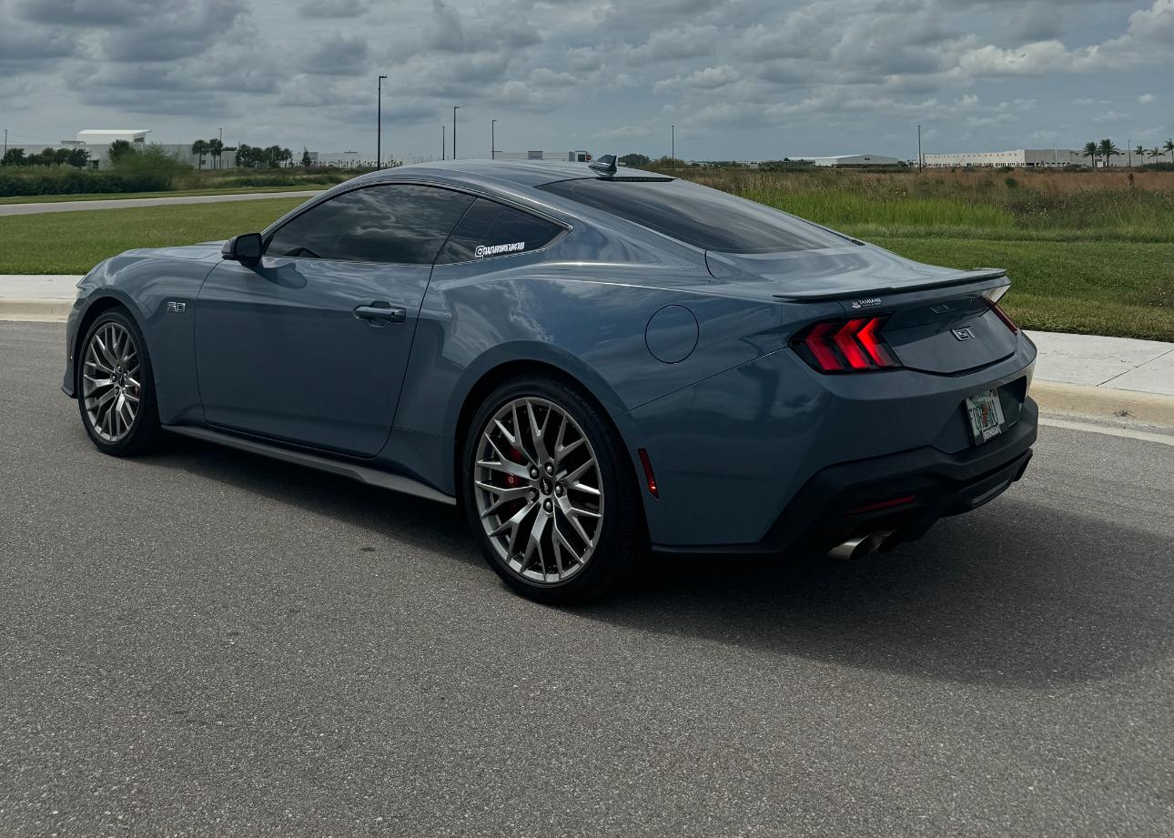

Hello All!

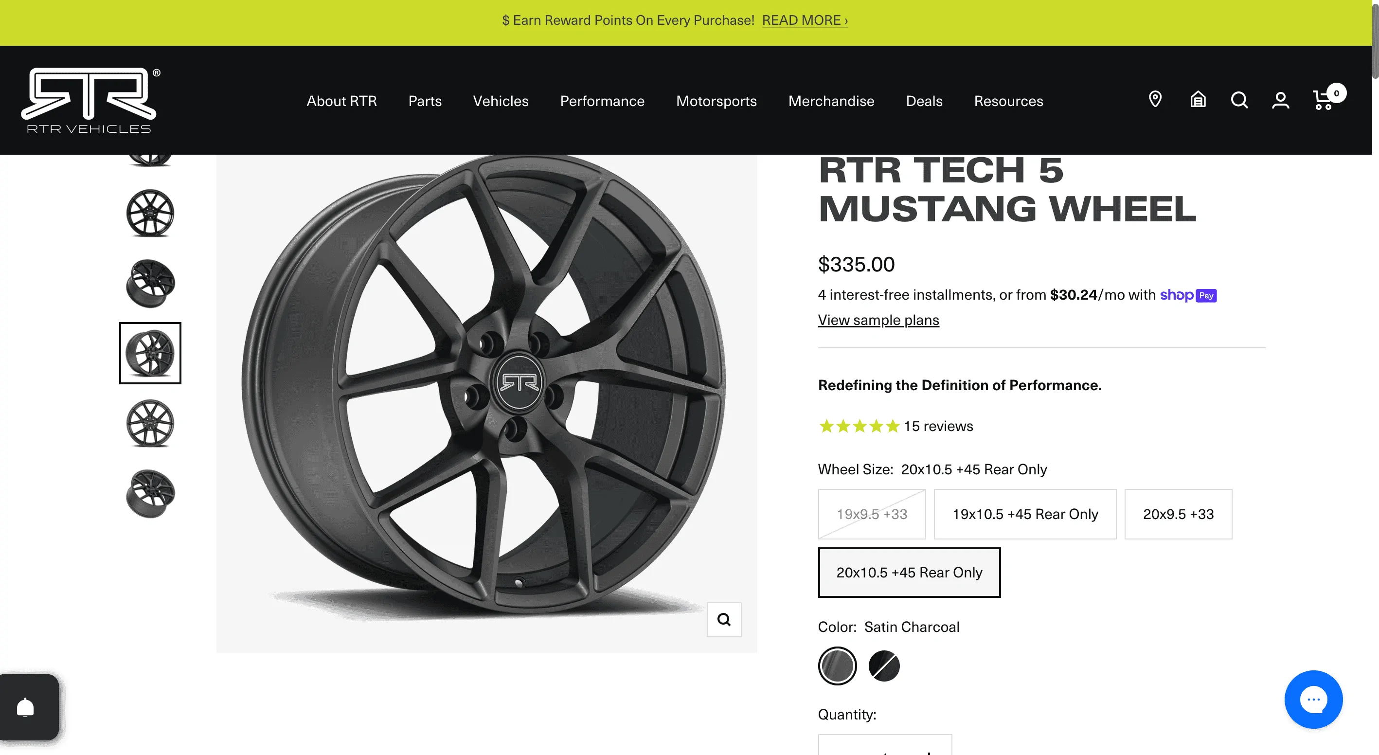

I saw a thread about this very topic from quite a few months ago and reading through it all it seems no answer was concluded. Cannot find anything online about what the stock wheel offsets are on the new stang. Wondering if anyone can help me since I plan on getting RTR Tech 5 wheels and their offsets listed are only showing positive offsets, even though i want it to be nearly if completely flush without spacers.
For reference I have a GT Premium with the upgraded GT PP1 Aluminum 20" wheels with 265 tires. I also have the brembo package installed! It is a tight fit. Any ideas how to help me?

Yes thank you. pretty sure they are the same! I want to go 10.5 wide so I can put 295-305’s on there but then what about if I want it to be flush? So right now with it being let’s say what you state at 42.5, getting the RTR’s at +45 mm wouldn’t that just push my wheel in more? Like make it even less flush? So really I would want to get +40 maybe? But they don’t have that option so maybe with the wider rim it becomes flush?
I wonder if I can get a custom order placed like I just did for my 72 F100 with another company.

double checked the website, all non-forged RTR wheels minus the aero5 run 33/45 offsets so if you want to know what your fitment will look like you can just Google images and you'll be right on,
from factory the cars tend to be a little bit tucked anyway but for some quick math
You're going from a 9 to a 10.5 rim which is a 1.5 difference overall or .75 on each side, .75in = 19mm wider on the 10.5s. Outside edge. The rtrs are at a 45mm offset as compared to the 42.5mm of the oems. Difference of 2.5mm so 19-2.5=16.5mm or .6 inches outward from where the wheel is now.

I don't see where you've mentioned trying to run this square, but just be aware I don't think this setup will work on the front due to strut clearance. Assuming the stock wheel is 9" with a +42.5 offset, then going to a 10.5" with a +45 offset is going to bring the inside of the wheel 22mm (roughly 7/8") toward the strut. Yes the wheel will push .6 inches outward from the stock wheel, but it's going to be almost .9 inches inward as well. The increased offset brings the centerline of the wheel inside. This of course only considers the wheel, it will vary based on the actual tire width. You could run that wheel on the front if you add a spacer.
