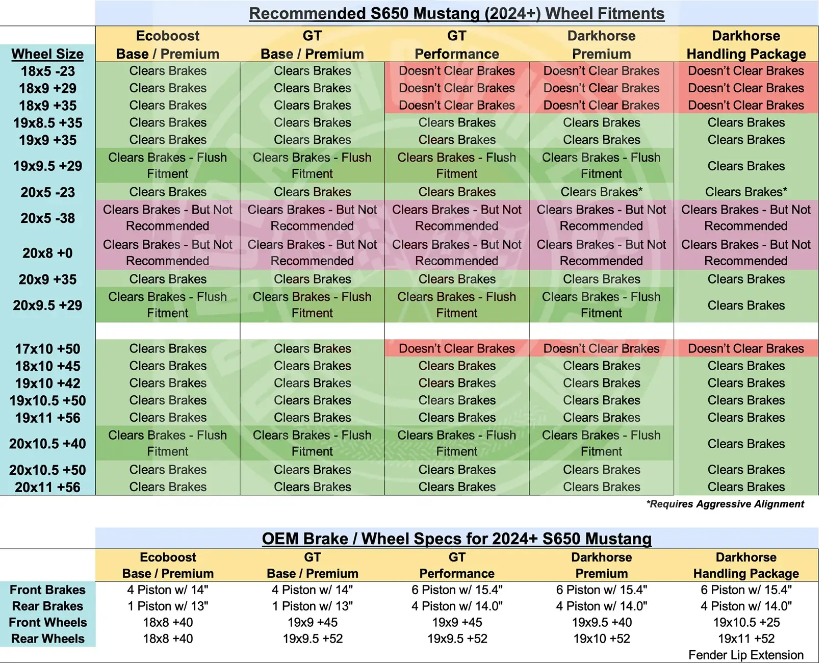

There are some limitations in fitment for S650 over the S550. These below fitments can be applied to most other style wheels including Vossens which we sell too.
S650 Mustang 2024 Mustang Wheels Offsets & Fitment (same as S550)? 1762344666014-hl
Ive been looking at some wheels to purchase for my S650 for whenever i close the deal and get my pony. Does anybody know what offsets or fitment would be needed for a GT Premium? Is the offset going to be the same as the S550? And if so what kind of offset would i be looking for to get a nice clean fitment without needing spacers? I know most of this information is probably not readily available yet, just figured id throw it out there and maybe see if i can gst a bite. Start getting quotes and all that good stuff. I was leaning towards vossen HF-7s polished silver. Lol thanks!
