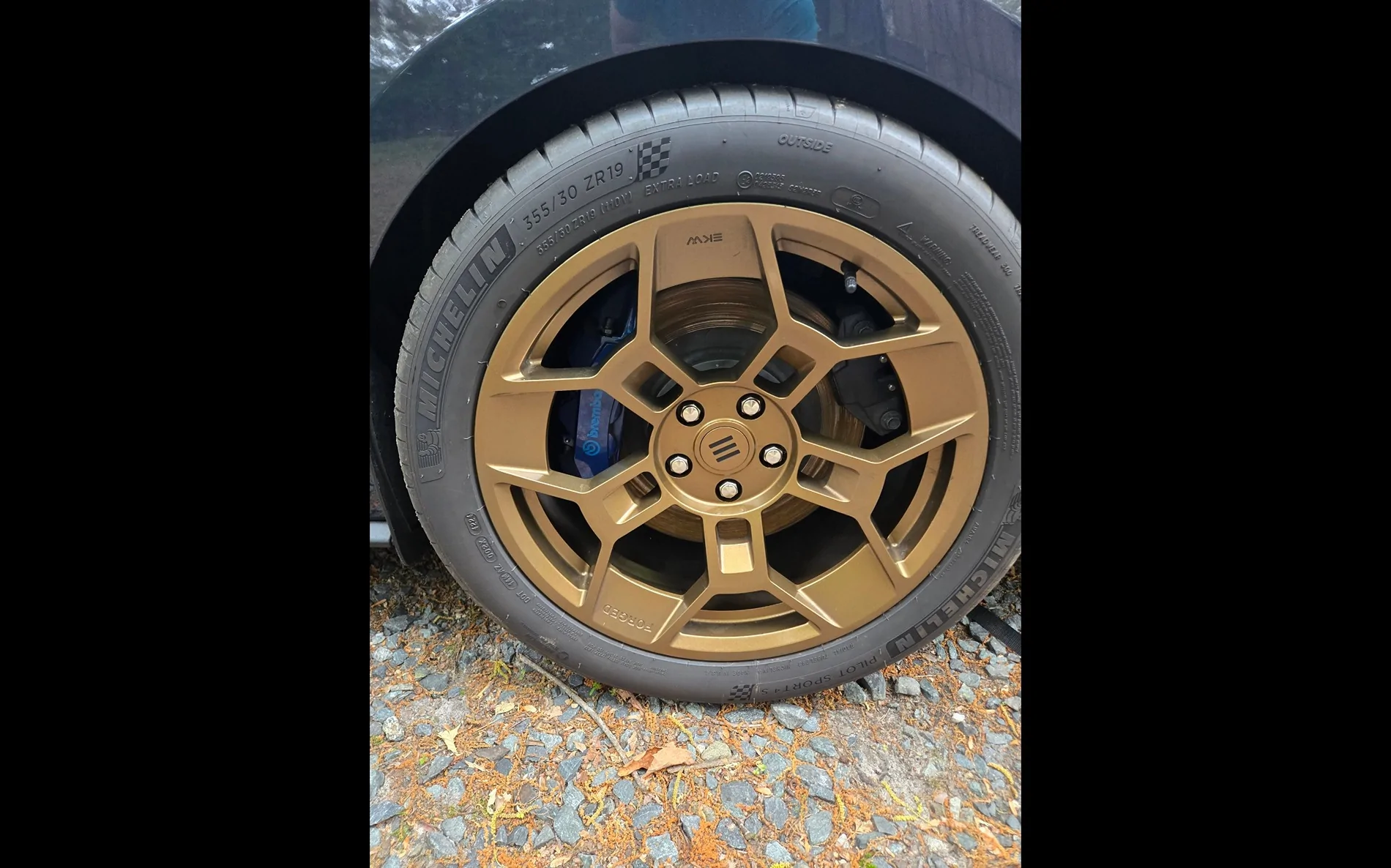

EKW GTD replica wheels. Don't have a side view right now, but they dont poke out because the rear rims are slightly undersized for the tire width.
Front are 19 x 11 ET30 WITH 325/30/19
S650 Mustang 2024 Dark Horse Wheel fitment 20x12 Screenshot_20260218_184853_Photos
