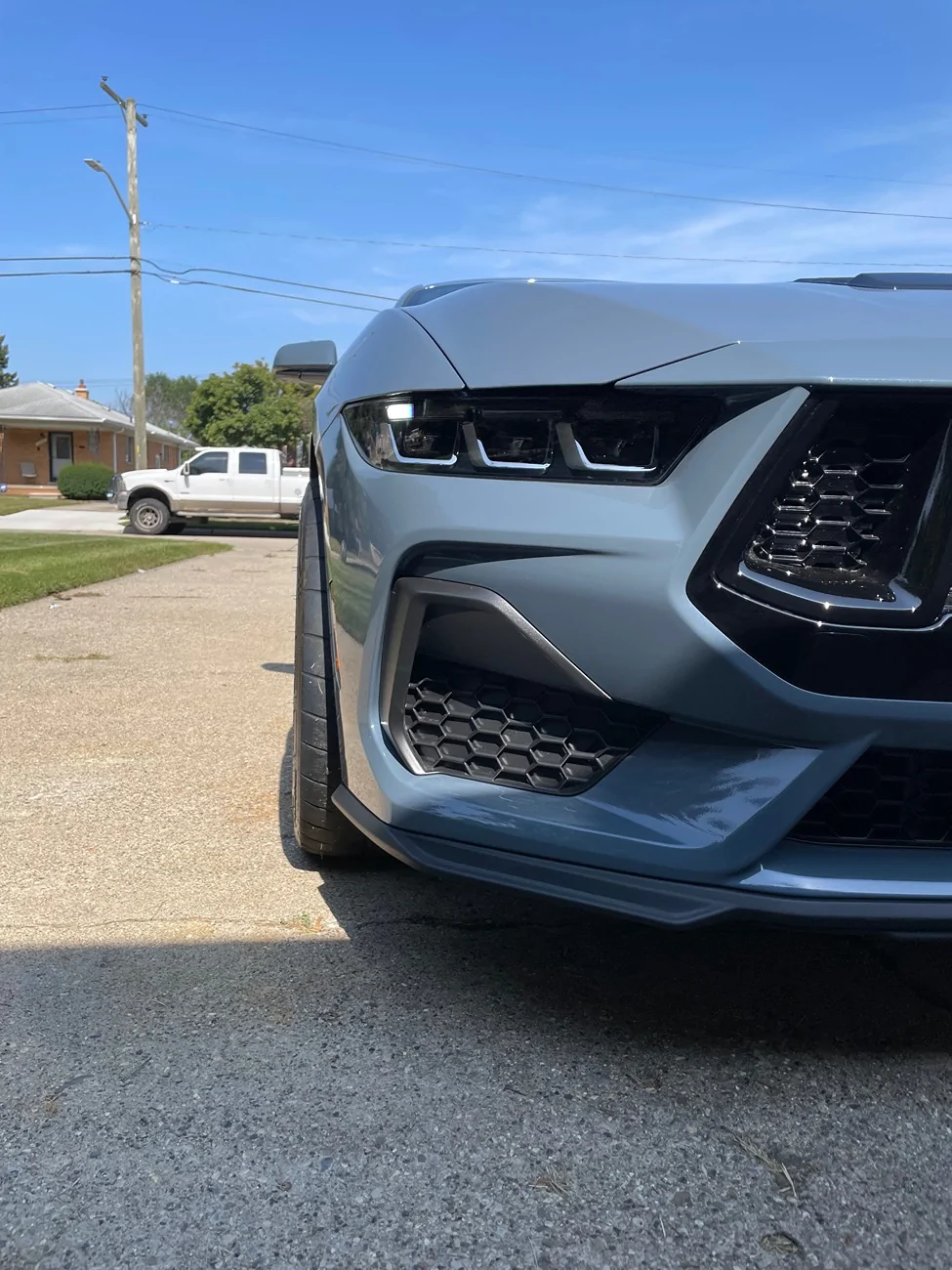

I will. I’m not sure if you were retaining all the actual ford parts - struts/springs/etc because they mentioned that they can’t validate the wheels will fit if using anyone else’s suspension components
Where exactly were yours rubbing? And when? On the inside- was it a wheel lock issue or did it rub when just moving straight? What were your alignment settings? What tires were you running? And was it hitting the tires or the wheels?

I have Factory MagneRide struts on my PP but am using Ford Performance Track Sway Bars, and Springs. I was using 1.21 degrees as specified in the owner's manual for the dark horse street setup. The Interference was with the strut tower itself using MP4S tires.
Another member with regular PP @Joe_Cool was able to get the wheels bolted but had rub on turn:
2024 Mustang GT Performance Pack with Mach-1 Handling Pack Wheels | Mustang7G - 2024+ S650 Mustang Forum (Dark Horse, GT, EcoBoost, GT500, GT350, Mach 1)
The front PP wheel is ET45, since then based on my measurements with this issue, I went 35 on wider wheels without issue.

Wouldn't a small spacer have fixed that?
Yes, as I mentioned in my previous comment about the wheels, you would need a spacer with this setup. Cosmetically it's fine, however, as someone who tracks their vehicle you do not want this.

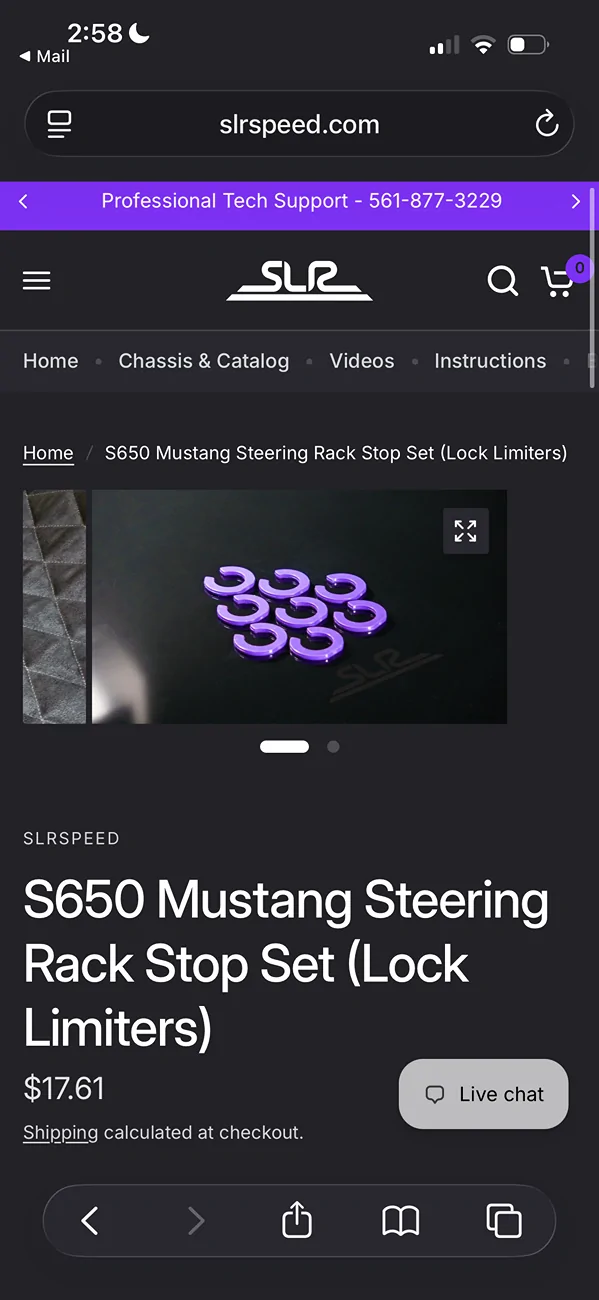

Yeah I’m thinking a small spacer and if needed wheel turn / steering locks like these:

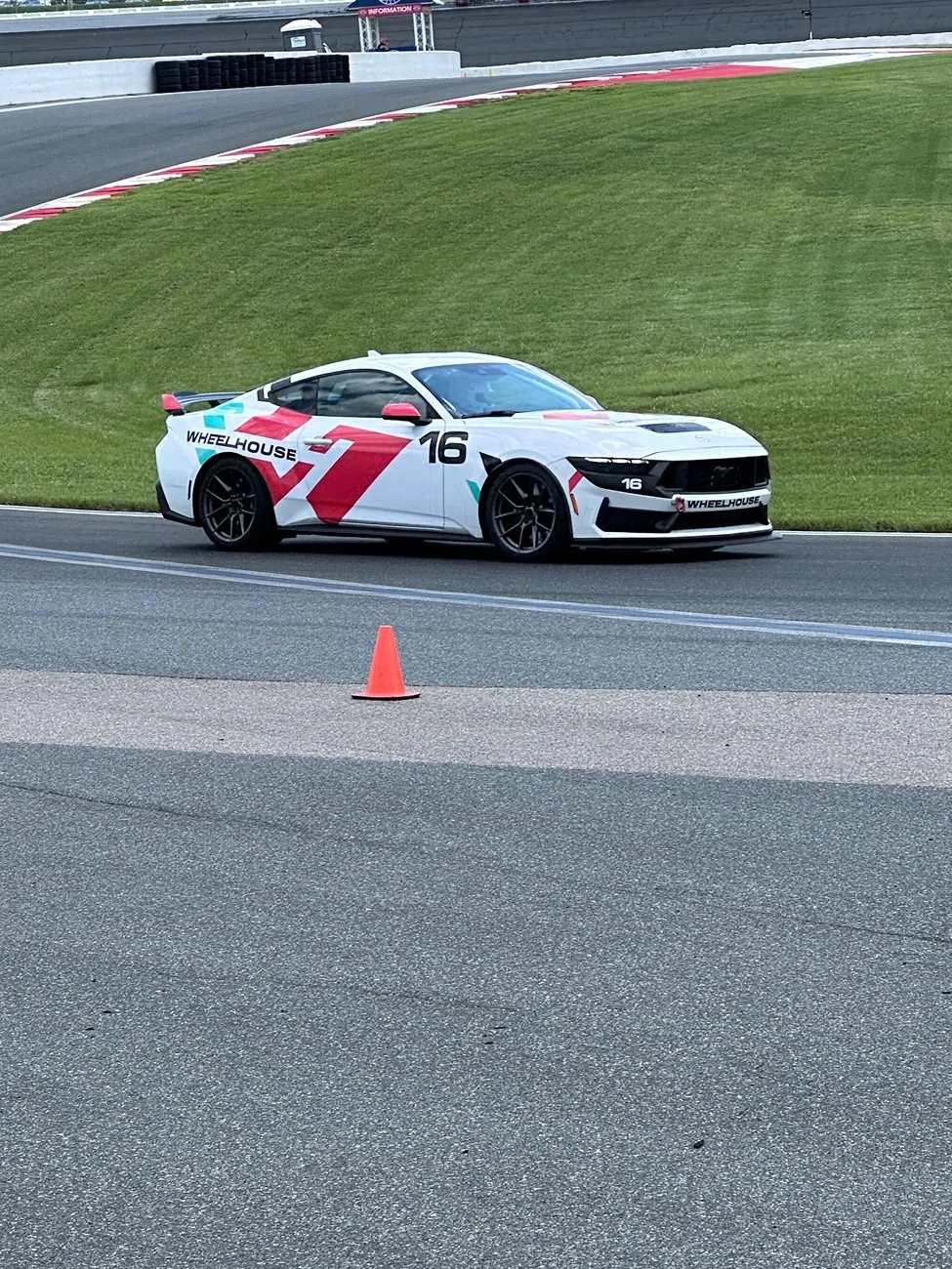

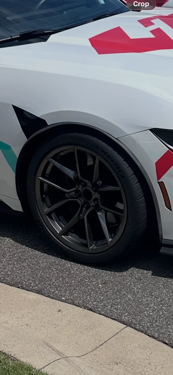

I’m not sure why you don’t want spacers if you track your car- hell even the ford racing team uses spacers on the Dark Horse R they race.

It's not that simple, unfortunately. You will want 10MM of additional spacing to help those wheels fit.
This, as in spacers?
Lots of guys tracking their vehicles with 24-26mm spacers up front to run the same backspace front and rear (52) with 11 inch wheels and 305 or 315 squared set up so that they can rotate tires. Some claim that they get an additional track day or even 2 out of doing this.
