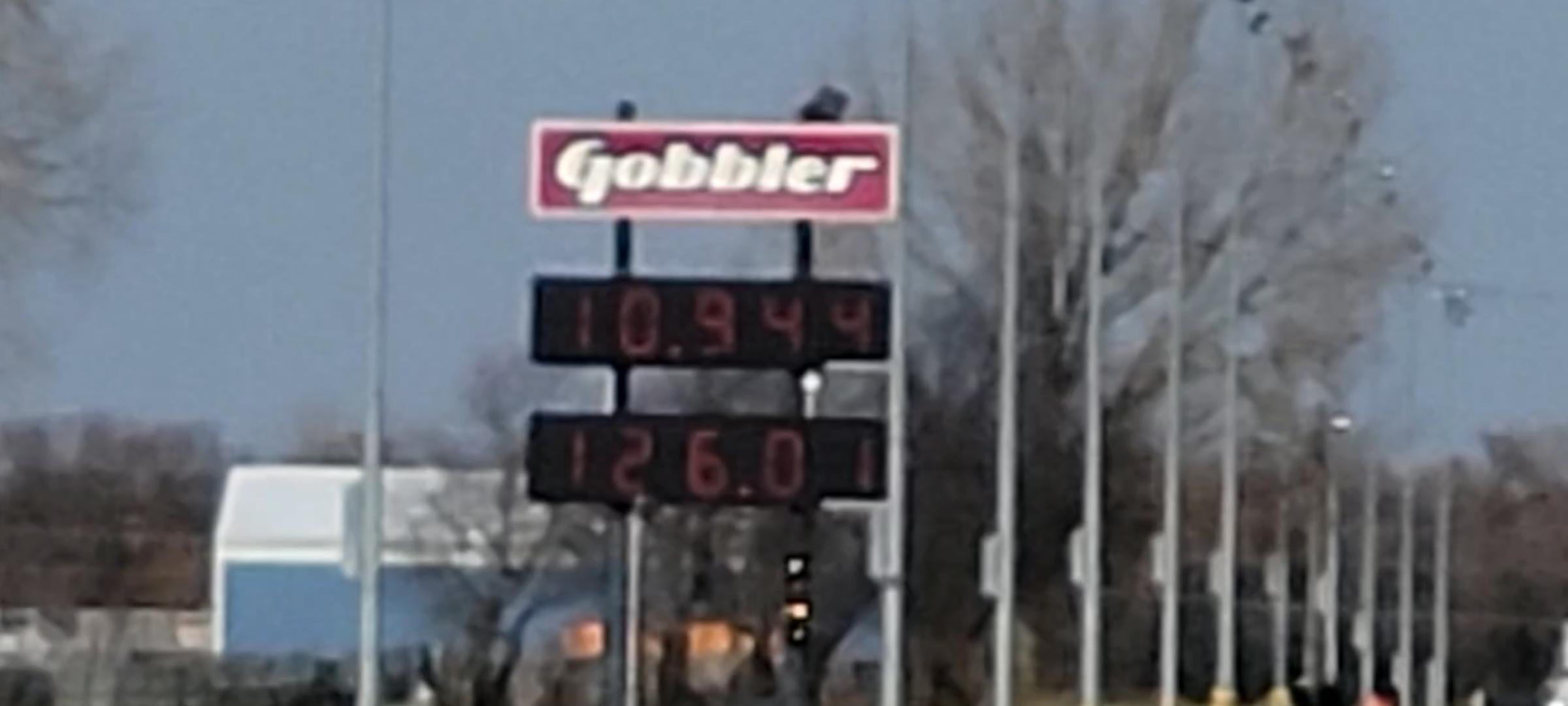

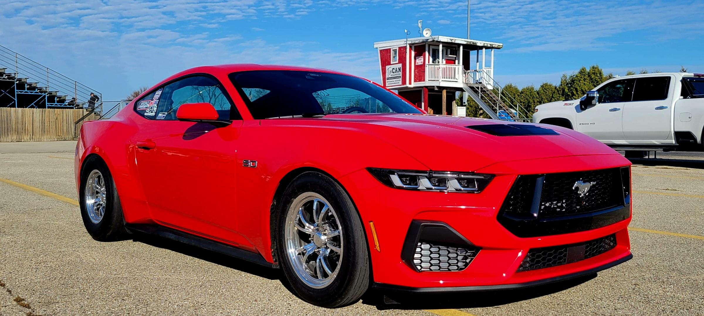

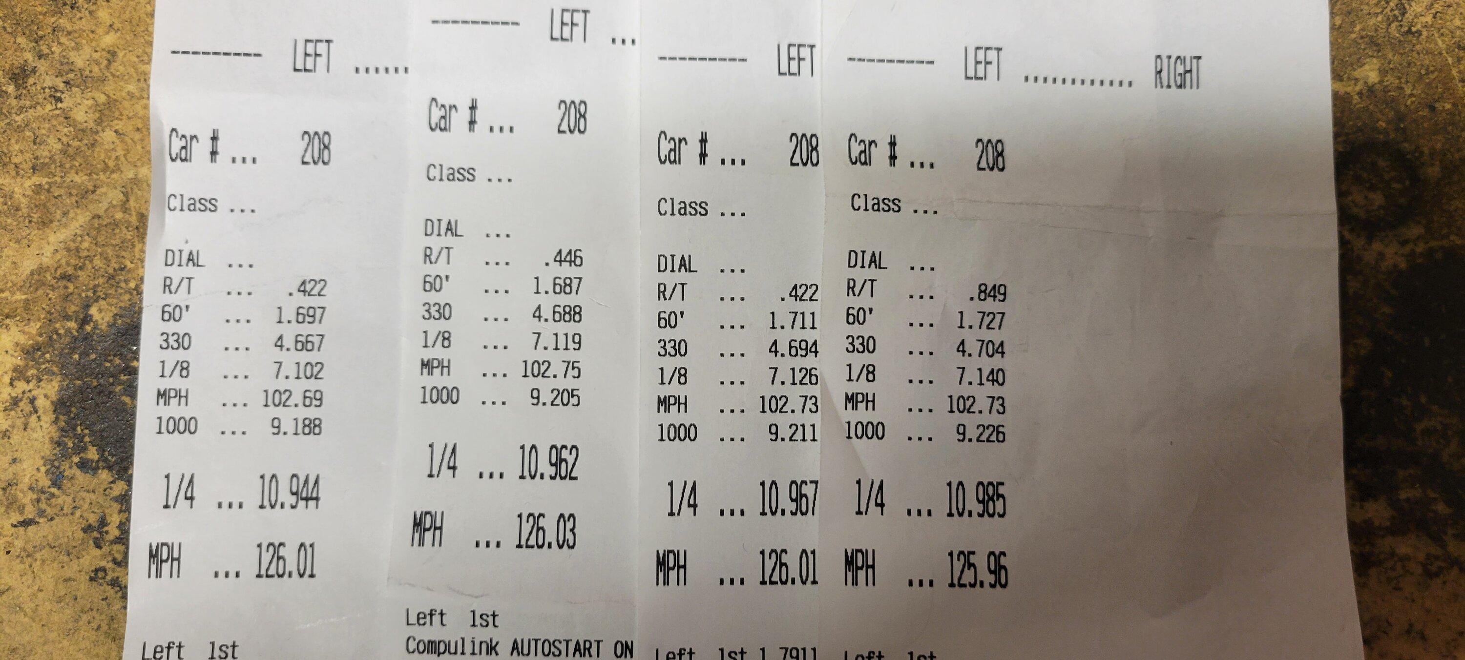

Don't think I've updated my times.
Officially a 10 second car now.
2024 Mustang GT.
Stock tune
Pump gas 93
10 speed
Stock convertor
RC Components wheels
Mickey Thompson tires
Aerospace Components Inc. Drag brakes
Steeda springs
Carbon fiber drive shaft
2M fabrication headers
Herfurth Aluminum Racing Mufflers
K&N air filter
BMR k member and motor mounts
Anti gravity battery
Shelby Bump steer kit
Misc. Weight loss car weighs #3240
Ran a best of 10.94@126 so far

I get asked this alot. It's quite a bit of cash to do what I've done.
But then I look at guys that just throw a blower or turbo on and spend $10-12k on those mods, and still aren't in the 10's.
Now just imagine if I add a good tune on E85 how quick it'll be. Then add boost on top of that. Oh my.
And since I do all the work to the car myself, I save alot of money on labor costs.
So it's not nearly as bad. But it is fun to see the results when you put in the work, and use old school technics to go fast.
Boost isn't always the answer.

Looks like about 500-600 lbs. of weight loss, wow! Interested to know what you completely pulled vs. savings from replacement/aftermarket parts.
Also amazing how consistent those 10 speed cars are.
The factory parts are ridiculously heavy.
Brakes -140#
Wheels and tires -68#
Driveshaft -12#
Exhaust -72
Battery -40#
K member -67#
Those are the big losses, then taking off the stuff you don't need, like the underside covers, front bumper, re-enforcement brackets, front seat bar, the spare tire, plus all the miscellaneous nuts and bolts.
All in all I removed exactly 480# out of the car, with out stripping the interior, other then the back seat.
Honestly I think I could take out another 200+# out of the car without any one noticing.
