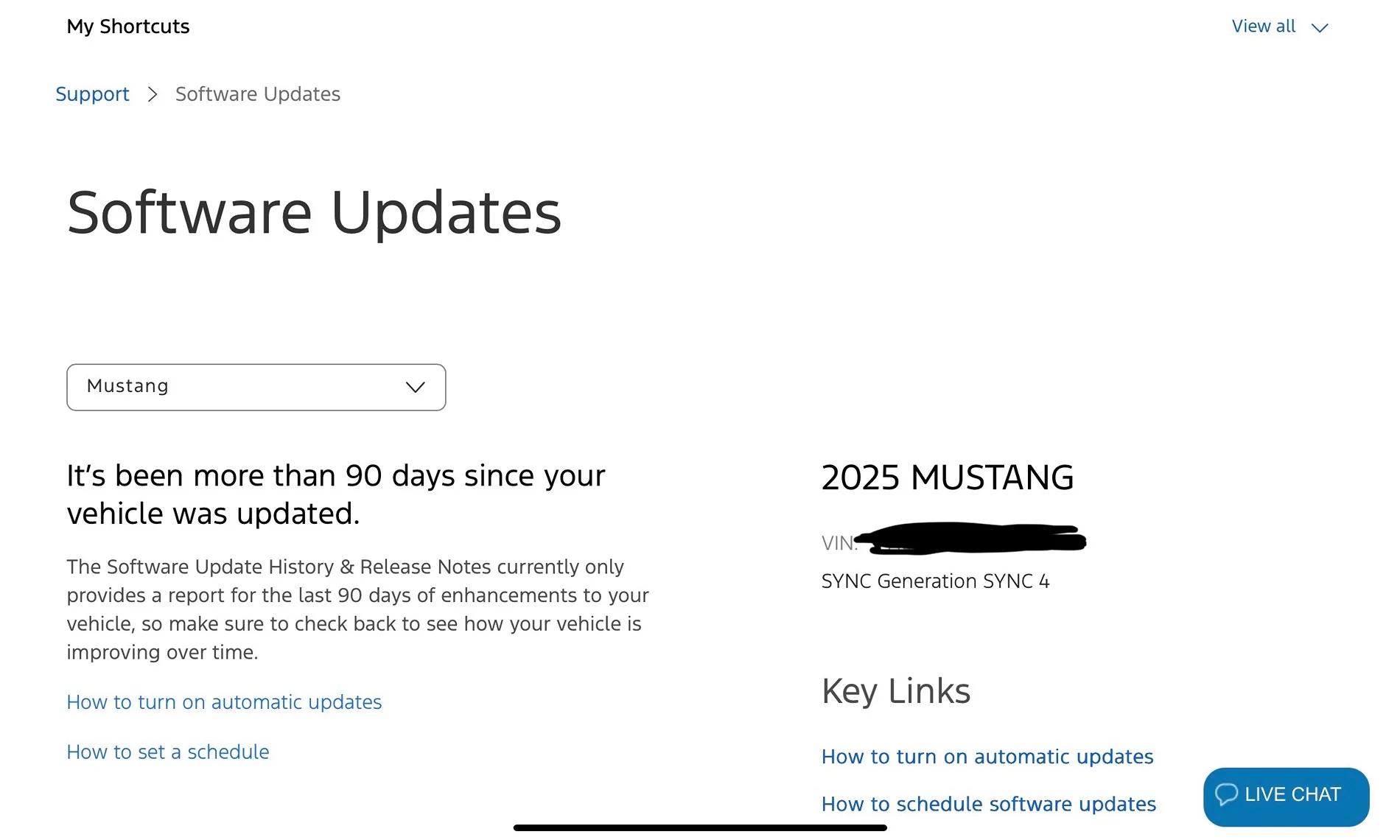

Yeah my bad…you’re right, the app alone doesn’t show software update history…here’s what you do….
Go to Ford.com and log in with your email/password or VIN.
Scroll down to the Support Topics section.
Select “Software Updates”
Scroll down until you can click on “Check Update History”
I got this…
Aha! Got it. Thanks! I get the same thing as you did. Which makes sense given you're a 2025 model as well. Well, we both have the updates set correctly, apparently!
