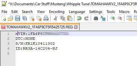

You do realize that if you buy a Whipple from a Whipple reseller, YOU DO NOT UPLOAD YOUR STOCK TUNE, right?. You create a calibration request (If you actually watch the video you linked to, this is explained clearly) and the file that is pulled off with the Tomahawk and uploaded in the calibration request only has 4 lines in the entire file.
The VIN
Any DTCs
The Serial Number of the device
The Part number of the Ford calibration currently installed.
Whipple then forwards that to Ford who sends Whipple the tune to deliver to the customer. If you want to tell me how it works, you better understand how it works yourself first.
