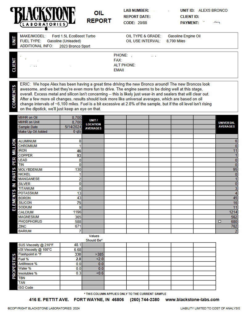

I haven't changed my 2024 GT Oil yet but I just had an analysis done on my sons Bronco Sport. It's a really great way to keep on eye on the health of your engine.

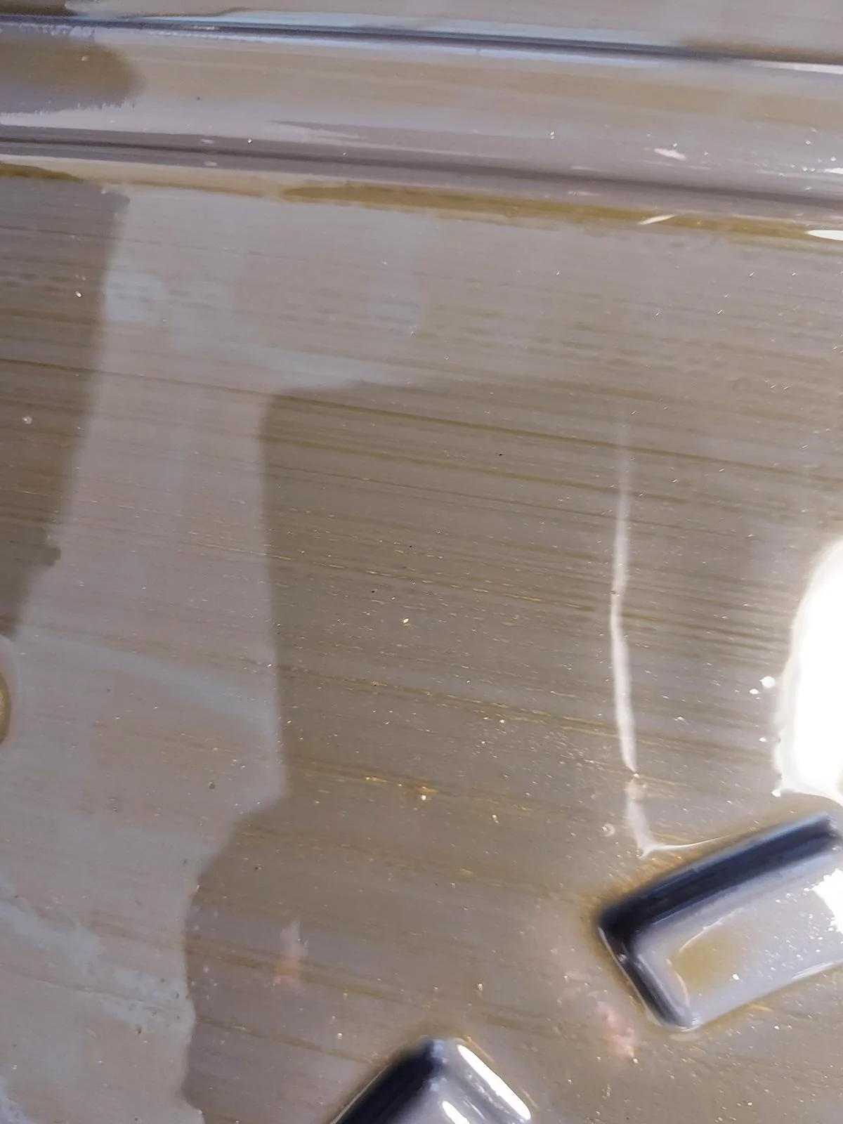

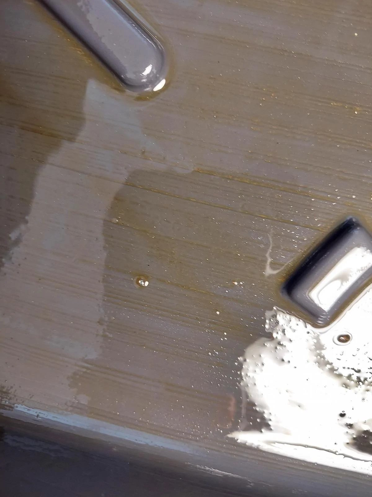

At the first change, I witnessed some of the residue in the drain pan. Not scary large chunks, but some large, gritty pieces. I didn't bother cutting the filter open. I expected any number of things in the filter. Wether it was too much or too little was beyond me. All the tells I saw, things were going according to plan: the engine's internals were wearing in, while whatever was left from that and assembly was coming out.

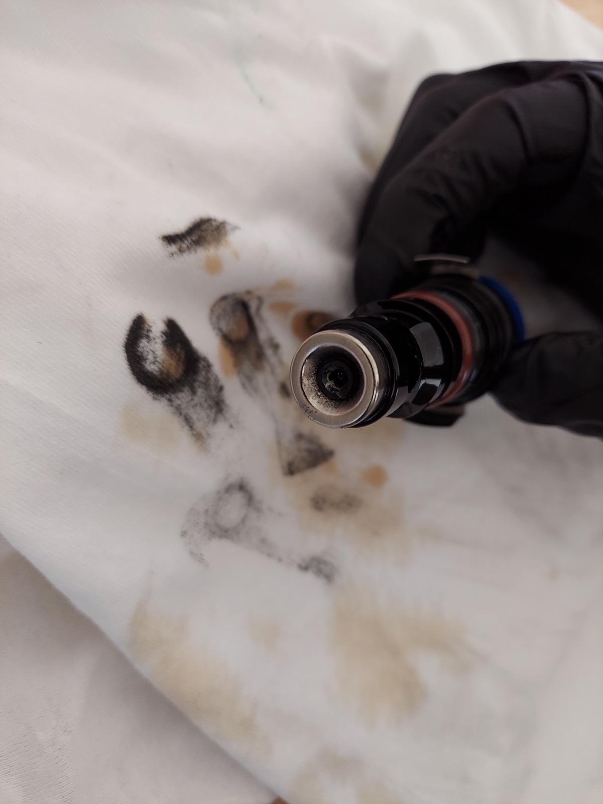

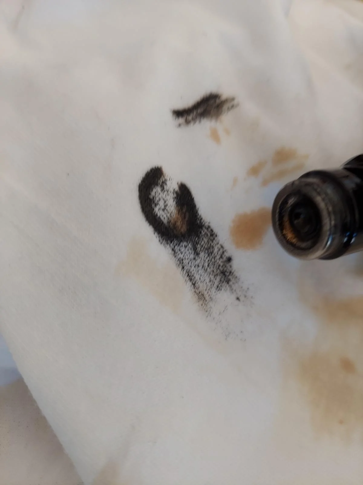

At the time of the first oil change, I installed a drain plug with a magnetic tip. Attached are some photos of what was captured on it from the first oil change to the second. Not bothered by what was collected at all. If anything, encouraged.
To see nothing on the plug would concern me, that internal parts were not seating. And the plug is doing it's job: it's giving me tells as to what is going on while assisting in removing any loose materials not captured by the filter. Those using the factory plug, that loose material will fly out during an oil change. Oil analysis confirms the wear metals are well within tolerances.

When you receive the Blackstone kit, it will have instructions on how to take a sample. In general, halfway through the oil change/drain time on a warm engine. It's just a small tube of oil that needs to be recovered. They should be able to take it for you. Many individuals and people maintaining fleets take samples as part of their programs. The sample kit can be mailed back in the pre-paid, USPS mailer. All the materials needed and instructions will be received in one pouch, from Blackstone.
The oil analysis will give confidence everything is going well. The reports will also establish a baseline, specific to that engine. And when/if the car is turned over to another, the information could help facilitate the sale; it helps prove how well the engine was cared for.
As shown in the example posted earlier, the report will show your results, and a comparison to their baseline, the "Universal Averages". The far-right column is a summary report of a Coyote, using an oil type (dino, blend or synth) and weight similar to yours. Later reports will display a long-term trend (see multiple columns) of your engine, as compared to Blackstone's baseline. You'll also have a remarks section, giving you any further insight on the analysis.
Like oil changes, analysis covers a broad spectrum. Some get one report and are done. At the other extreme, those who track or race often will get an analysis at every change.

So the drain plug pics highlight materials seen from first to second oil change.
I found some drain pan pics, from the first oil change. The specs of materials I consider normal, healthy even, for a break-in period.
While visuals are appreciated and can sometimes offer tells, an oil analysis will actually quantify what is going on while measuring any number of parameters ones senses cannot pick up.
