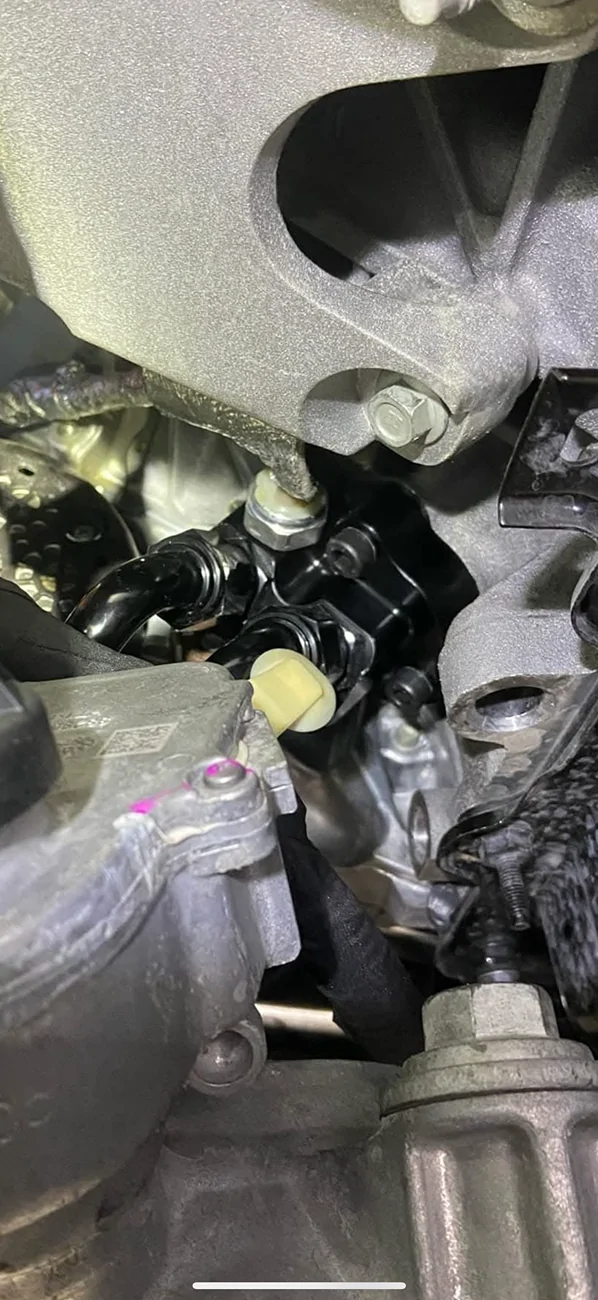

Thank you so much for that info. AD. Yes there is a plug for the oil sensor present on the MMR supplied fittings.
Here’s a pic for reference for anyone that may be wondering how it’s situated. My tech removed the alternator completely.
One thing I’ll add, according to my tech he had to make the harness longer for the oil sensor. It’s a rather short harness he stated so he made the harness longer.
