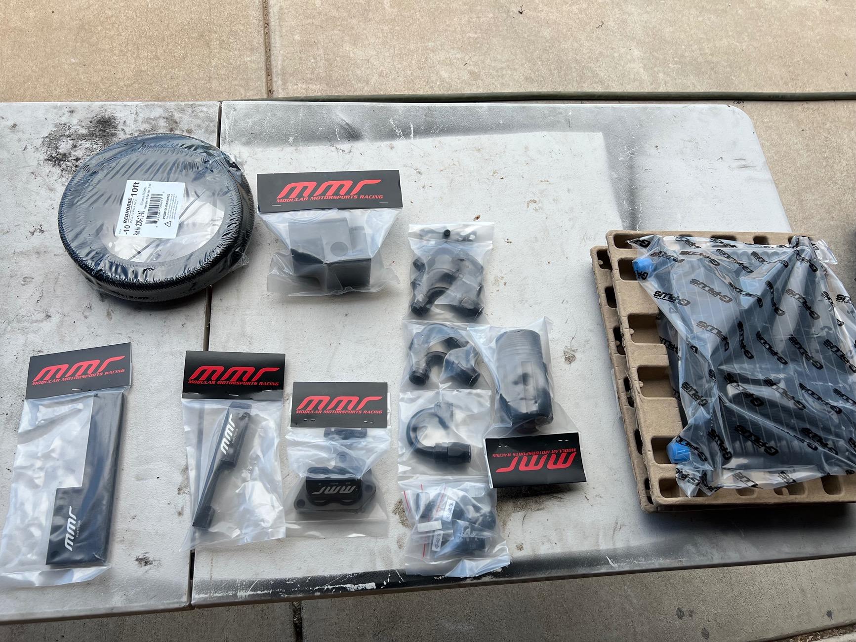

Initial presentation is great and shipping was very fast/efficient:
S650 Mustang MMR Oil Cooler Install / Thoughts IMG_0557

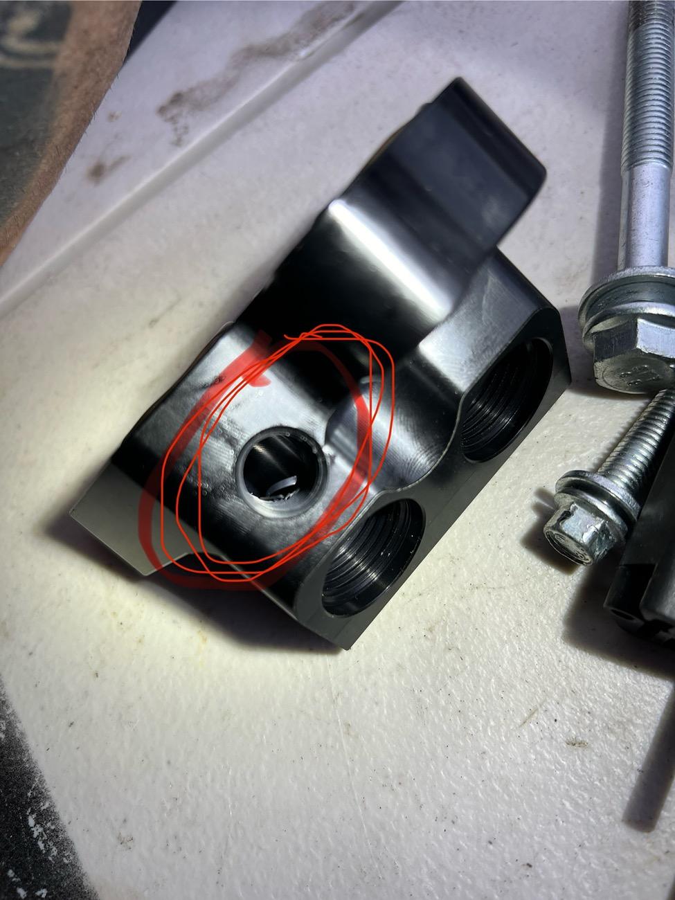

An item of concern is the residual material in the block; make sure you clear your components/lines of any debris:
S650 Mustang MMR Oil Cooler Install / Thoughts IMG_0561

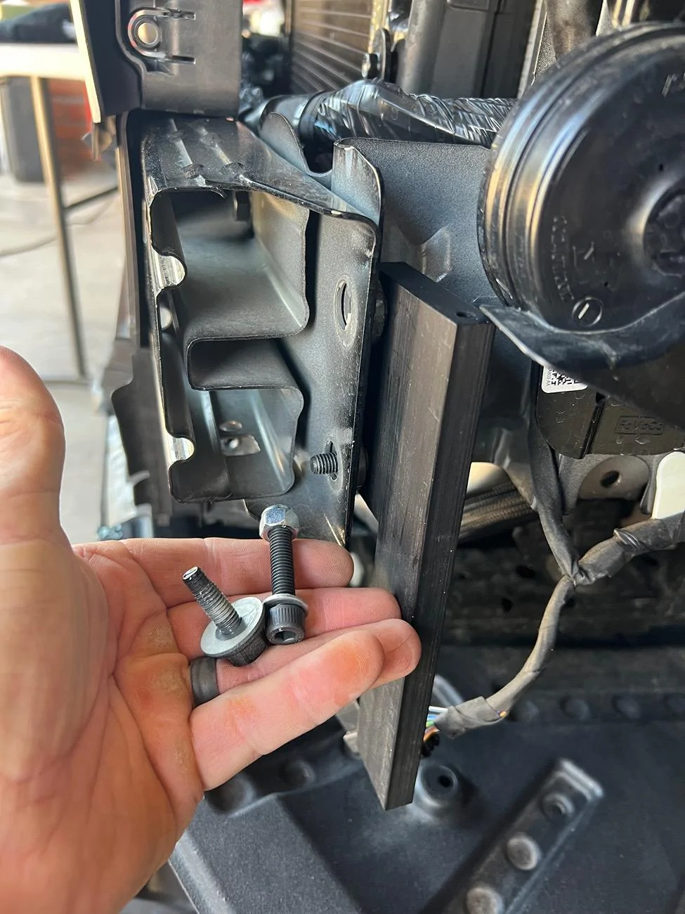

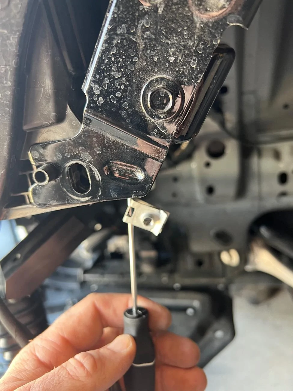

You will replace some hardware and re-use other hardware (this depends on your preference and later, the addition of official instructions). Pictured are OEM bolts and their replacements, and separately an OEM clip that I removed to make things fit to my liking:
S650 Mustang MMR Oil Cooler Install / Thoughts IMG_0563
S650 Mustang MMR Oil Cooler Install / Thoughts IMG_0565

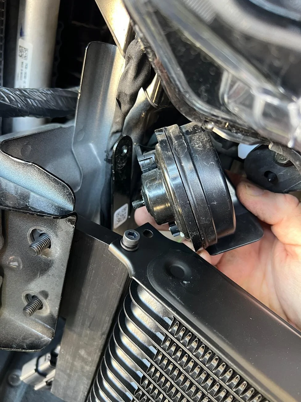

The horns will need to be clocked and/or relocated to your liking:
S650 Mustang MMR Oil Cooler Install / Thoughts IMG_0564

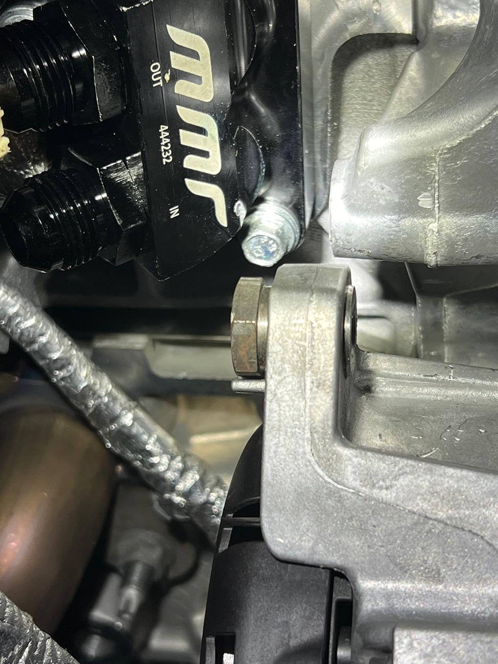

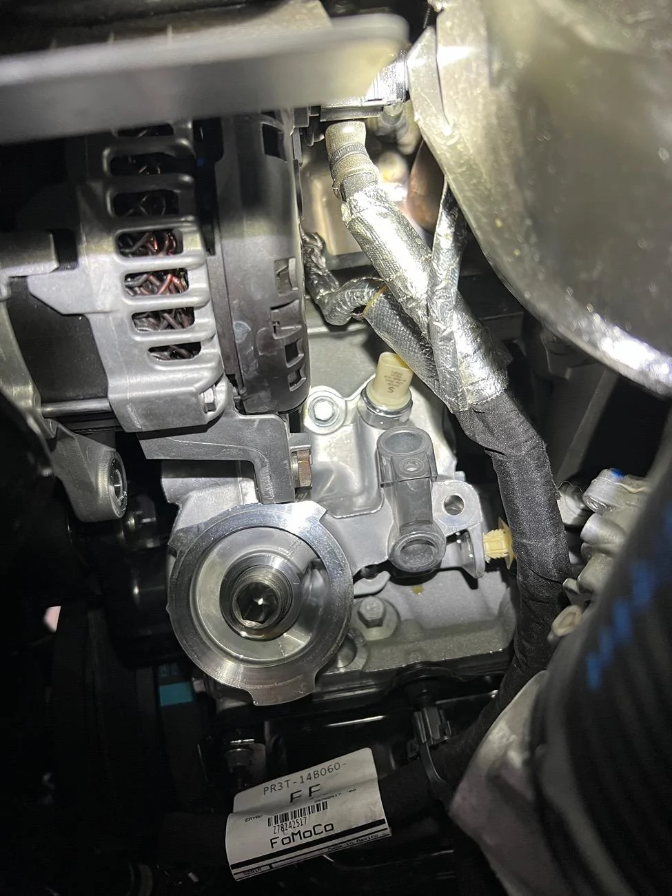

Swinging the alternator down provided the necessary room to access the 4th bolt on the OEM filter mount. There are 4 total bolts OEM, and 3 are used upon reassembly (I think-already foggy memory!):
S650 Mustang MMR Oil Cooler Install / Thoughts IMG_0558

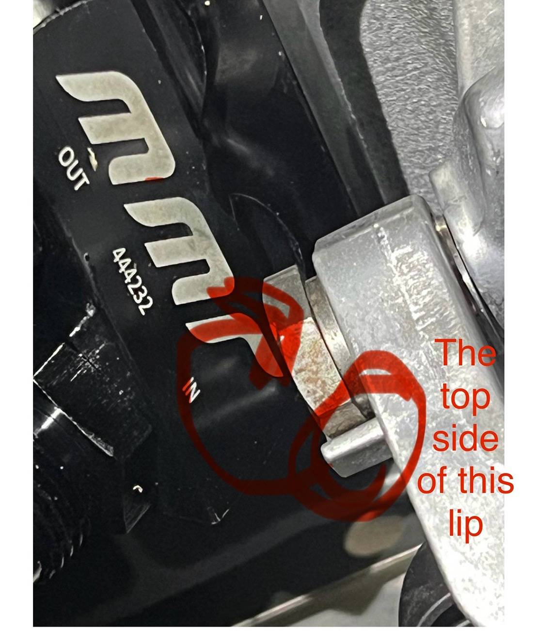

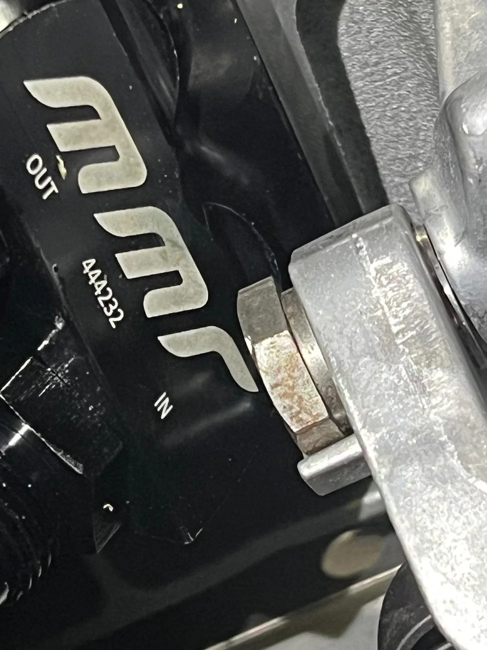

MMR confirmed that this kit should ā€œfit.ā€ It was my experience, however, that modifications were required. The oil sensor is very cramped and I assume the wiring will prematurely wear but only time will tell. In my case, the alternator and new hardware DID NOT fit (out of the box). I used a large file to work some of the alternator casing (protrusion around fixed mounting nut). No big deal but be sure to mind your debris and keep the area protected while you take off material:
S650 Mustang MMR Oil Cooler Install / Thoughts IMG_0583

Where exactly did you file the alternator for clearance?
Does the oil sensor stay plugged in where it stays or does that need to go somewhere else? With the race fitting there isn't any provision to plug a sensor in.
I’m at work for a couple of days but will refresh my memory when I get back to the car. In the meantime, here’s a terrible image of where I needed to file: the lip that surrounds the nut fitting, where it ran into the MMR block.
