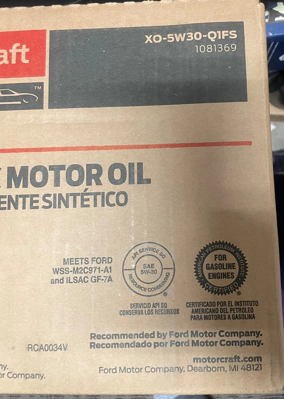

Bought a couple of cases today and am wondering if the oil is compatible with SP. I’m not wondering if it is compatible in the engine, but can leftover SP oil be mixed in with SQ as I have a couple of quarts left over.

The 7G requirement is SP or higher. It's OK to mix Motorcraft 5W-30 SP and SQ together.
In the API article, the tables show that the current category meets or exceeds previous specifications.
https://www.api.org/products-and-se...d-classifications/oil-categories#tab-gasoline
The following Chevron article gives greater detail on SQ.
https://www.chevronlubricants.com/e...nt/understanding-the-new-api-sq-category.html
"Both GF-7 and API SQ oils will be backwards compatible for vehicles using GF-6 and API SP oils."
This is the part I’m questioning. Is it the vehicle or the chemistry that’s compatible. I read it that if a vehicle calls for SP, it can take SQ as well. Not that the two specs can be mixed in large quantities.
My other vehicles take 0w-20. For those applications I’m using PUP. The new SQ has different information on the packaging (no longer states made from natural gas) and has a longer warranty length (not that that means a change in chemistry).
To be safe I’m not going to do it.

Consumers are likely to find the new API SQ oil alongside older API SP on shelves. I asked O'Ryan if consumers may mix the two oil grades. "Yes, but API recommends consumers follow their vehicle manufacturer recommendations," he clarified. "Where ILSAC GF-7A and API SQ are recommended, the oils are designed to be backward compatible with ILSAC GF-6A and API SP or older oils. There is no issue with the two oil types being mixed.

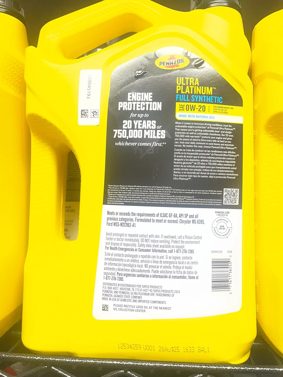

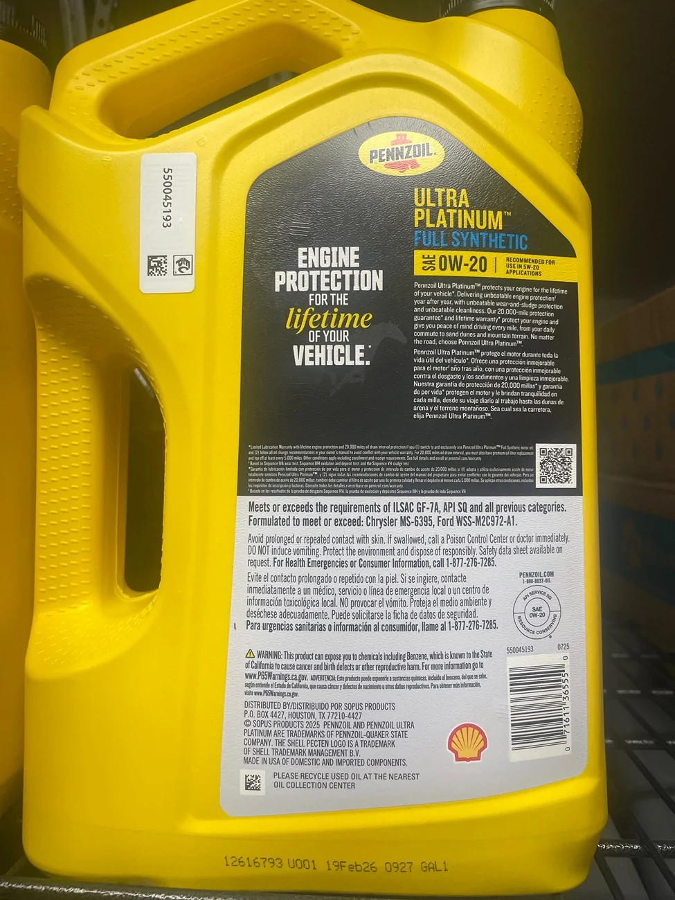

Pennzoil Platinum or Pennzoil Ultra Platinum (PUP), which are different? Assuming PUP, the old "SP" stuff was GTL (made from natural gas), the new "SQ" doesn't state it specifically, so it could be a different animal all together. I use PUP in our 0w-20 vehicles (as Mopar Oil is hard to find). And because the Shell Pearl GTL factory in Qatar was hit in a strike, it may be off line for a while. So after I got home from loading up on PUP, I realized it was SQ and didn't state made from natural gas. Back to marketing over chemistry?
For the Fords, I use their Motorcraft Full (not Semi) Synthetic, which is really hard to get where I live (RockAuto pulled out of AZ). Dealer sells it for $9.32 per quart (only size it comes in). Note semi-syn is available everywhere in 1 and 5 qt containers. With the same level of paranoia as GTL and PUP, I decided to load up on Ford's own brew since the overall lubricant and additive industry is in turmoil (see link below). It too was the new stuff "SQ" vs. "SP". Thus the original post/ask.
New SQ
S650 Mustang New Ford Full Synthetic API SQ Oil is out. IMG_3875
Old SP
S650 Mustang New Ford Full Synthetic API SQ Oil is out. IMG_3874

Just an update. I finally got around to opening my RockAuto shipment. I ordered three cases of Motorcraft 5w30 and I got three cases of the new SQ. 🙂... So if anybody wants Ford's latest brew, that's a great place to get it.
