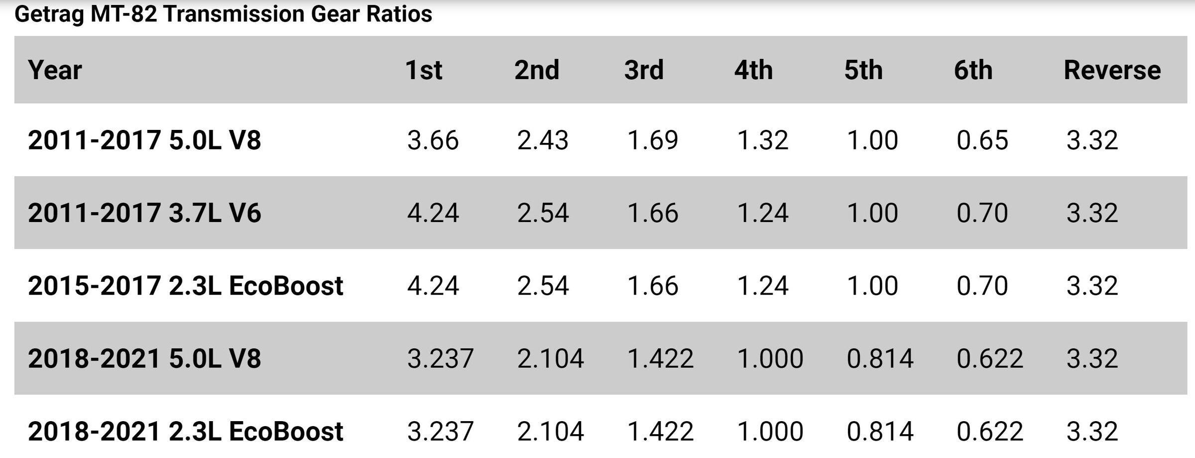

First and second are the gears that you want to have steeper for daily driving and having fun on the street. With a 3.25 first gear and 3.73 rear gears, the GT350 topped out at over 50 mph in first gear, which is terrible. One shift and you're done on the street. No more accelerating through the gears.
The MT-82 in Mustang GTs prior to 2018 have a 3.66 first gear ratio, which is much more fun with 3.73 rear gears on the street.

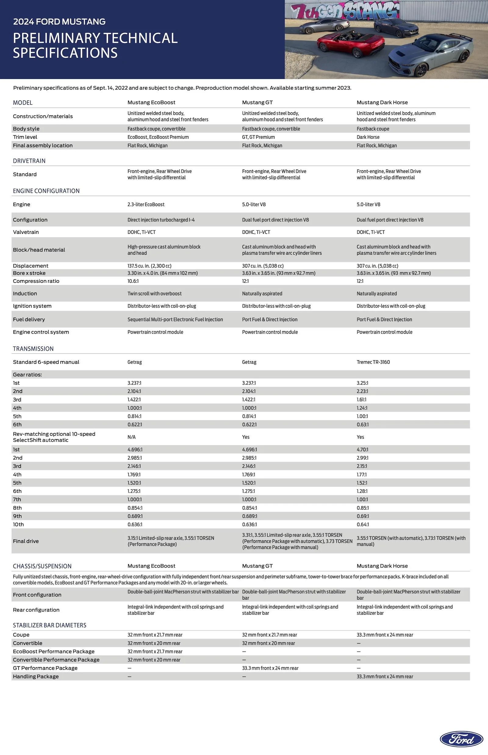

The Tremec appears to be standard in the GT performance and definitely in the Dark Horse. Not sure about the regular GT. A completely revised Getrag may be used in the standard GT. The 10R80 is recalibrated similar to the Mach 1 in the GT performance and Dark Horse. Not sure about the standard GT.
zstanny
Sep 16, 2022
478
643
Huntsville, AL
S650 Mustang They HAVE to ditch the MT-82 this time around, right? 1667855603960
Unless I am missing some fine print, or some other blurb from somewhere, Tremec is specific to dark horse trim only.
