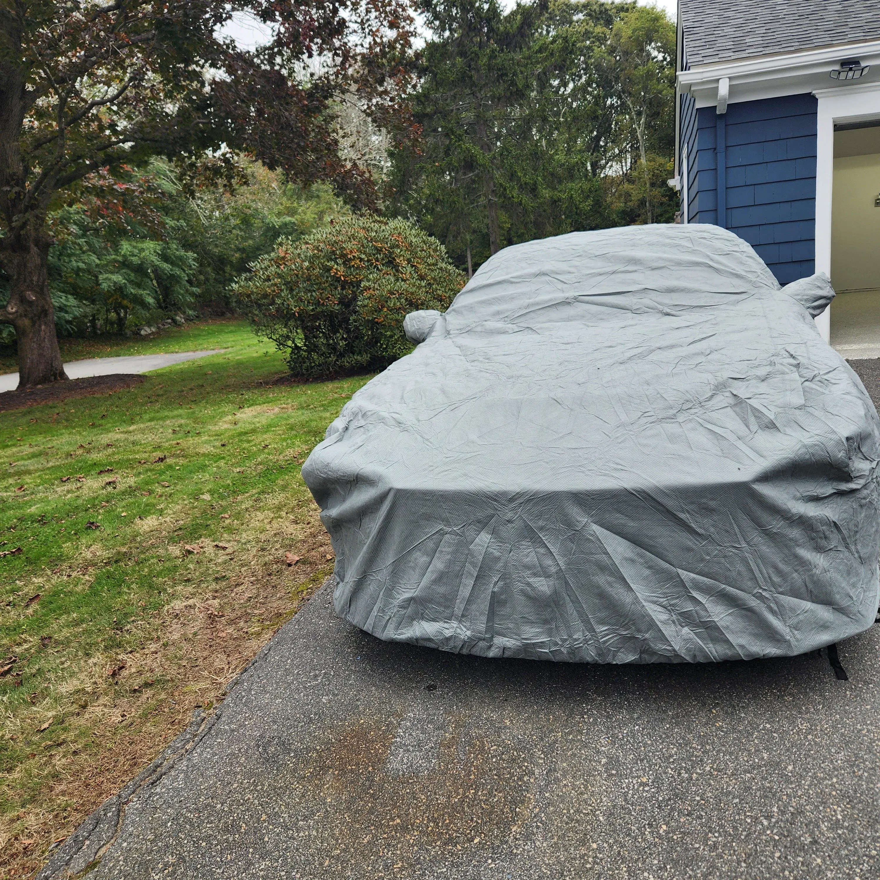

Well, 6 weeks and 1,000 miles later, I find the days getting shorter and cooler. I bought the convertible for top-down cruising, and driving with the top up just isn't as fun for me. Now that I'm getting hit with leaves as I drive, it's time to store her today.
Here's my storage protocol. Please let me know if you think of anything else:
  • Add fuel stabilizer and top off with top-tier gasoline (I added an extra 0.5 gallons after shut-off)
  • Inflate tires to max PSI (I went 1-2 over as the PDI guys never actually lowered it)
  • Turn off vehicle connectivity, Wi-Fi, Bluetooth
  • Turn off remote start, remote window, alarm, vehicle diagnostics, auto-updates, quiet start time
  • Vacuum + clean interior & trunk
  • Wash, wax, dry, remove radio AM/FM antenna
  • Cover
  • Cancel registration/insurance (at my risk, I'll reinstate in February with my vanity plate that the dealer had problems at the RMV with)
I know a battery tender should be on the list, but I'm parking her outside and far from any available outlets and I don't want an extension cord across my driveway, so I'll take the ding for that. I did put a charger on it yesterday to top-off. I looked at a flat-spot eliminator ramp, but for the money they want for it I'll pass and just drive slowly around the block once a month on nicer days. I do have battery chargers and the little portable one I keep in the trunk.
Am I missing anything? Let me know!
Looking forward to May, 2024. I have thoroughly enjoyed my brief time with her so far!
