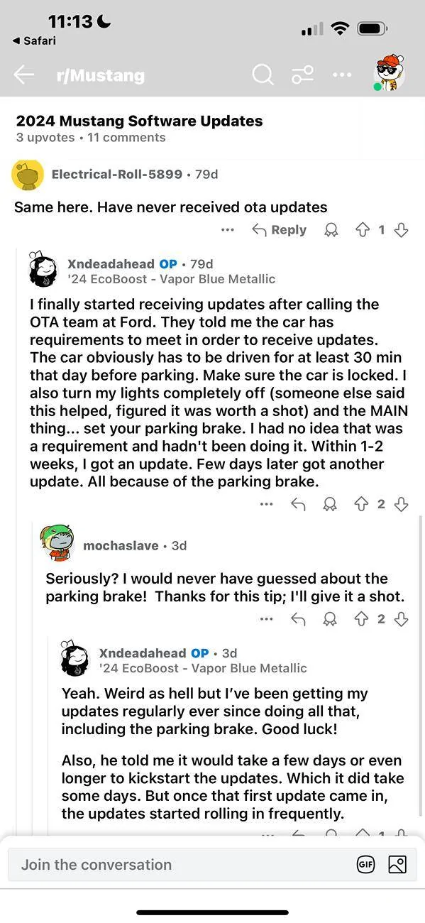

I was also searching this and found some stuff to try on reddit
S650 Mustang Still on 4.0.23151 - Should i visit a dealer? (OTA not.. OTA'ing) IMG_3064

Just sharing what others were saying, I have no updates, and I’ll try what they said next time out… I want the SVT gauge

All my updates were received without having a parking brake set.
Most if not all of mine were the same. Truck and DH. The only exceptions were when I applied manually (FDRS and Mongoose).
