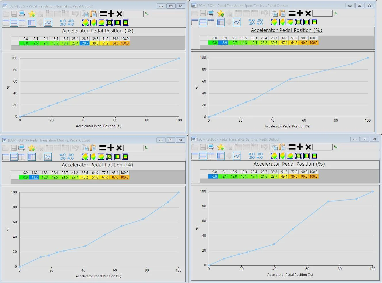

@tastetickles FYI, the stockpedal mapping is not linear. It is a modulated curve of some sort like the rest of the modes. None of them are a 45 degree line across a % of input and % of output.
while not 100% perfectly linear, these plots zxmustang posted in another thread shows normal mode to be linear enough.
Fair enough… I recall this original post. My brain was thinking about another sample I saw. That is pretty linear. More than enough for me to sit back down on the bench. 😂
