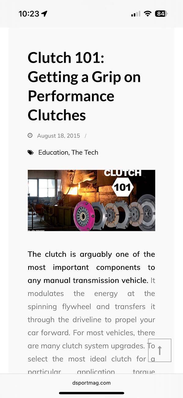

Same could be misconstrued for the brakes. lol those modulate tq too right? Or the on/off key. That modulates tq as well. All or nothing. Or that curb over there also can be used to modulate tq. Or that car in front of you.
S650 Mustang Driving in sport mode--GT with manual---has less off the line in sport mode vs. normal IMG_4005
S650 Mustang Driving in sport mode--GT with manual---has less off the line in sport mode vs. normal IMG_4006

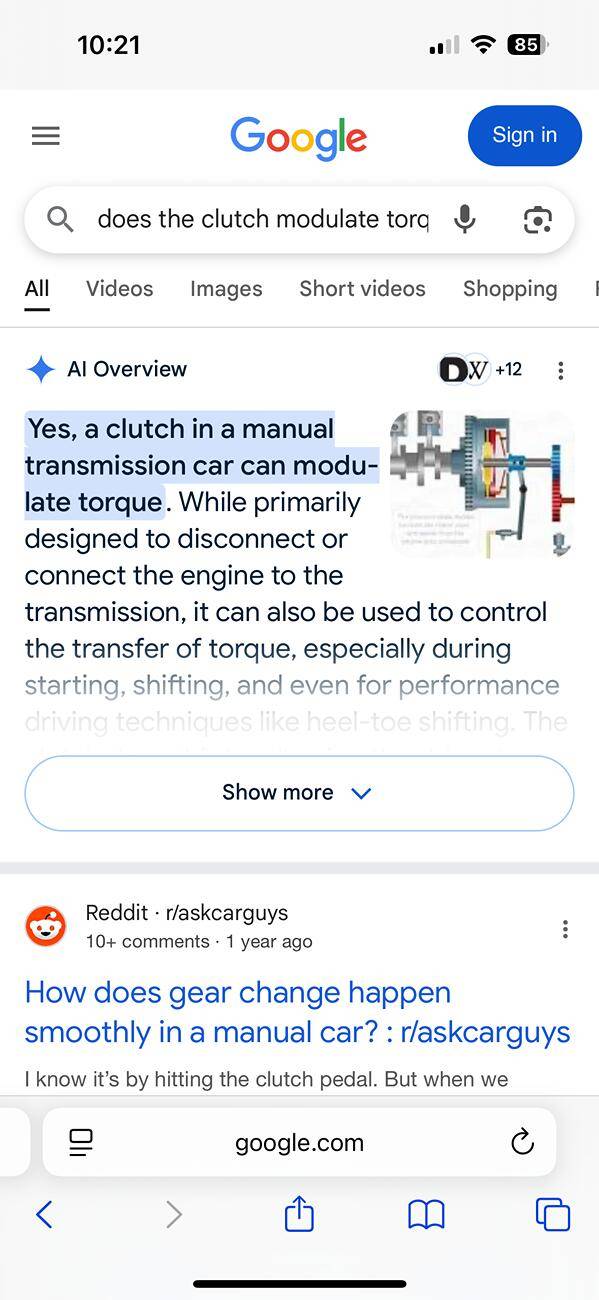

Look at you. You googled. I’m proud.
Meanwhile in reality, your torque modulator pedal assembly will need to be changed every 5k miles or so for routine maintenance. Because after a few uses, it will start to over modulate tq until it modulates out all tq and you end up with a trans full of neutrals.
4,706
2,568

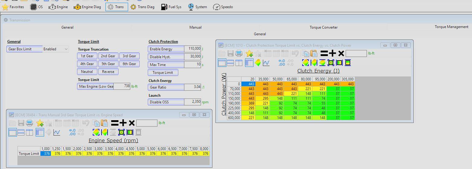

In other news, lets look at some actual (non googled) facts.
This is clutch protection and also tq modulation from the tunefile itself of a manual car. This is how Ford intends to protect you from yourself and "self modulating" tq idiots.
S650 Mustang Driving in sport mode--GT with manual---has less off the line in sport mode vs. normal 1749566022963-pc
4,706
2,568
So you cracked the tune?
