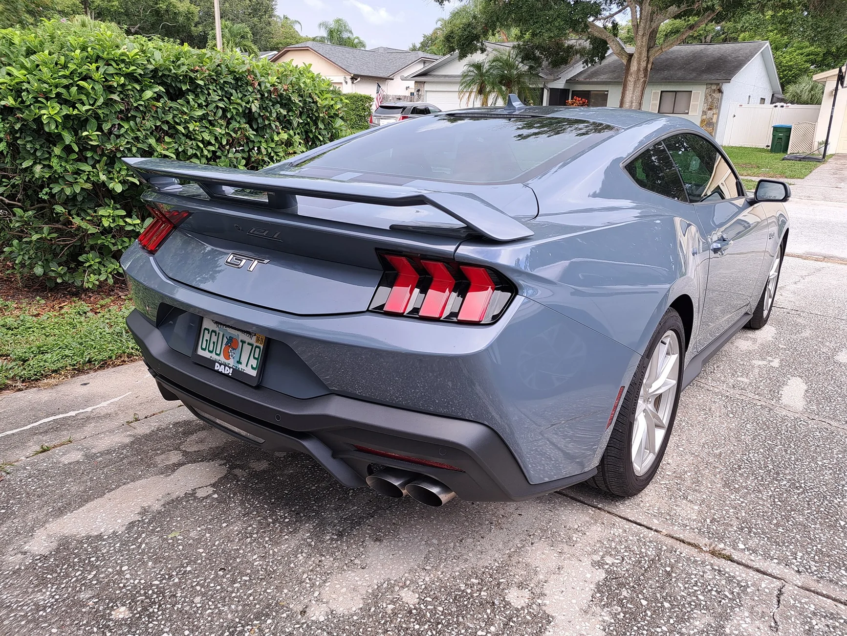

I can confirm that they are the same. I just replaced my blade spoiler (the whole decklid module) with the PP spoiler module. It was a takeoff from another mustang and the installation was straightforward, using all the same hardware and connection points.
I added before and after pictures of my car.
