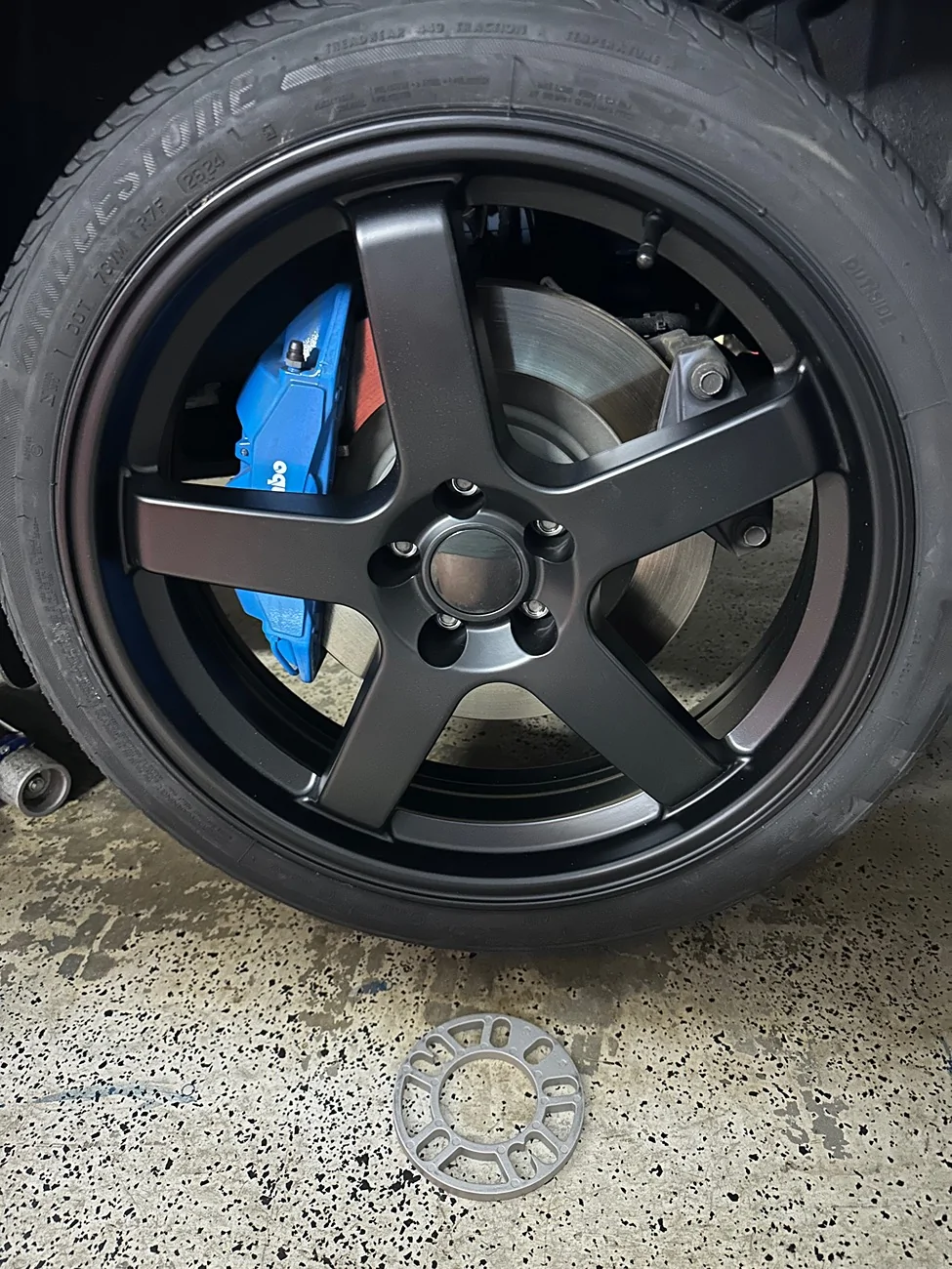

I currently run S650 PP wheels on my S197, so the bolt pattern matches. I think the offset on the spare won't clear the S650 PP brake calipers though.
Automotive Authority spare. I tested it on my DH HP with Brembos. Cleared easily. Also, when you order it, they ask you what you’re putting it on & sell you the correct one that will clear the brakes.
S650 Mustang Spare tire bolt pattern and jack IMG_3674
