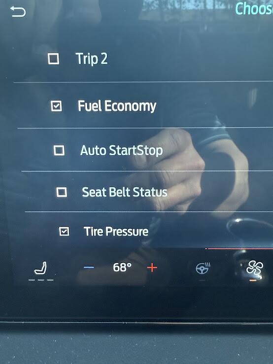

Hello there,
Is there any way to have the "Seat Belt" reminder window/screen not come up every single time you start the car ? It's not a "huge" deal, but I will say clicking on the dumb "ok" button every day is getting old.
First new Mustang I have ever owned... loving it so far.... minus this annoying screen every time I use the car.
Thanks all

Just unselect it from the list in the menu and as long as you fasten your seatbelt, it will go away in one minute... no need to push the button.

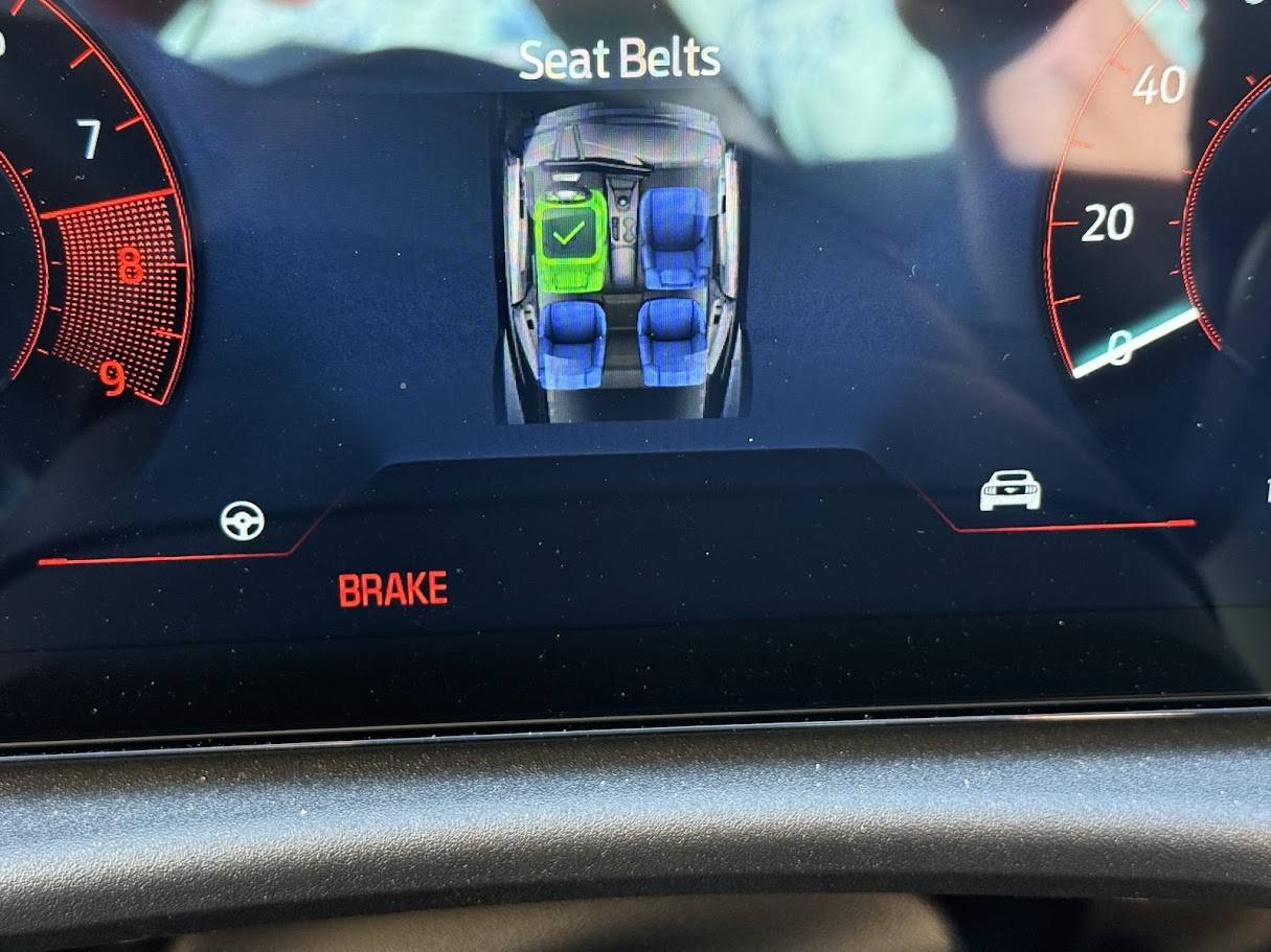

You can deselect the seatbelt status display from the available gauge cluster displays, but that is different from the splash screen. The splash screen overlays the center of the dash cluster, whatever is there for at least 60 seconds or you reconnect the disconnected belt. The splash screen overlay requires forscan to eliminate.
The warning tone may be deleted as well via either FORSCAN or by following a procedure - I think the one I used was the F series procedure - works for A10 cars, but possibly not m/t cars. The procedure in the Mustang manual does not work. This isn’t new, my 17 Rap manual was also wrong, confirmed by my local stealership. I had to use FORSCAN on my Raptor. This cuts the chime, but the dash warning; the flashing read seat and occupant remains. Honestly, that’s all the reminder I need.
Apparently, mine does not operate that way. It's not selected in the list and it doesn't go away on it's own... whether idling or driving, it's always on.
KInd of annoying to say the least....
S650 Mustang Seat Belt Reminder Screen on Startup - 1746761414018-ad
The fact that my seat belt splash screen stays on until I click it off, probably tells me I will have to take it to the dealer to get the annoying splash screen to go away on it's own. Or, just live with it for now.. which is probably what I will do for the time being until the first oil change.
I can be buckled up before or after I start the car.. and the splash screen stays on for at least 30 minutes, which is the longest drive I have had at this point.

I did Forscan first, which removed seat status and chime, but display was still up. I then had to deselect on settings.

Strange, maybe try checking the box for a drive or two, then uncheck it again. worth a shot...
