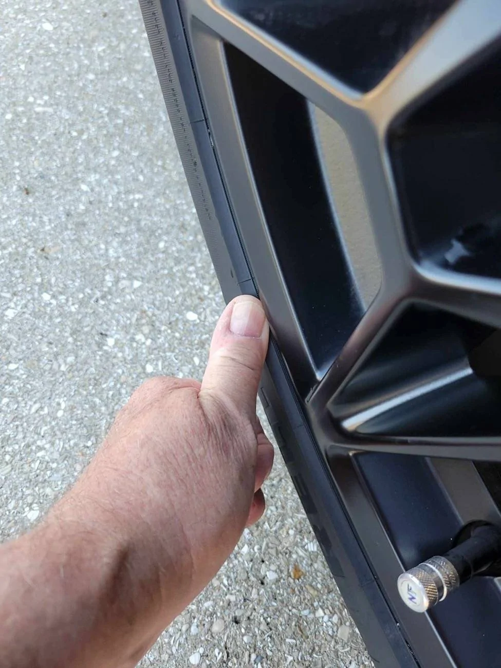

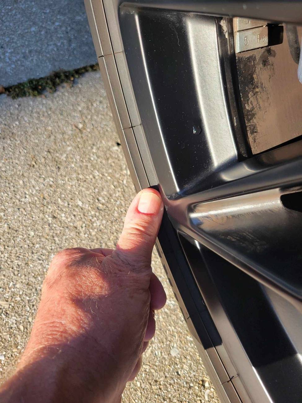

Had to replace my right rear tire Pirelli P zero @ 2500 miles, nail was too close to the side wall. They ordered a tire all the numbers match, but the tire is different. You can see in the photos. First thing I noticed when you got on the gas, the rear end would pull to the right and when you got off the gas, it would shift back to the left ever so slight it didn’t do this before I thought the new tire had to get a few miles on it, but that’s not the case Still having the problem. Going to bring it back to Ford tomorrow. The original tire has more rubber underneath my thumb.

They ordered the wrong tire. Both are the same number. One has the rim protector and one doesn’t they ordered it from
pirelli today I’ll have it by Friday or Monday.
