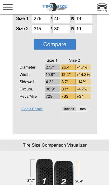

I’m definitely leaning towards buying a set of dark horse HP size wheels/tires for my GT PP. Now that I see the difference in diameter, it probably makes a big difference in performance…
S650 Mustang Dark Horse HP Pirelli Trofeo RS vs. Dark Horse R Michelin Pilot Sport tires. IMG_8129
The smaller height and circumference will give you a bit better acceleration at the expense of speedometer error and higher revs and lower gas mileage over all.
Not to mention that the 315/30R19's have a very limited selection, see my post above.

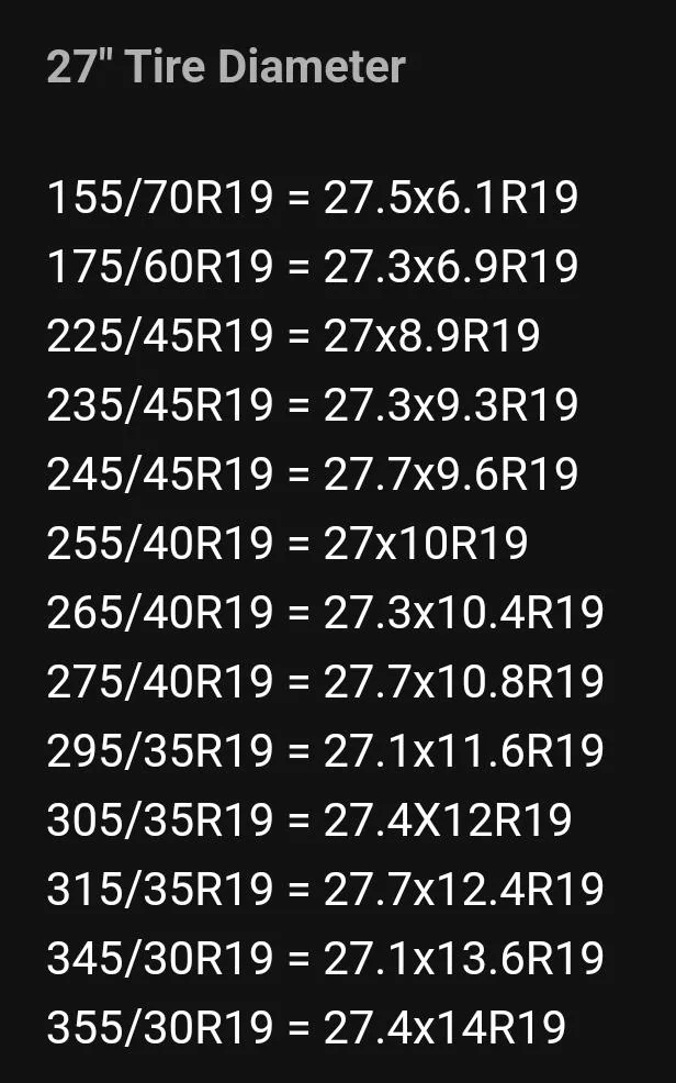

Look at the bottom of that page for tire size options that stay closer to your stock tire height:
S650 Mustang Dark Horse HP Pirelli Trofeo RS vs. Dark Horse R Michelin Pilot Sport tires. 1000025151
