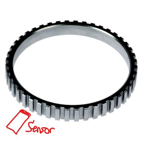

ABS Units pulse pressure to individual wheels based on signals from a reluctor wheel/ring at each hub. This ring also measures wheel speed in many cases, hence why losing a wheel speed sensor often means no ABS, as there's no signal to the unit from that corner of the car.
If the difference at the reluctor ring indicates wheel slip, the ABS unit simply opens and closes the fluid flow to that individual wheel. Thats the overly simplified explanation.
Below is a reluctor ring. Think of each flat representing a 1, while the valley's represent a 0. Based on the speed of these spinning around and getting picked up by a sensor, wheel speed is able to be determined, as well as slip based on the relation to all other wheels. I Believe modern ABS systems also take into consideration a bunch of other shit like gyroscope readings, etc, but all of that is beyond my understanding of how it all gets read by the car and computed.
Hope all that sorta makes sense
