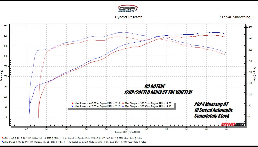

This is on website so most gains on E are mid range which I like

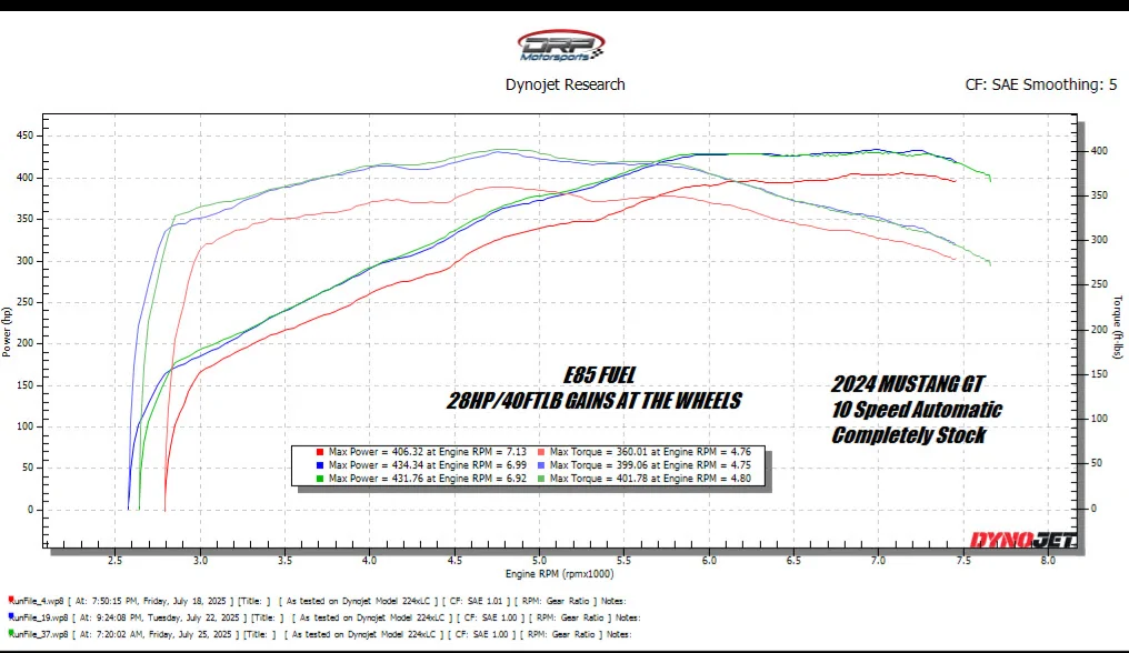

I just pulled the trigger . I'll be tuned by DRP next week.
It's a flex tune right off the bat but I'm going to send him logs with 93 and with E70 just to make sure car is responding properly.
No more speed limiter , if that matters
Redline is still my only dilemma

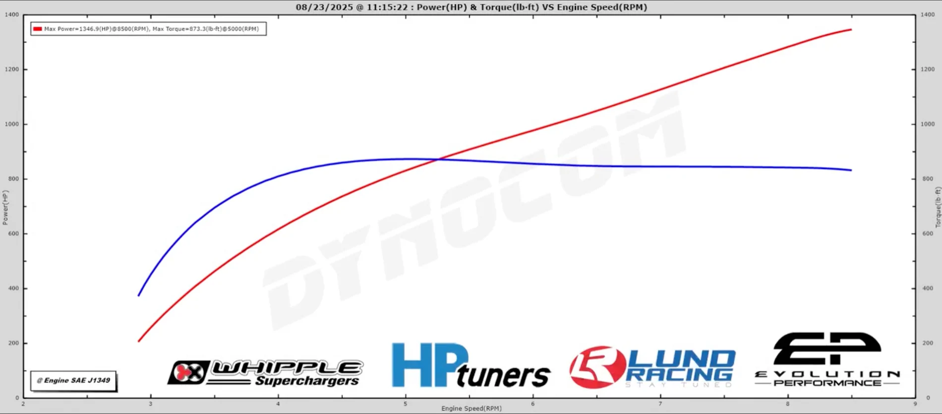

plenty of gen 3 Coyote seem to have gone to 8000 RPM just fine, but also Whipple's stage 2 tune supposedly increases redline to only 7800 RPM. i have no experience tuning or driving tuned vehicles, but i would say don't go over 7800 RPM. Whipple has some smart people who know what they're doing, so it's probably safe to follow in their steps, especially considering there won't be the extra load from a supercharger on the crank as well. as for that tuning company's 8500 RPM recommendation, that sounds rather reckless. i would not trust that whatsoever
2,820
2,808
Specially balanced crank, 'stronger' camshafts, forged rods/pistons...
Evolution spun their stock Dark Horse engine to 8500rpm while making well over 1300hp
You should be just fine.
