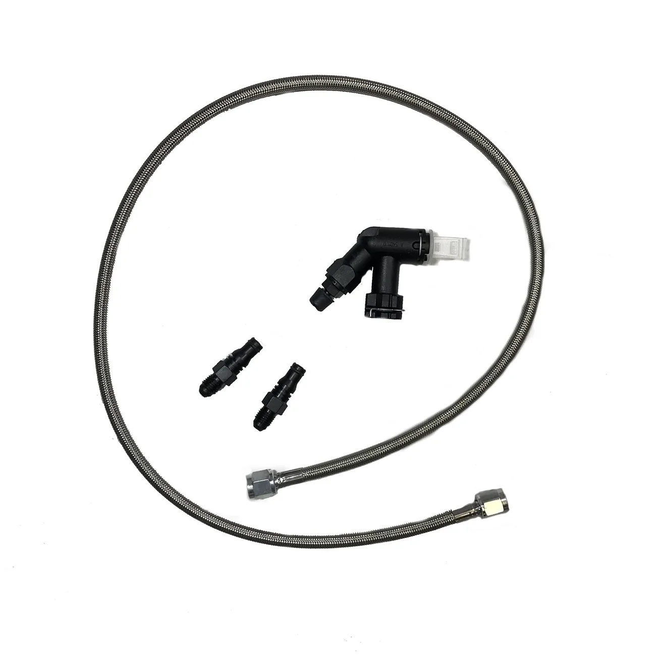

(kinda like the restrictor in the clutch line that slows the clutch engagement)
Is the restrictor located within the the OEM elbow fitting and does the McLeod kit eliminate it? I'm spoiled how well the auto rev-match works on my Mach 1 down-shifts and I haven't noticed any problems with clutch engagement, upshifting or downshifting.
It's rev hang on up-shifts that really bothers me. It's only seems to occur on WOT or near WOT conditions where the ECU is predicting I want to continue WOT upshifts but I'm trying to dial down the throttle and it won't obey my pedal command.
I can feel the restrictor when I let out the clutch fast in neutral. On the DD car, not an issue. I'm sure it's a warranty thing (make sense as does the downshift rev-match function). I'm confused at exactly how it works on WOT upshift when you have to use the clutch. It must rpm restrict the engine. In this case, it's not a throttle blip... it's a decrease in rpms. Seems odd and not sure how it accomplishes that.
