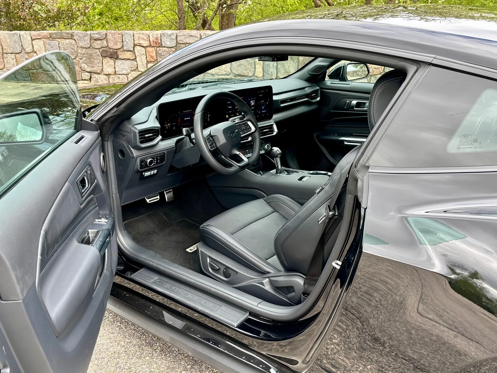

Like many others I was disappointed that Ford did not include lighted sill plates (even as an option) for my 2026 GT (I had them on my 2024 GT). I tried to order them through my local dealer and online. No joy. A pair were for sale on eBay but I was not interested. I called a big supplier and they conducted a search. They said the "language" they received was that the item was called "completely unavailable" which they translated as not in production by anyone, anywhere and not likely to be. While I give my local Ford dealer a few more weeks to see if they can locate some, which I doubt, I managed to get a pair of Ford Performance sill plates from CJ Pony parts. I had watched a video online of how to R&R them which I now know to be crap illustration advice. In the video I thought I saw the area where the clips went as being bent upwards after the author removed them. He did not comment on this in his video. Stupidly, I followed his instructions on the first sill plate. Removing the two clips holding the crummy oem plates is nowhere as easy as the video's author indicated. My attempt on the first sill plate was not good. The plastic oem plate came off but the clips broke away and remained in the slots on the rocker panel. I removed them with pliers which bent the slots upwards and scratched the edges of the slots (not visible) but IMO a future rust concern so I touched-up those areas with paint. The two way tape came off easily and I used a rubber mallet and piece of pine to flatten out the slots. Installation of the Ford Perfrormance sill plate was easy and looks a lot better IMO than the oem. For the second sill plate I managed to push in the two flanges on each clip that lock the clip into the slot to remove them from the slots in the rocker panels. No where near as easy as shown on videos but with patience quite doable. I will try to add a picture later to show the finished product but if you "google" Mustang Ford Performance sill plates you will see exactly what I have. BTW they are on sale right now at CJ Pony Parts for $169.00 a 24% discount. Thyey arrived, very well packaged, in two days. I am 100% happy with them.

@MAT1955 : Thanks for posting this for us.
Did you make the panels light up, or just replace them for better general appearance and not bother wiring them up?
I, too, am a little disappointed by the plain entry sills -- especially when compared to the look of prior model years.
Thanks!
