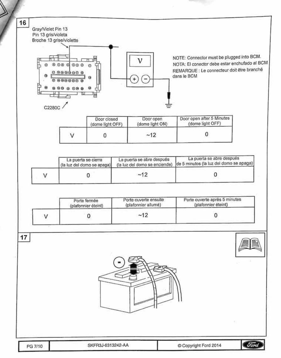

Okay, got them installed. They light up fine with a 9V battery. However, I’m not sure I’m tapping into the correct wire.
instructions say it’s a grey with violet stripe.
S650 Mustang Lighted Sill Plate Help IMG_9983
as usual with car wiring, colors are kinda odd. The only grey with what I think is violet is a much thinner wire than the others. Does that sound right? Afraid it’s going to cut the wire in half if I use a wire tap.
