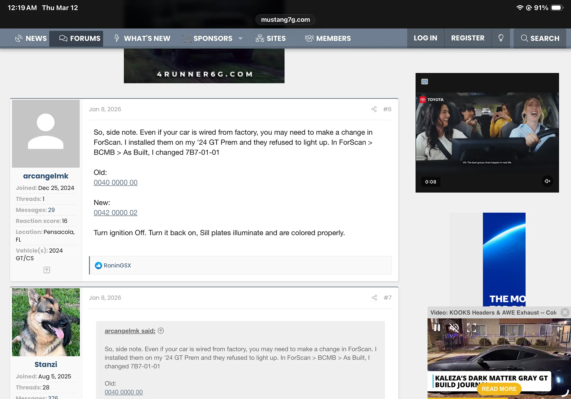

Everyone says interior sill plate on and off toggle is in bcm-b, they removed it and now im stuck scratching my head plz help! Heres orgi
S650 Mustang Help!!!! Sill plate retrofit (programming needed) IMG_0071
