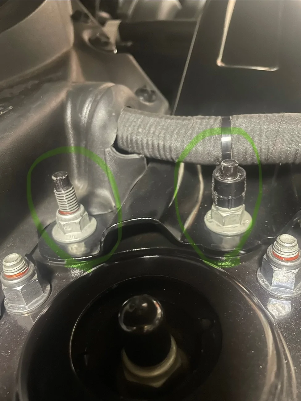

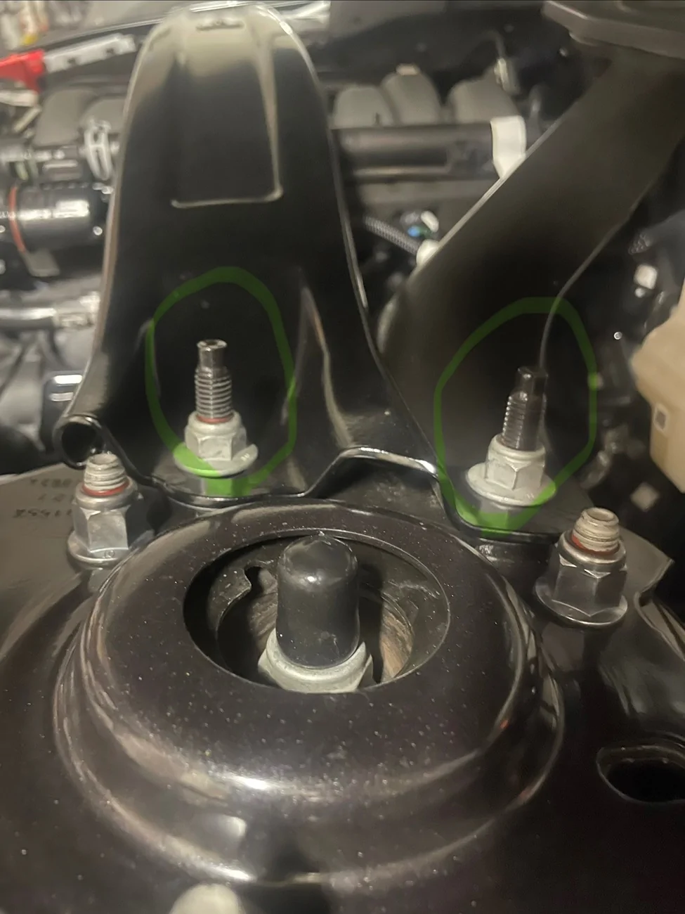

Just a seal is not an issue at compared to other/deeper oil leak issues that S650 V8's have experienced, such as bad valve guides or bad rings/cylinder surface. The bigger issue is taking anything off and putting it back on incorrectly. Sorry but dealer fixes have been spotty. The thing you don't know is how experienced the tech is on that platform or if the tech was having a good day or bad day (sometimes through no fault of their own, dealerships can be a toxic environment). We've all had good experiences and bad experiences. At least it should still be under warranty if that helps. If it were me, I'd check out everything above that fix, for starters, if the car has a strut brace and as you stated it is a "pp" so it should have, those are notorious for being reinstalled incorrectly as it needs new nuts, which if over-torqued can lead to snapped off welded in stud, so check for painted bolts (original welded stud) vs. a shiny bolt (indicates stud was compromised, drilled out and replaced with a bolt) on all four points of contact. It doesn't sound like the spark plug was removed, but if it was and reinstalled incorrectly, such as also being over torqued, which is bad since it's a steel screw going in to an aluminum head which can be easily stripped.

Post a pic if you’re not sure.
It’s these studs (highlighted) painted body color on top of the strut tower. Note the forward most on the right/passenger side has a wire strap covering most of the stud, but there should still be enough showing.

Yep i double checked, they are all body color, and dont look striped at all. So now we have cars in the same color!
