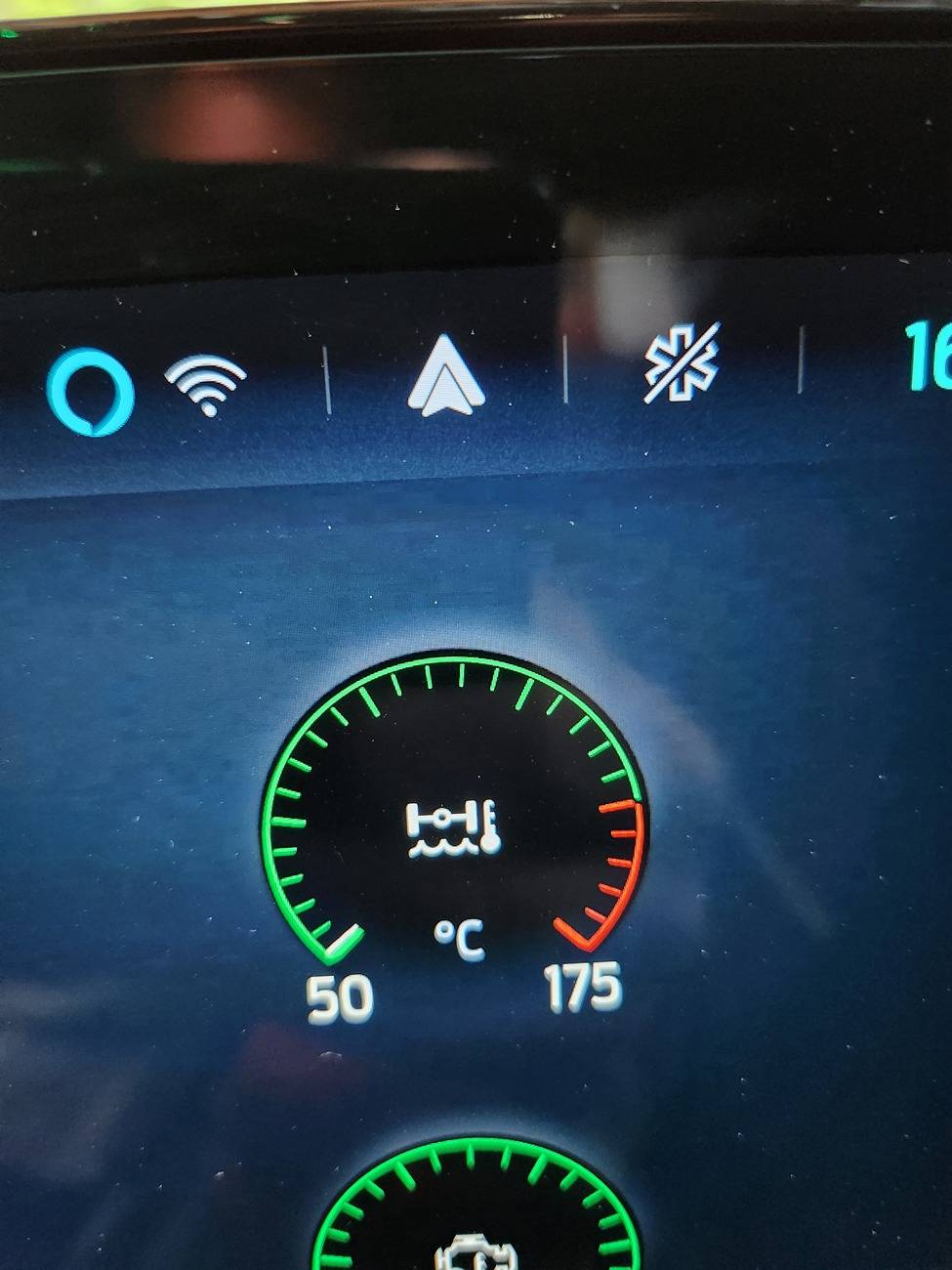

So I just noticed that I have lost axle temperature data! As per the pics it's happening in 3 places.
1. Auxiliary gauges on the infotainment screen

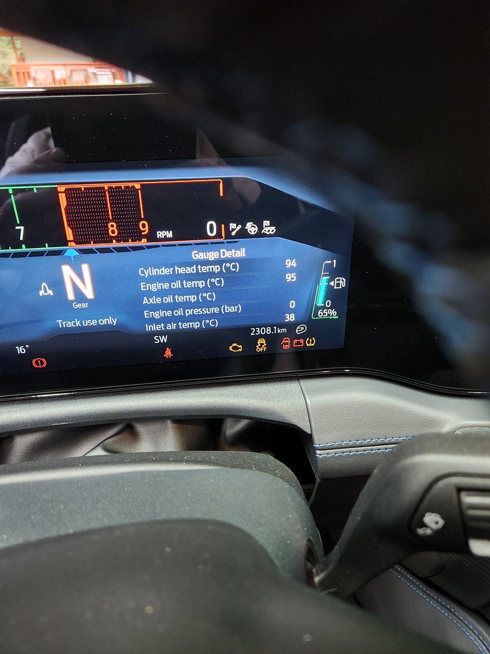

2. Gauge detail on the DIC

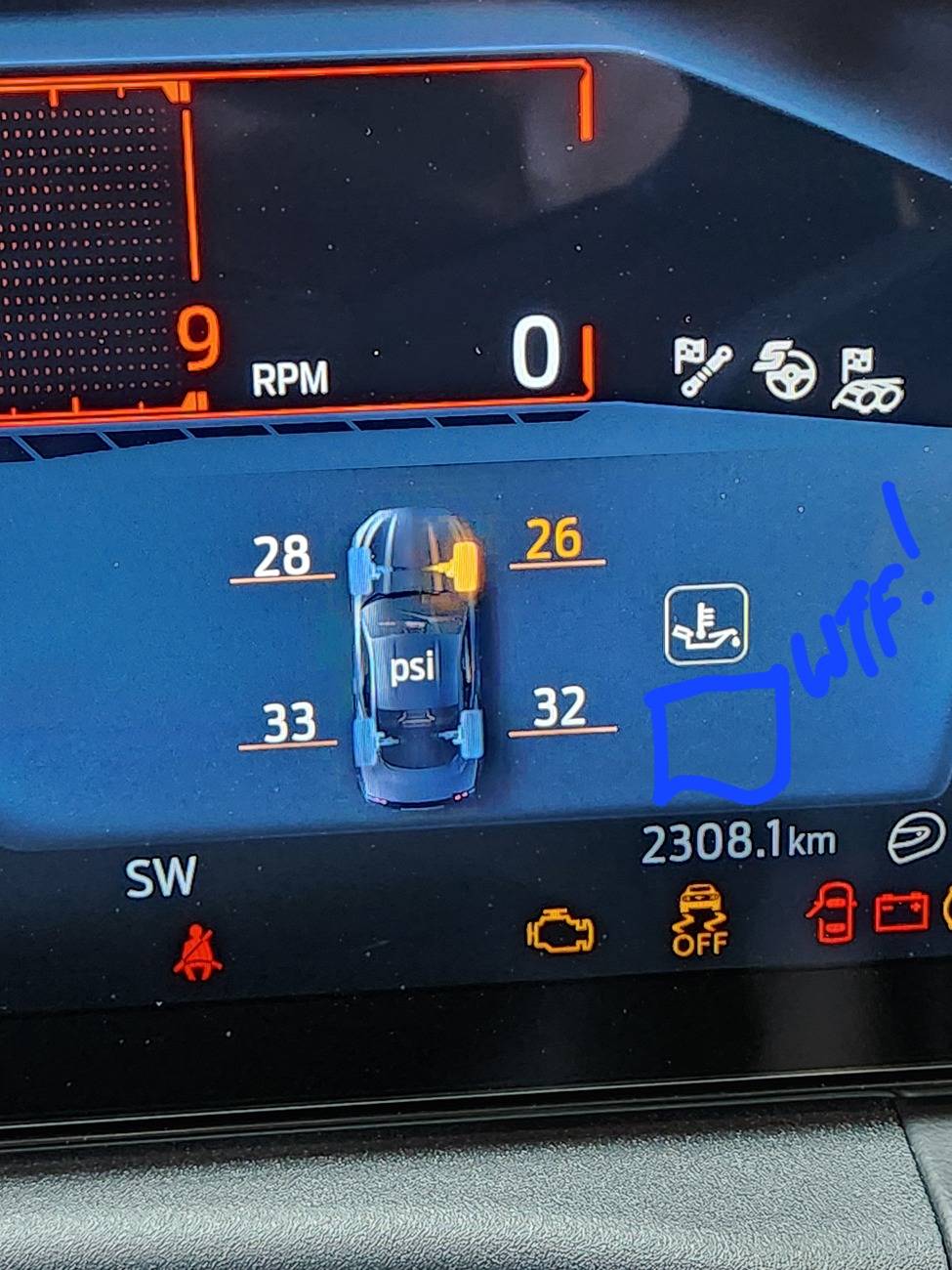

3. There used to be a little monitor icon below the oil temp when in track mode. That has disappeared.
So I can't help but wonder if these stopped working after I installed the Whipple calibration. I know they worked originally, because I thought they were way cool.

whipple probably sent you a non DH tune confirm that with them sure you can reenable it with forscan but might as well get the right tune as well as you speed limit will be lower with a non DH tune
