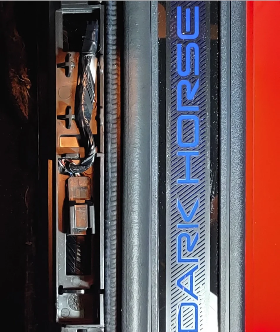

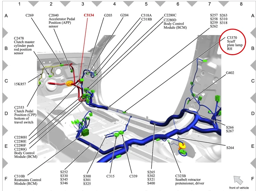

For those attempting this mod (that have a late production mustang) and don't have ambient lighting as an option, my post on this *does* have the wiring diagram for Zone 1 ambient lighting, which is what the door sill plates will use. I would not attempt to use Zone 3 (footwell/door handle lights) as it isn't meant to run the door sills.

@Whoznex ..... great post. Question: when you find code line 726-37-02 do you click on restore or write to activate the code? BTW I ordered two, was called into the dealer to pick them up. Paid for them while a parts guy went to the back to get them. He came back without them and said he guessed they hadn't shipped. Ha Ha - I think I know what happened to them. Anyway here's a tip from me. When I wanted to install a kill switch on my 2024 GT I called Ford Client Service they heard me out, agreed (I was shocked) gave me a file number and said I had to have a Ford dealer contact them before the install to confirm and it WOULD be covered by warranty. So, obviously, this time I will call and using your kindly provided directions see if Ford will cover the installation under warranty if a Ford dealer does the install and programming. If so I'll get a case number for any future potential warranty hassles. thanks again for posting.
