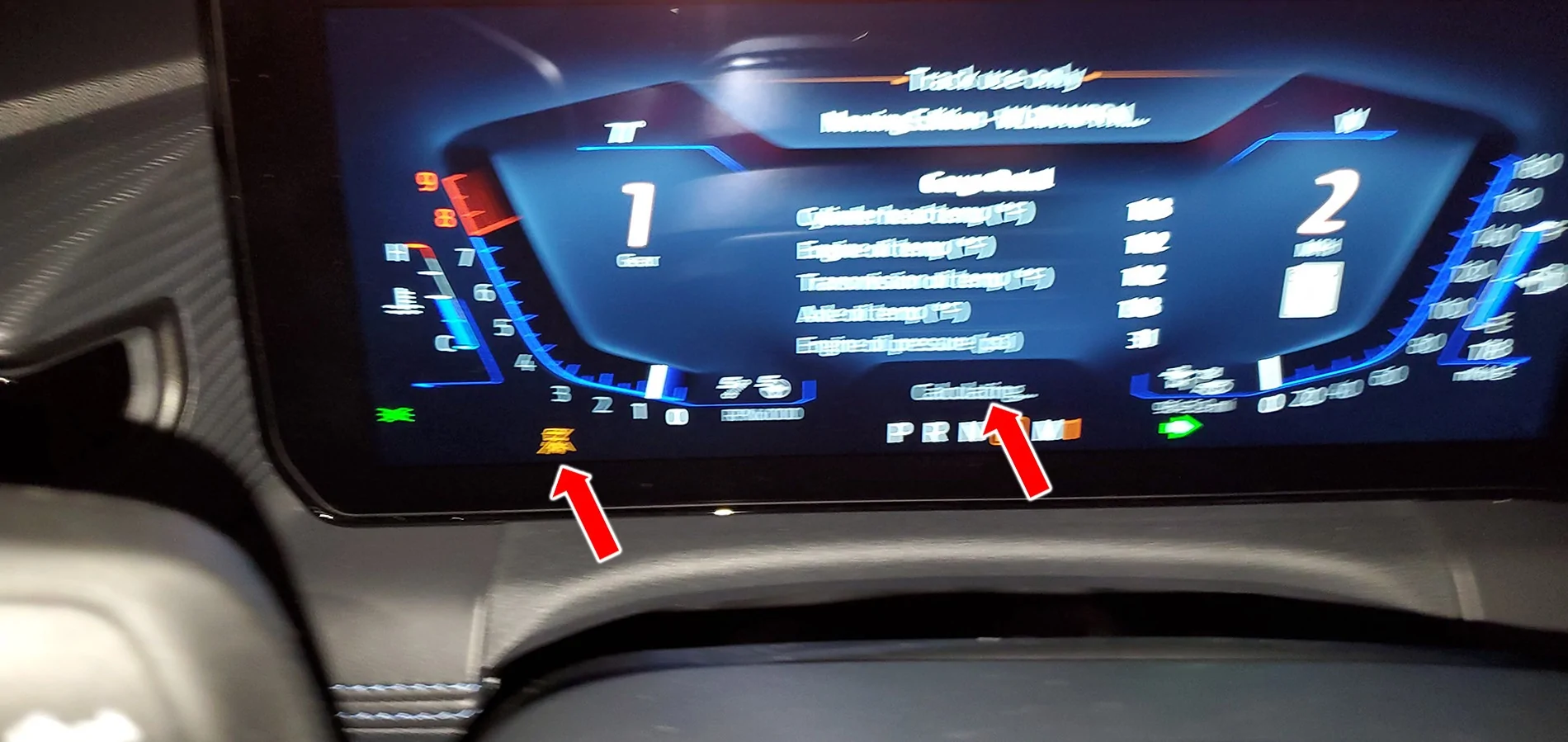

Within the last few days I am having two weird issues.
1. The Pre-Collision Alert is not working at startup. Gives me an error message and is X'ed out on the dashboard.
2. I use Google Maps through my Android phone and it works fine on the infotainment screen but just says "Calculating" on the main dashboard.
Before taking it to the dealership and dealing with them, anybody have something similar happen?
S650 Mustang PCA and Android Google Maps issue dashboard issues

My pre-collision assist is out along with my adaptive & normal cruise control. It has been attributed to 20” wheels & larger diameter tires. Resolved when I went back to stock setup. Put 20’s back on in the Fall with different fronts closer to stock diameter. Problem back. Haven’t had it diagnosed yet due to salted roads.
Another member had his go out a few weeks ago.
another member posted a few months ago about same problem that turned out to be some type of of wheel sensor.
Make sure the sending/receiving unit in the front grill is clear. If so, sounds like time for a dealership visit.

Did you try changing the tire size with forscan? Maybe it would all be good if the car was configured for the tire size.
I have not, yet. I’ve been thinking about it but just too intimidated about changing factory settings. I would need some help from someone with more tech experience than me.
Dealer said the Whipple software lets you change tire size too. Thinking about going that route.
