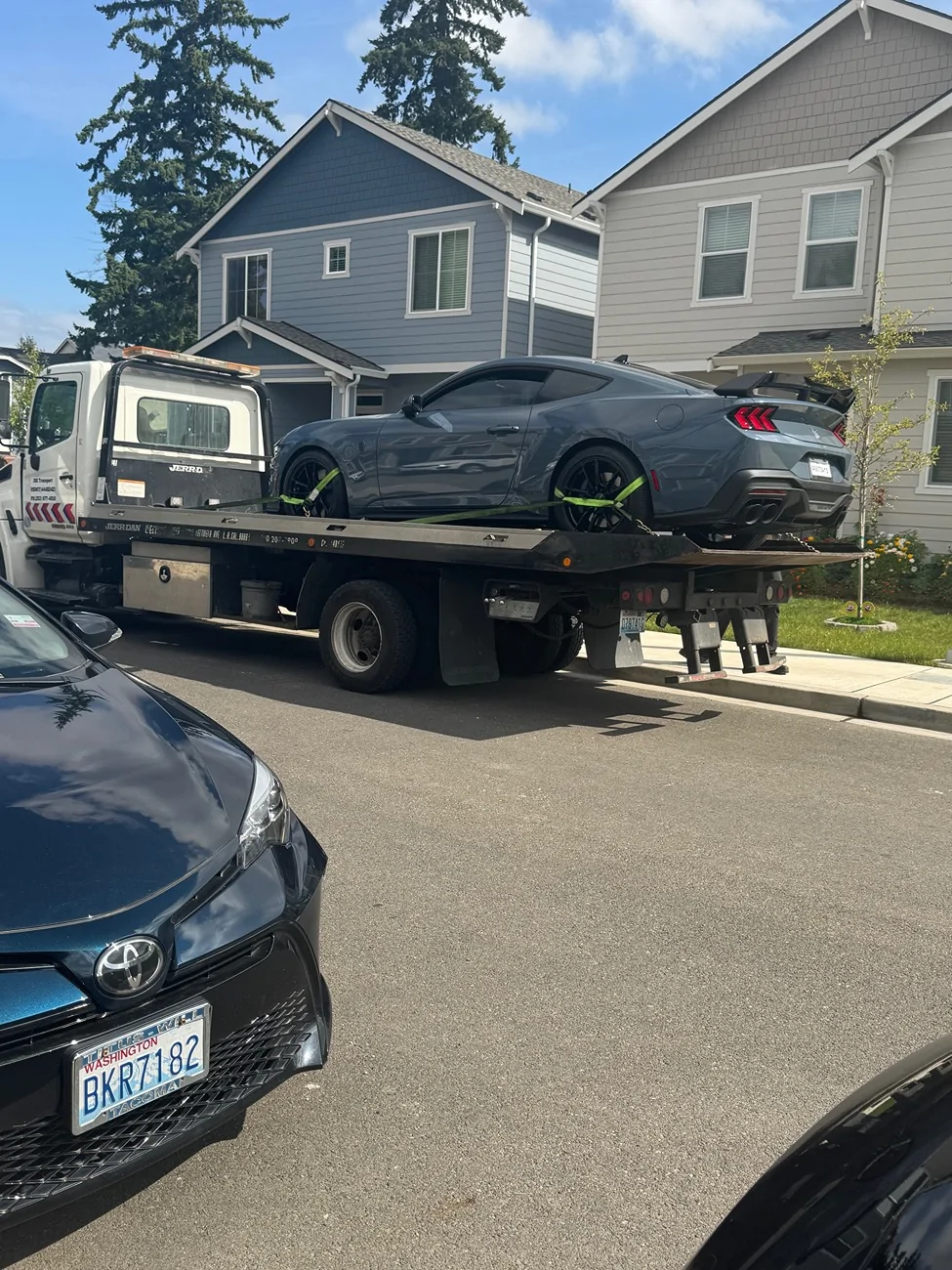

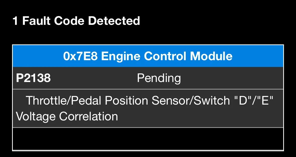

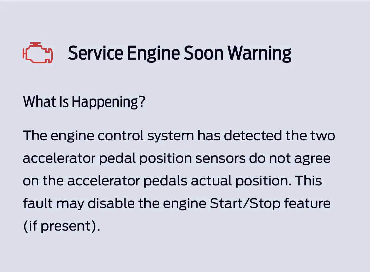

2025 Dark Horse with TREMEC had SES light come on and no throttle response when shifting into 4th to go over 35mph. Pulled over and read the codes and got P2138. Seemed intermittent and was fine for a few days but towed her into the dealership today. Curious if anyone else has had this happen? I am having a D1 crash out my poor baby 😭

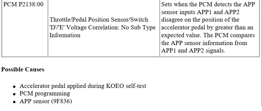

Nothing serious based on the code, wouldn't worry too much about it.
At worst, probably just needs a new sensor and recalibration

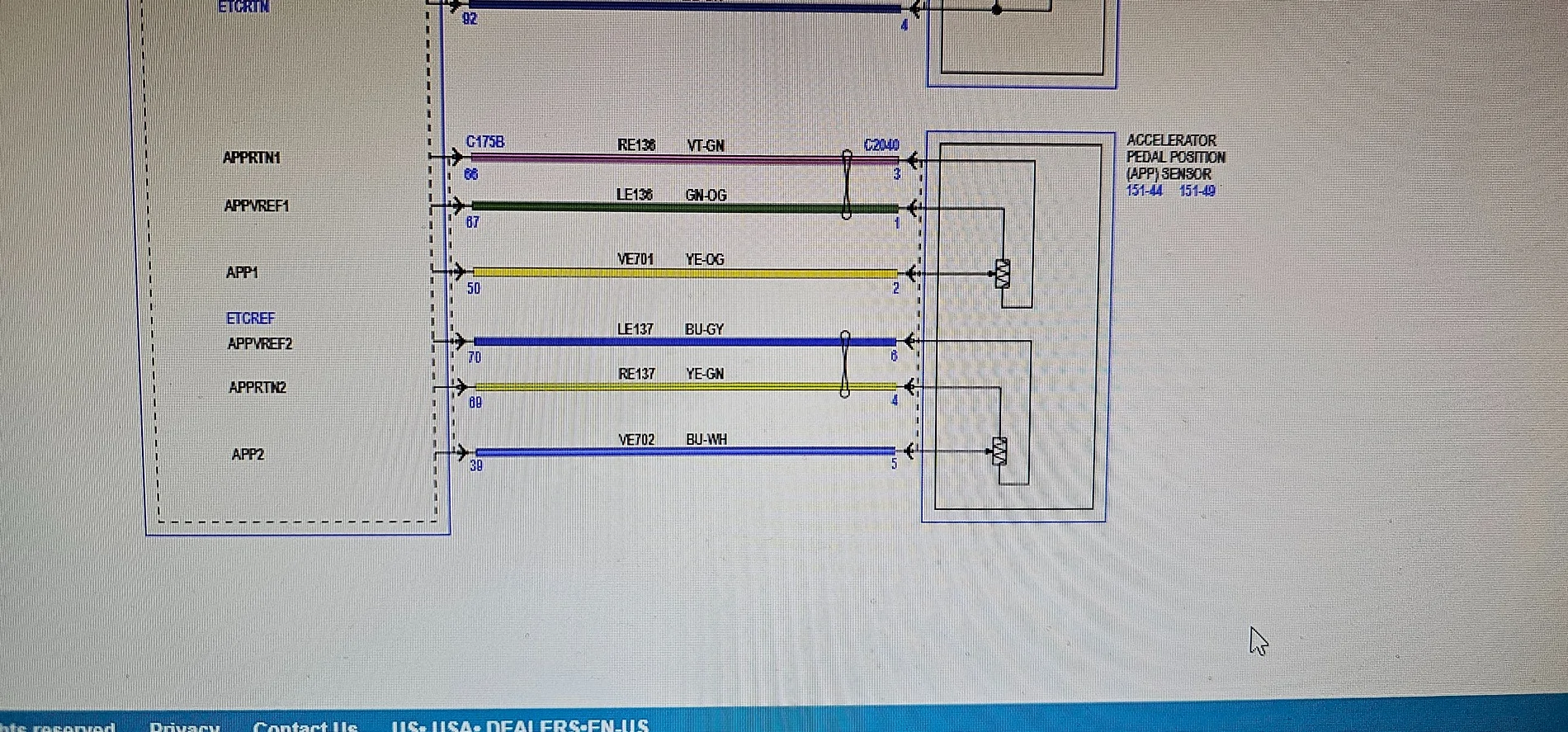

effn dealership mechanics, they should be in there with a scope and back probing wires and doing continuity tests, wiggling the crap out of the harness, etc.
Instead they are just firing the parts cannon at it.
Signal at the PCM for both sensor wires, signals at the pedal, continuity in the harness.
signal out of the PCM that is created by the 2 sensors in the gas pedal needs to be looked at too.

Yeah I have access to Ford PTS at work, I brought up the wiring, and how to troubleshoot it. This is part of the reason I dont understand why they are doing what their doing.
