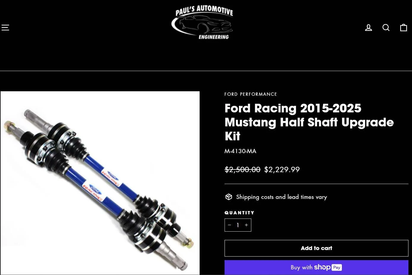

Consider these from Paul's Automotive Engineering, Cincinnati, OH.
On my list of todo mods are half shafts. After a lot of research (as these shown were on my list) I decided to go with G-Force Outlaw half shafts instead. I don't remember exactly why I made that decision, but I even had a tread on this forum (no replies) asking info. Somewhere I saw these Ford ones are built by G-Force.

Can't speak to whether replacing one vs replacing 2 causes imbalance (because I had both replaced) but can definitely speak to the Dark Horse. If you are whippled, I recommend 100% replacing the half shafts if you are going to drag race with a drag pack. If not racing with the car, probably won't be an issue....a good sticky track will hold the tires enough on launch or gear changes to break the drivers side shaft for sure. Speaking from experience on that!

Originally they thought DH had 350 half shafts but I don’t think they do, I think they’re same as GT with the taper on the driver side.
There is no imbalance although the 350 hs is about 6lbs heavier , material wise… the passenger shafts are identical.
I saw Ford Performance 1/2s for sale, but they were under $500. The one piece were under $1000. Last night I read a guy who worked building Fords saying the reason of 1/2 shafts are alignment and harmonics etc. one piece carbon fiber are safest, but it's not like I'll be keeping a spare in the garage. Plus I hear they're made to order. So they must have a shelf life. The aluminum one piece can be extremely dangerous during a malfunction.
