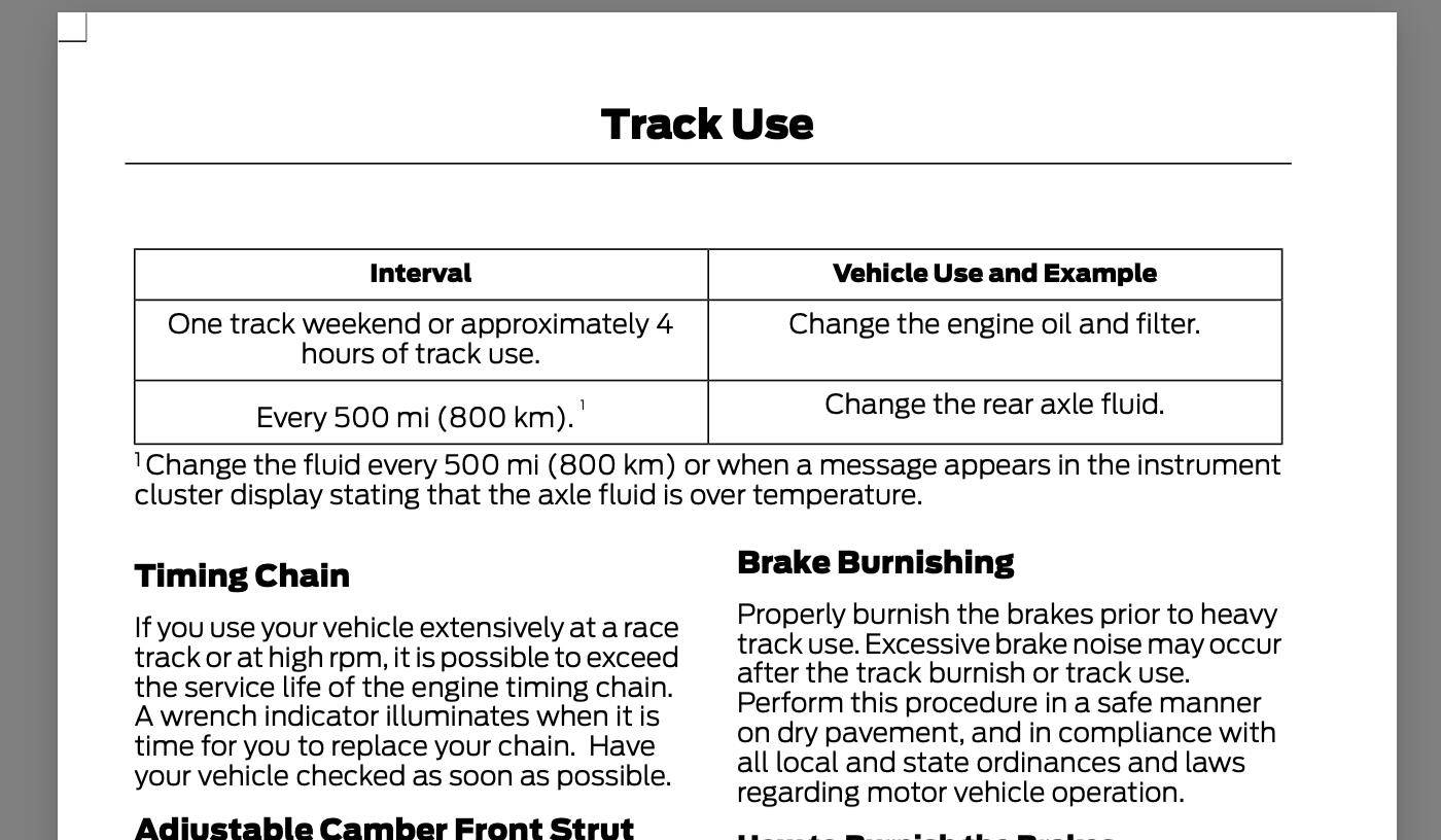

The car still doesn't really know the condition of the oil. It's just guessing. The same use with one oil isn't going to be in the same condition as the exact same use with another oil.
I know that - they suggest track use intervals in the manual. I'd rather go by that, than the OLM is what I'm saying. Or at least see how things line up. And are you doing road course, autocross, drag racing? Three very different things. Hour of autox isn't anything like an hour of drag racing.
I don't blindly follow that extended intervals they suggest for regular driving either.

The car isn't guessing if you just reset the oil life a then took it to the track. It knows the starting point and driving conditions it was under thereafter. It's following a very accurate algorithm based on the information it's recording. You can believe it or not, but it's obviously more accurate than people give it credit for. The OP asked why his oil life went to 0 so quickly, and that is why. I had a similar experience with my oil life dropping significantly after track use.
But did he do an oil analysis (or whatever people want to use) to truly judge the condition of the oil?
The car doesn't know what oil is in it and what the actual condition of it is. It's just making an educated guess based on what some engineers put in the tables for the calculation.
Is the oil still good? Is it completely smoked? What if you use a cheap 5-30? What if you use Redline or Amsoil? It's going to calculate the same no matter what oil you use, because it doesn't actually look at the oil
