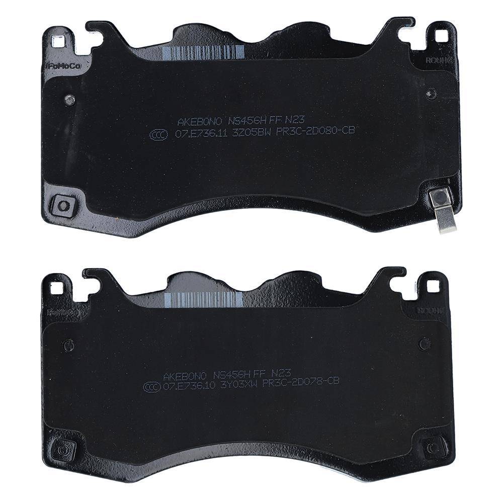

Aren't they AKEBONO?
Uh, oh.
We have a conflict.
Normally I look on RockAuto.com to determine OEM parts, but neither of these two is listed as the equipment for a Dark Horse handling package, and I cannot figure out what is the OEM pad. Usually it is pretty easy to figure out on RockAuto.
