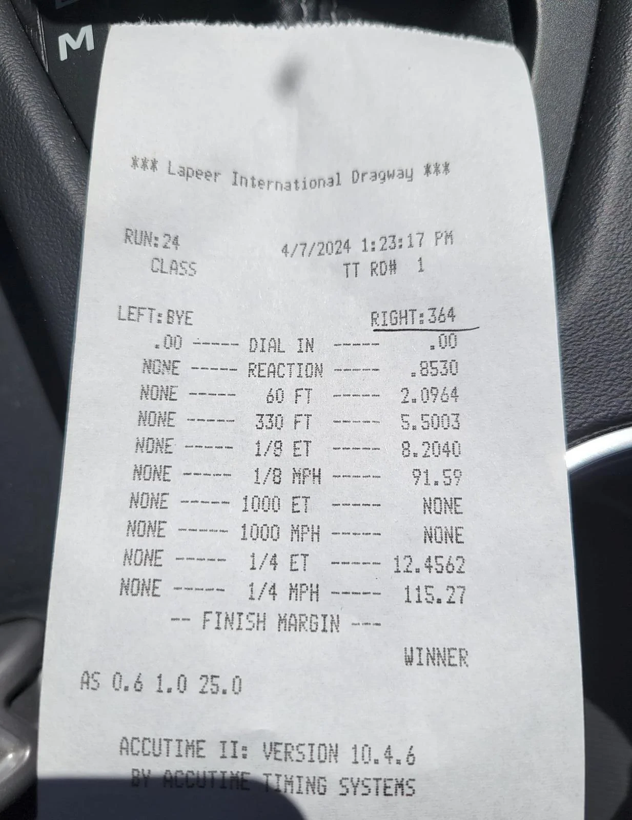

I went to the drag strip yesterday to get some time with my new Mustang. Unfortunately after arriving I discovered that the drag radials I brought with me were not 18" like I thought, but were 17" - and no way to get that on a car with the performance package rear Brembo brakes.
So ran with the street tires - PIrelli Pzero summer tires.
Like someone said, do not just hammer it from the light. All I got with that was a ton of wheel hop and a terrible 60' time.
Since it was a TNT with not many people there I didn't worry about my reaction time - I wanted to figure out what works first and focused on how I was staging with my car (automatic, 3.55 torsen rear end, performance package, magneride, and active exhaust). I set it to drag mode. I found that bringing the rpm up to around 1800 and letting go of the brake and rolling into the throttle gave me the best launch and time.
Now to sell my old Race Star Dark Star 17 x 9.5 wheels and get some 19" wheels and the Nitto 555R in 275 -40 x 19 size (so it matches the stock set up) and work on the 60'.
S650 Mustang New to The Dragstrip 4-7-2024 pass
