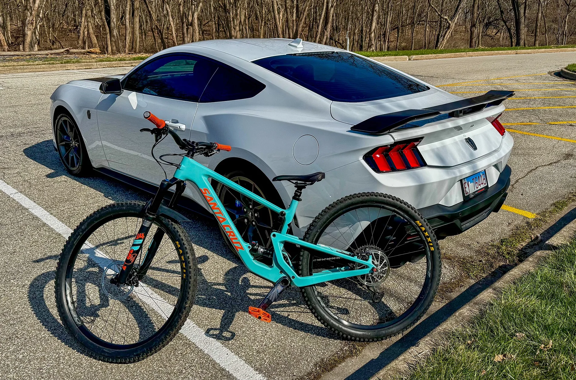

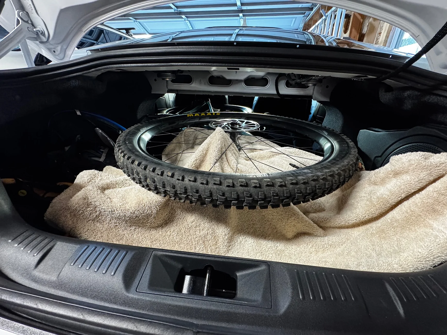

I’ve been doing it for 10 years .
I actually brought my bike to a dealership to test it out before ordering my 15gt.
I just putt the back seats down , put a thick towel over my bumper/trunk to protect paint, then I remove front tire and slide her in. Now that I have a more serious , larger mountain bike, I remove pedals to make it easier.
now I can drive an hour to the trail and enjoy both my passions!
Can’t do that with a Camaro! Lol
Thanks.
I need to try that out.
