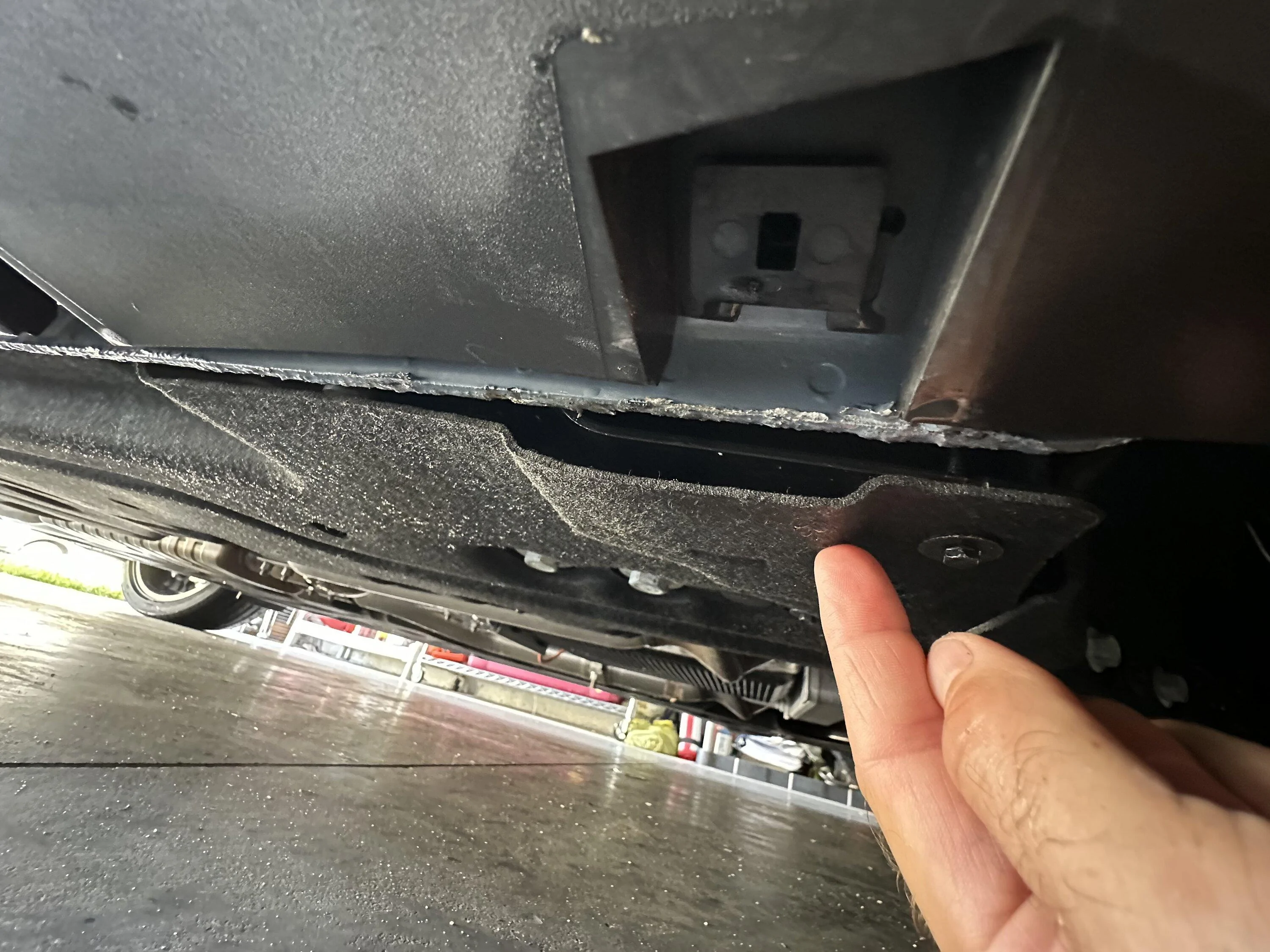

Ok, I looked at the manual and it’s not clear to me where I should lift/jack the car up. I am needing to remove the wheels so I can ceramic coat them and I want to use my floor jack. There doesn’t seem to be a place big enough that I can use for my floor Jack for the front of the car. The rear I’ll probably just use the rear differential. Any help or suggestions would be helpful. Where my finger is pointing seems to be a solid place under the carpet matting. Would this be good to use? Thank you.

There's a thread about it somewhere in here, you finger is on the right spot. Be aware the hard point is the pinch weld not the flat.
Ok, so I’d place the floor jack on the pinch weld to lift, not the flat metal piece my finger is pointing too?

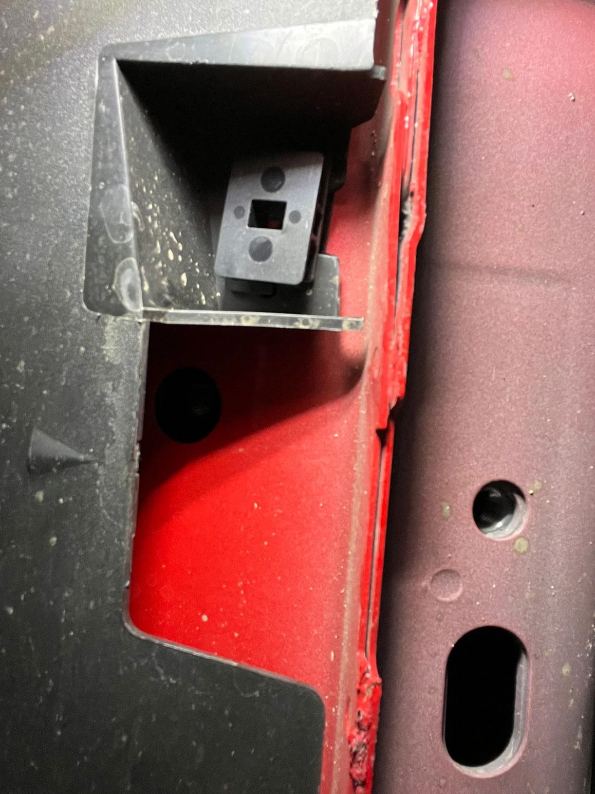

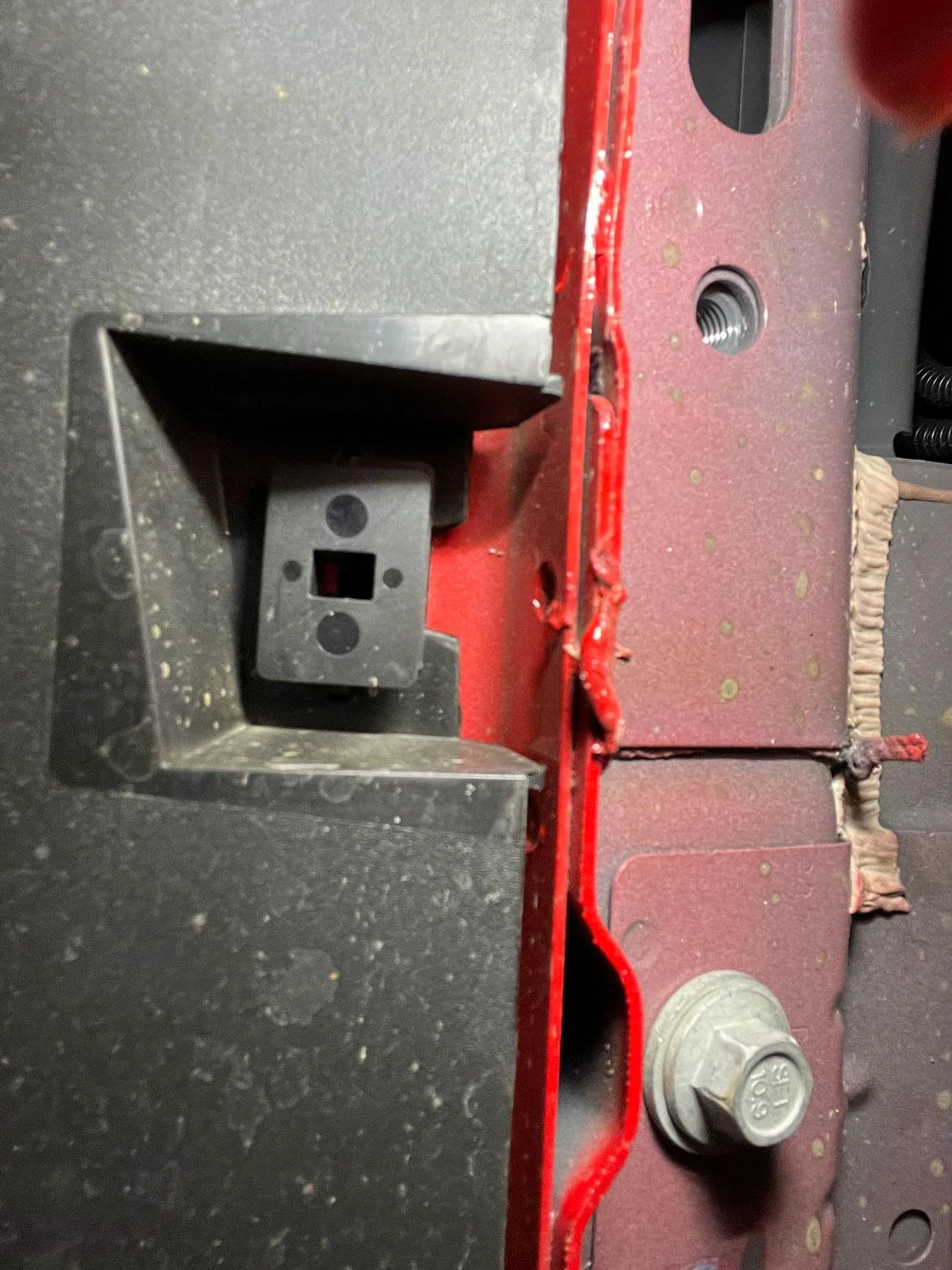

I was trying to find the jack points should I need to change a tire on my Dark Horse. I found the jack points by feel but I couldn't see the arrow until I took a picture of it. There are multiple points to hold the trim in place but only 4 jack points. The first picture is a trim point and the second is for both trim and a jack point.
Thanks for the pics. I am worried about breaking the plastic under there by the welds but feeling it the plastic seems to be recessed a tad so the jack hits the welds first.
The jack has a grove in the top plate that goes on both sides of the seam joining the two sections together. This prevents the jack from slipping side to side. Lifts may need a special plate or attachment to apply pressure in the same way when using those points.
