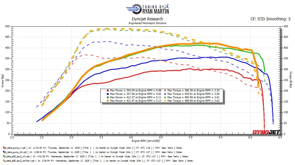

S650 Mustang Is it worth it to tune an ecoboost 2024 performance pack? 1778597649026-mt
Our test car features:
Stock Tune Results: 304 whp / 368 wtq
93 Octane Tune – Tuned by Ryan
  • Output: 357 whp / 430 wtq
  • Gains: +53 hp / +62 wtq over stock
  • Boost: 23–24 psi (held to redline)
  • Stock boost: ~21–22 psi tapering to 18 psi up top
Ignition timing is conservative at just 3° peak — safe and street-ready. For the S550 to achieve similar power, a turbo upgrade was typically required.
Full E85 Tune – Tuned by Ryan
The S650 EcoBoost runs full E85 on the factory fuel system — no upgrades needed.
  • Boost: 26 psi
  • Output: 412 whp / 485 wtq
  • With factory air filter removed: 421 whp / 489 wtq
The DI system maintains 5,000 PSI across the pull, showing just how capable this new fuel system really is. On the S550, you’d need a full fueling overhaul to achieve similar results.
We’re currently torque-limiting this setup during testing — so there’s even more room to grow.
