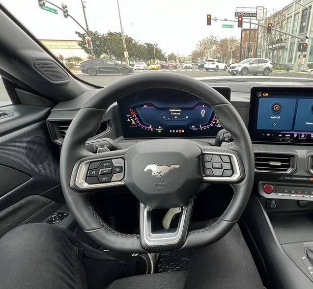

Just curious, Where does your steering wheel set when the car is going straight?
Here's a pic [ Not mine ] but mine was biased to the left by at least that much from the factory and I did get hands off alerts,
After installing cradle lockouts and getting an alignment my wheel is fairly straight and depending on road crown, biased to the right..
I'm not getting any alerts unless I intentionally trigger one by bouncing off the lane markings a few times.

My wheel sits dead center. My inner paranoia suggests to me that this got worse after -1 upgrade ago. Most recent didn’t do anything noticeable. I drive the same straight stretch at least 3x per week and have not been getting the audio interrupt or hands on wheel alert and I’m not changing how I drive it.
