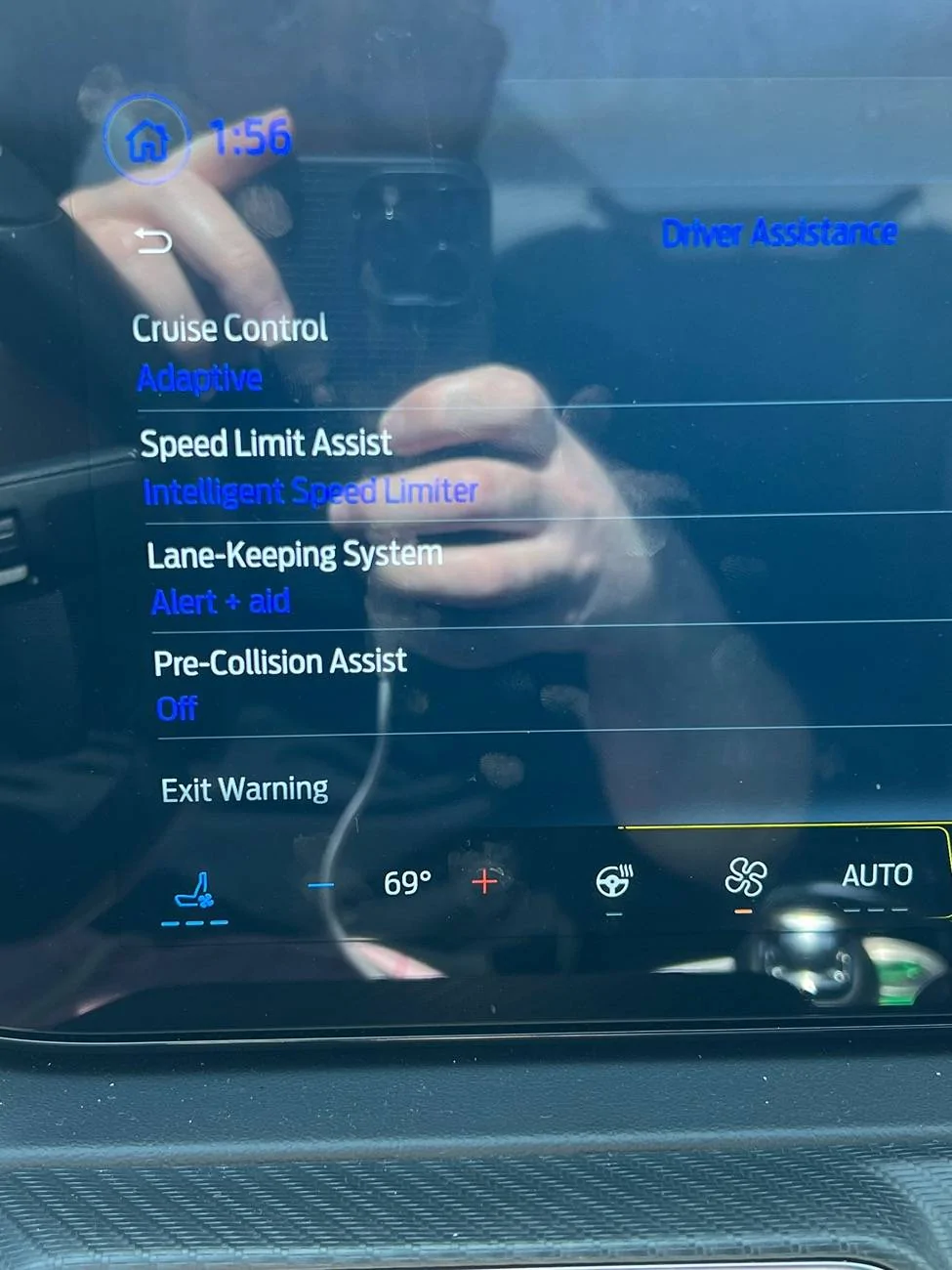

How to keep pre collision off, I am about to get rid of this gt because of how annoying it is. I turn it off and when I start Car back on it’s on. Please help it is ruining this car because of how harsh this breaking it is when I get close to a car, worst setting ever
S650 Mustang How to TURN THIS OFF IMG_1729

After looking at your posted photo; I respectfully suggest you turn all that Nanny BS off.
That's what I did before driving my GT off the dealer's lot and the pre collision thing has never reactivated.
You might wish to consult with your dealer as well; good luck!

Take it to the dealer. Something isn’t working as intended. I agree with Wiley Marmot, turn everything on the screen off. The “assistance” is overwhelming for the first couple of months.

I have everything turned off in my EV base model. Never an issue. Never comes back on. Something is definitely having an issue
