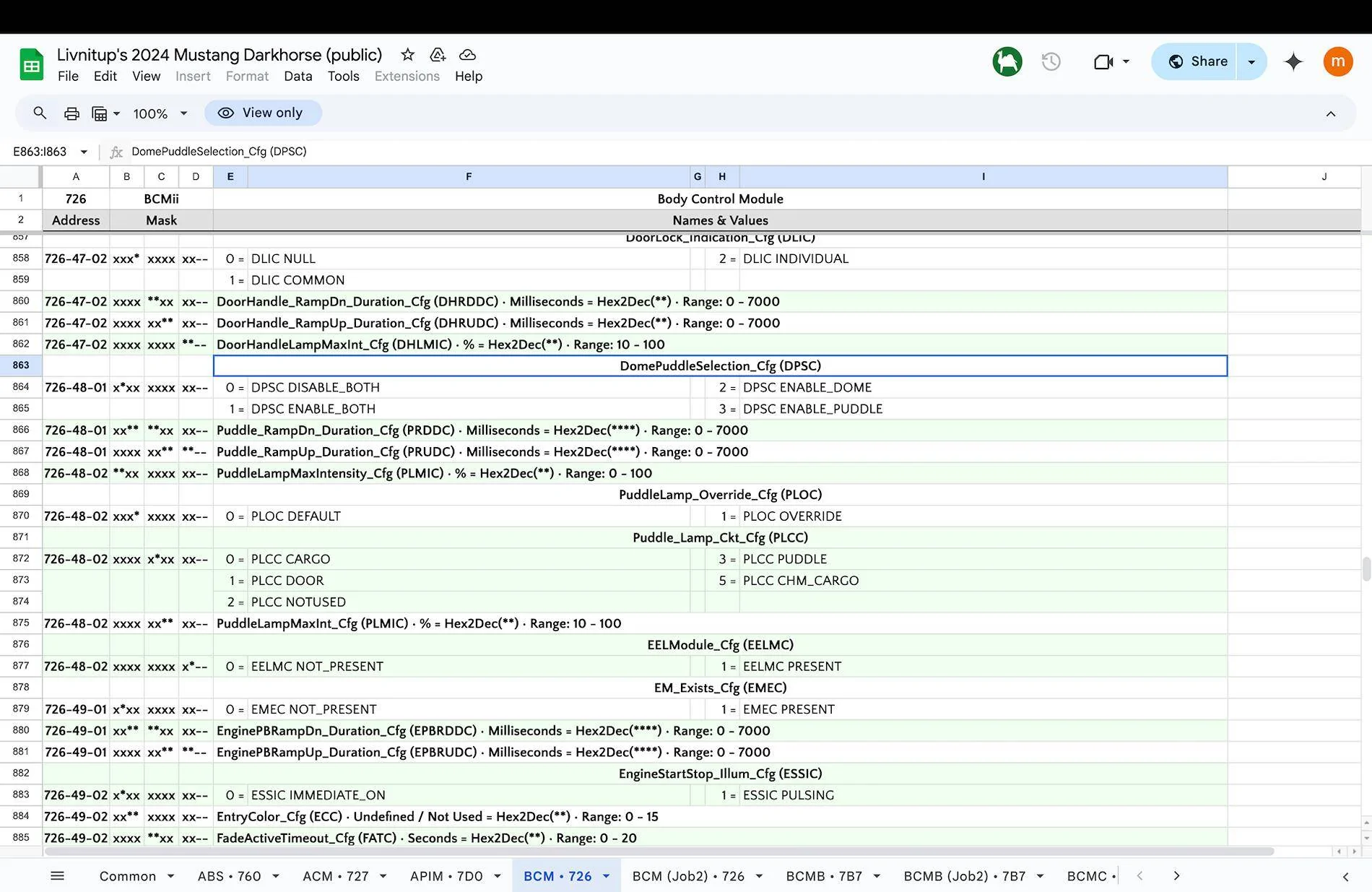

https://www.mustang7g.com/forums/th...ist-database-spreadsheet-by-livinitup.159997/
This is a link to the ForsCAN thread.
As part of the first post, there is a link to a public spreadsheet. I opened that, and did a search for "puddle". The results do reference settings to disable those. At least that looks promising.
I didn't study it much more than that.
There was a UK Member asking the same question of the Welcome lighting, in another thread; the question was left unanswered.
https://www.mustang7g.com/forums/th...rscan-speed-warning-and-puddle-lights.164648/
Good Luck.

Thanks for your effort.
Puddle lights are not my concern (although I wish they'd just behave like on Gen6 when the door is opened).
Found another thing in the Forscan-list: Approach_Lighting. Maybe that includes the general animation of the welcome light, I might give it a try.
