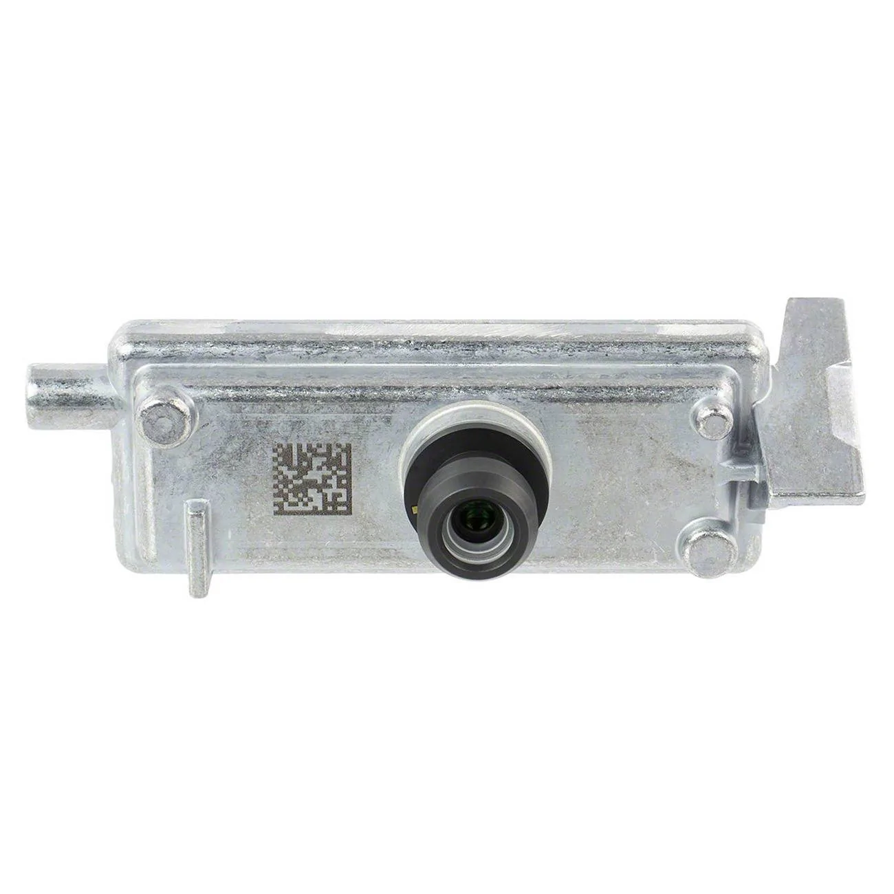

here is the IPMA camera.
S650 Mustang Is this the interior motion sensor? 1748371700770-sy

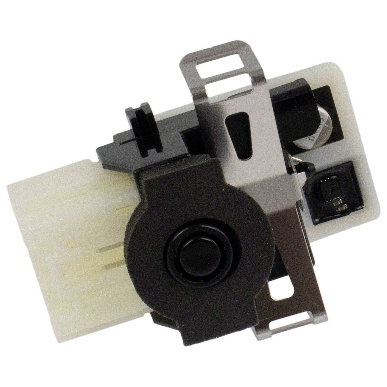

here is the interior ambient air temperature sensor. according to Ford:
"The in-vehicle temperature and humidity sensor is an input to the HVAC control module. The in-vehicle temperature and humidity sensor contains a thermistor and a sensing element which separately measures the in-vehicle air temperature and the humidity."
S650 Mustang Is this the interior motion sensor? 1748371785224-3h

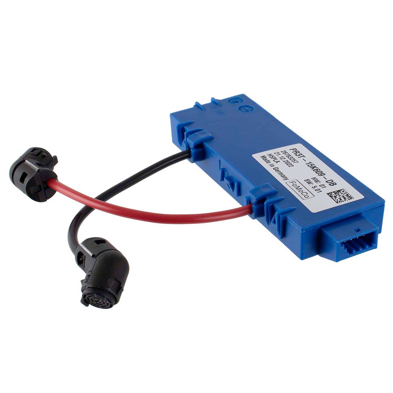

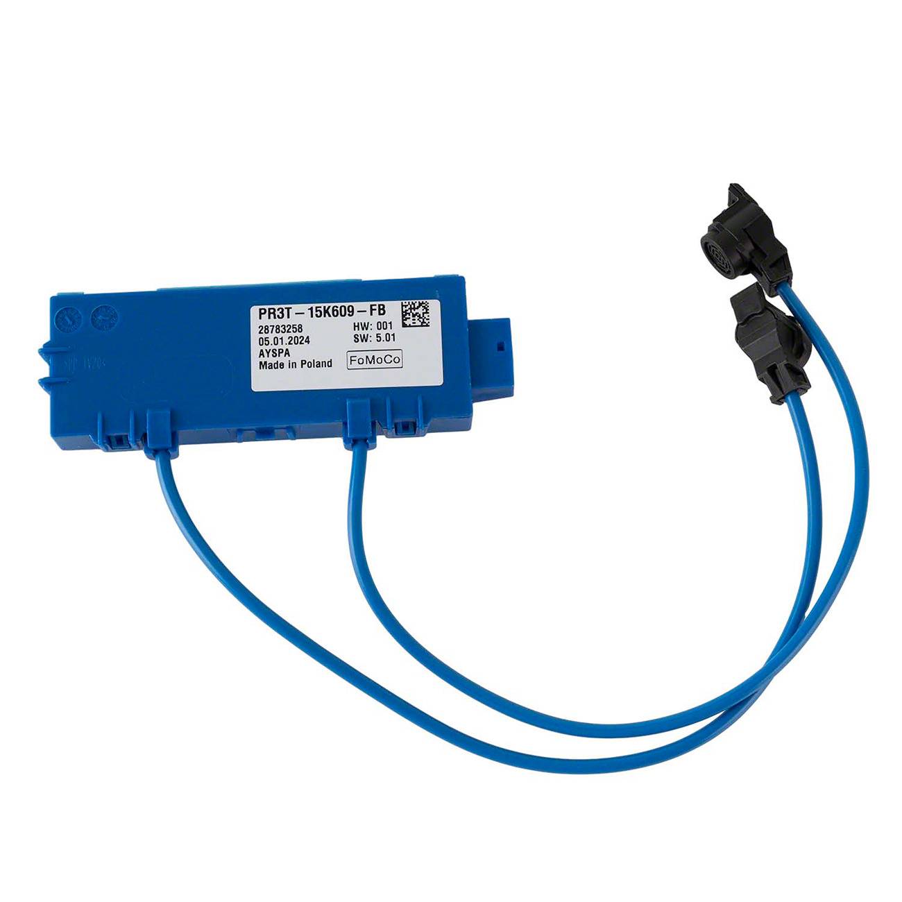

and here is the intrusion sensor for coupe and the one for convertible.
S650 Mustang Is this the interior motion sensor? 1748372529656-am
S650 Mustang Is this the interior motion sensor? 1748372552930-52
