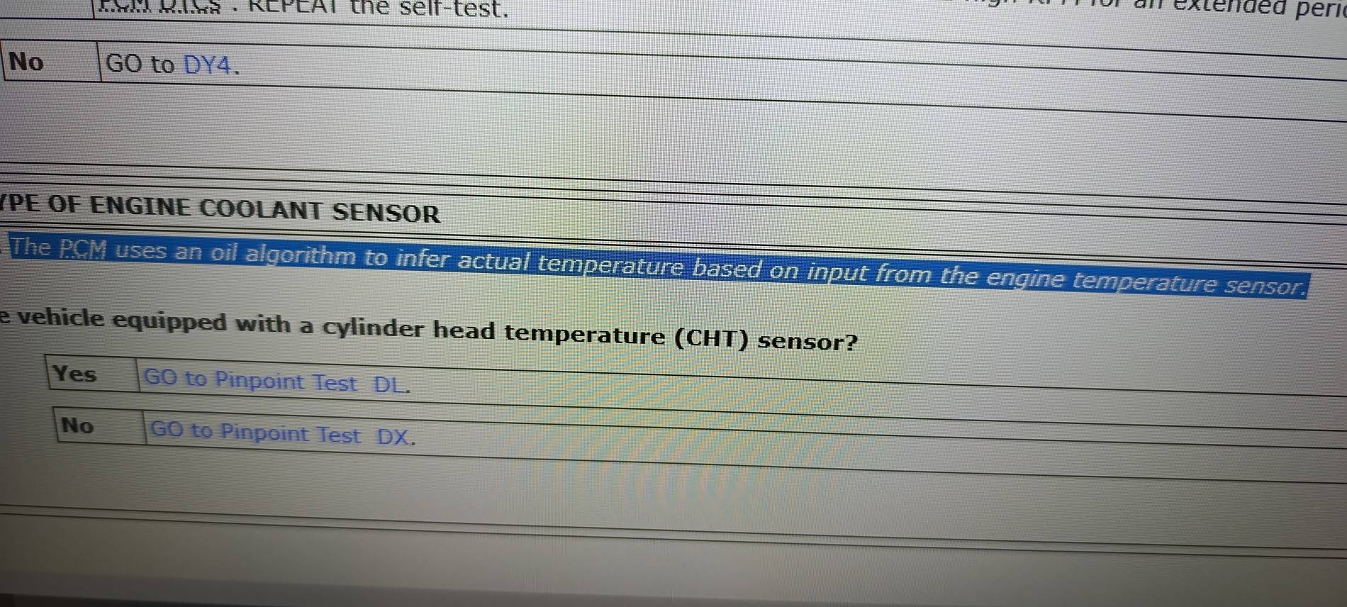

It's an oil algorthm based on input from the engine temperature sensor. I did the check with my own car i meassered the temperature with a heat camera and checked what i had on the dash and i can garantee it's accurate
Yes.
I was just about to post after scanning the Shop Manual. It seems in the VCT section they make mention of the algorithm but not much info. Also in the component and wiring connector sections there is also no mention of a sensor. Nice post! thanks!

Great info. I can confirm after installing a thermalcoupler with the oil cooler, the temps are 25-30 degrees cooler than what is displayed on the dash. I installed the OEM PP oil cooler, radiator, and front brake ducts back in December and have monitored the temps closely since the install. Really want to get the issued resolved as I enjoy track days in Daytona and Sebring. The question now is how do you change the algorithm to reflect the addition of the OEM oil cooler on non-PP cars? Is there something in FORScan data or is it a PCM flash update? If it's a flash update, my guess is Ford will not be very cooperative.
I have my car since june2024 and i have a diagnostic shop here in my town. And we work 99% with Oem software. Just for the reason there is so much more involved then adjust some parameter with forscan. The first thing you need to do is check on ptts with your vin how manny updates you are behind. Car is build in januari 2024 and untill now i had 7 updates including pcm/tcm abs etc. Everybody believe even pcm updates Come over the air and that's where they are wrong. In my case there where 3 OTA updates. None of them did pcm. I needed Fdrs for this one. Your first step is ptts!
