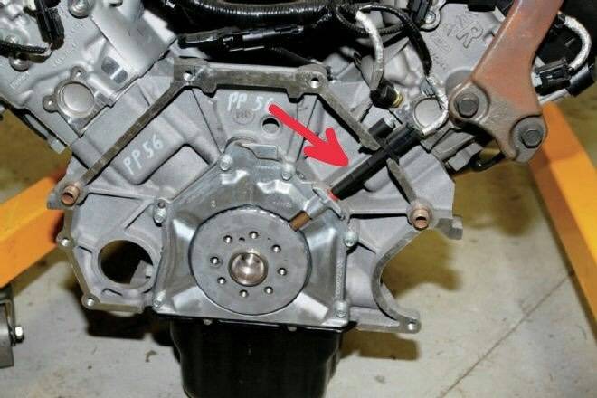

Is rpm inferred as well?
No. There is at least one sensor directly supporting RPM measurement: the Crank Position Sensor. The attached photo highlights its location.
S650 Mustang S650 is there no actual oil temp sensor? crank sensor
4,857
2,680
No, there is at least one sensor directly supporting RPM measurement: the Crank Position Sensor. The attached photo highlights its location.
