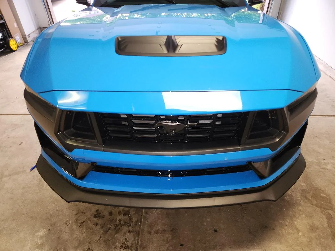

With a coupon code for $230 shipped, I decided to take a chance.

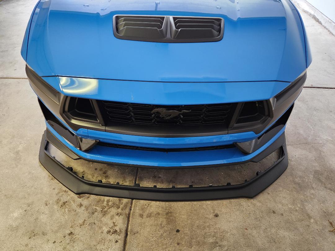

I was initially very impressed by the front splitter itself. It's all 1 piece and the fit was great. Looks very nice. However, the under extension piece was an absolute BEAR to get in. It took an extra set of hands and 4 plastic trim tools to help wedge it in. It took a very long time and the holes simply didn't ever line up well, but I did get all the bolts back in except for one.

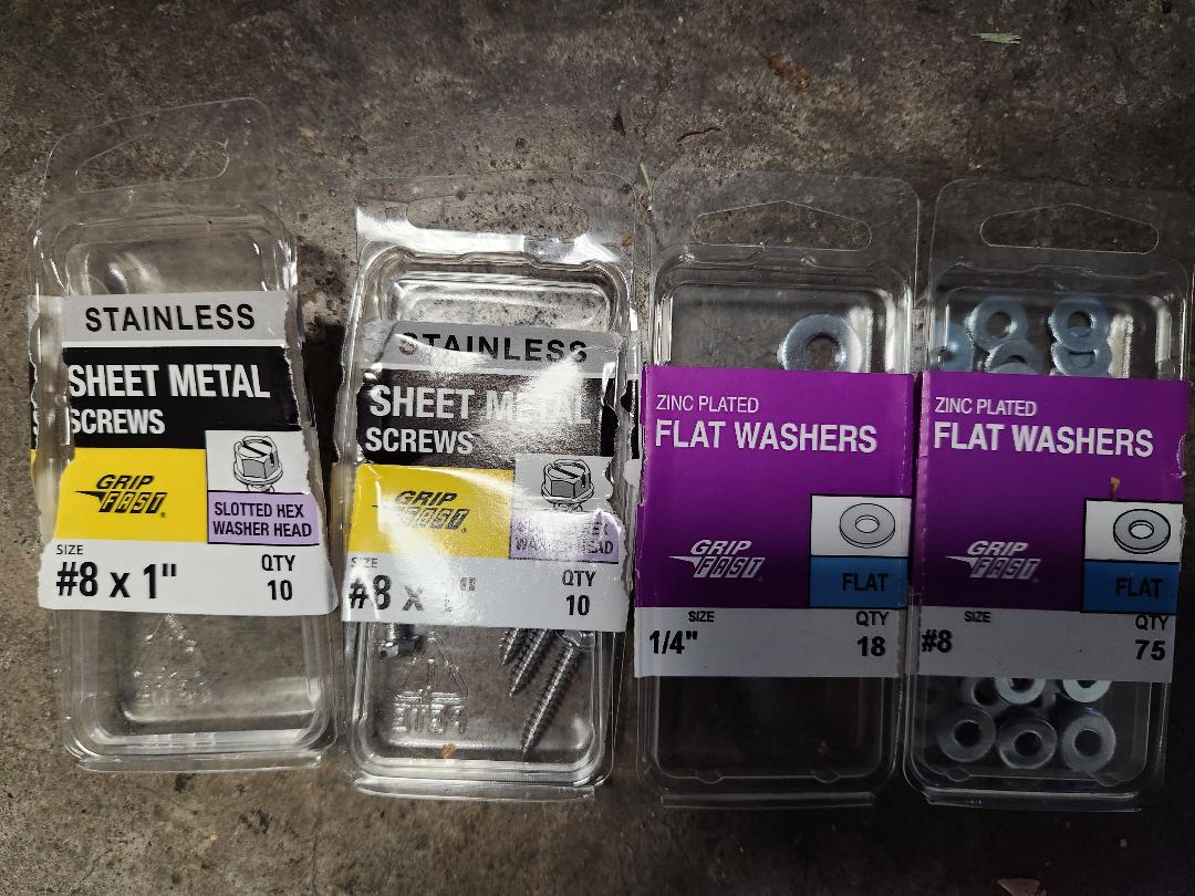

Speaking of bolts, you will need an extra ~16 of them and washers, which are not included from Ikon. I went to 3 auto parts stores and 2 hardware stores before improvising with what is in the photo from Menards. I don't know if you can get a set of stock bolts from Ford, but if you can, go for it. I just didn't know what I didn't know with this kit.
I also had to use a Dremel to cut off about 5 threads from the stock bolts that I used along the front edge of the under piece along the splitter itself. They are a little too long and will raise up the plastic in the splitter if you try to tighten them all the way. Be warned!
Overall, it looks really good and for the price, I'm satisfied.
